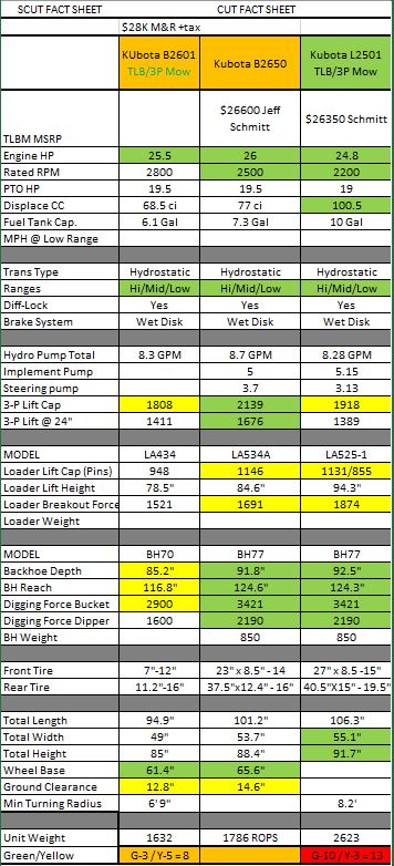

Been debating for some time now between a B2601 and a B2650. Currently have a BX23 that I use for mowing, loader and backhoe work, nothing else. But I'm finding I need more ground clearance, more of a traditional tractor stance (my BX gets muck absolutely packed all around the rear end every time I get into the mud, the wheels are too close to the machine), a slightly beefier tractor as I get into stuff that I'm starting to feel the BX just isn't really suited for, and a little more loader capacity would be nice too.
I mow one property that's maybe 1.5 acres of grass by myself, and help to mow another where we mow just under 5 acres of grass. The 5 acres of grass is my parents' yard...they mow way too much. But they're on a 100 acre old farm, so I use the FEL and backhoe a lot for draining wet areas, trail maintenance, putting in drains, and some landscaping occasionally. It's also come in handy a couple of times when dealing with some firewood that we didn't want to drag out of the woods; the BX was small enough that we didn't have to. They have a couple larger tractors for brush hogging the fields, plowing/discing the gardens, plowing snow, etc..
I need to keep this light enough for me to tow and I also want to use a mid-mount mower, which keeps me from looking at the L series. There are a couple of other properties I may on very rare occasion have use for the loader and backhoe.
Originally I was pretty well set on the B2601. I don't need anything too big, and in fact for working around the woods the smaller size might be an advantage to some degree. But, now I'm leaning toward the B2650 some; a little more loader capacity would be nice. I plan to get a set of forks. And larger wheels I expect should provide a smoother ride on rough terrain, and better traction in the mud. And I'm used to ground contact mower decks.
Am I missing any advantage to going with a B2601 over the B2650?

PA452,
They are similar but different in every way.
The 01 is a standard model while the 50 series is a premium.
Premium means suspension seat, ratchet tilt adjust, telescopic sway bars, rubber floor mat standard, dual arm rests and cruise control. There may be a couple more features.
I am attaching a spread sheet that you can look at both units side by side and see that in the B2650 you get flat pout more of everything. Not a whole lot more, but everything is a little more. The caveat is that it is a little taller, wider and bare unit is around 150 lbs heavier.
Both are Kubota, so bother are fine quality machines. Good luck choosing!

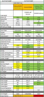

Ooops! Forgot the spread sheet!

ROCKCRAWLER: Illustrative spreadsheet. Thank you for posting.
Neal Messick should review your spreadsheet before concocting his next 'B' Series video.

I have not seen the engineering numbers on it, but I would bet you a case of Corona that the B2650 is actually less ground pressure than the 2601 due to only 150-ish lbs heavier yet much larger diameter and width tire. So don't consider that little weight difference in to your decision tree.
The loader reach out, down, lift power and break out power are all noticeably greater.
I see the advantage to the 2601 being that it can fit into a shorter garage being 3.4" shorter. Go measure your garage door open height.
If you notice the green shading in the spreadsheet, you'll note that the 2650 beats the 2601 in every metric aside from PTO HP.
Cubic inches, power, loader lift height, 3 point power, ground clearance, fuel capacity, lower rated RPM.... There is nothing that a B2601 can do that a B2650 can not do better aside from fit into a smaller height garage. And it's really just a few dollars separating them... in grand scheme of things, $1000 here or there for a potential lifetime purchase should really be a "no never mind".
The L2501 would have went in my garage if it would fit, but the B2650 fits with about a finger width gap! I measured before I bought, it was a big part of weeding out brands and models. I wanted the most tractor that would fit in my garage.
But if that B2601 feels good to your butt-O-meter..... make it your baby!
