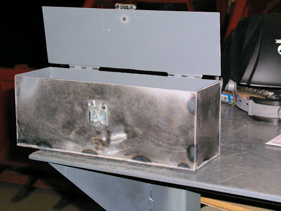

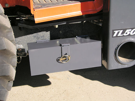

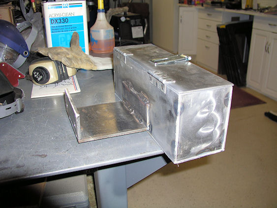

I was picking up some stuff at local dealer and noticed a B26 on the lot with a toolbox under the passenger floorboard. Took some measurements and decided to build one. Couple things to watch: make sure the mounting bracket didn't interfere with the 3ph arm mount and the floor of the toolbox is above the frame bottom. Some scrap steel plate and $5 in hardware later here it is. Used Kubota grey paint (good stuff).
Useful for stowing the 3ph pins, oil filter wrench, crescent, tire gauge, etc etc...

Very nice! I like the way its mounted out of the way and looks liek it belongs there. I see you have a tublar pipe part of your fel ? If so why not use that for more toolspace with a capped pipe ?
