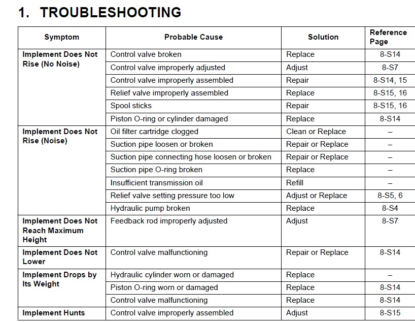

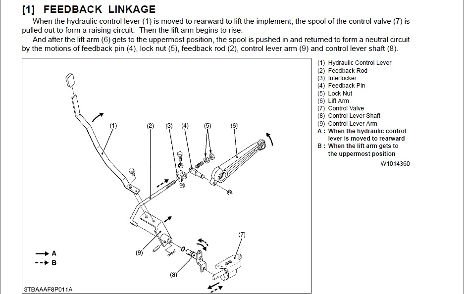

I cannot be certain this image is of your exact tractor.
From looking at the photos you included I do not see one of the 3 pt feedback system so I wonder if you are not considering it.
I further assume your mmm relies on a rod(s) link to the 3 pt lift arms.
Make certain the feedback system is able to operate properly.
I would also suggest you disconnect the lift rods from the 3 pt hitch. You want to make the lower 3 pt arms free floating so they can pivot about their inner end manually.
Place a wood 4 x 4 under the lift arms and slowly try jacking the lift arms up.
If the problem lies with the mmm mechanism it should become apparent during the jacking.
Your goal is to identify where the difficulty arises.

The feedback lever binds up. It is 100% tied to this mechanism
/ B2320 3 point binding #11
This is not meant to be anything but helpful so please do not take my next comments wrong.
From a long way a way, it seems like you are focused on the symptoms, but not the cause.
An alternative to my suggestion of manually jacking up the lower arms, disconnect the lift links which ties the upper and lower lift arms together.
If in this condition, the feedback system operates properly, then the problem lies with the MMM.
You can remove the feedback rod and operate the 3 pt system, doing manually what the rod does automatically,.... relieves the application of pressure at the top of the lift arm stroke.
Dave M7040

Ok I was able to get some free time again today. I removed the mmm and the binding continues at full up and full down.
Difference is at full down I can force the lever and it will still raise everything but it has a bind very similar to full up. I will take off all the moving parts one by one until there is nothing that I can rule out.
Thanks for the help and any suggestions keep them coming. No matter how obvious you may think it could be I wont be offended.
