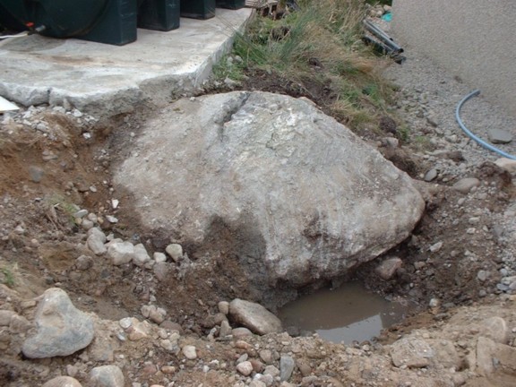

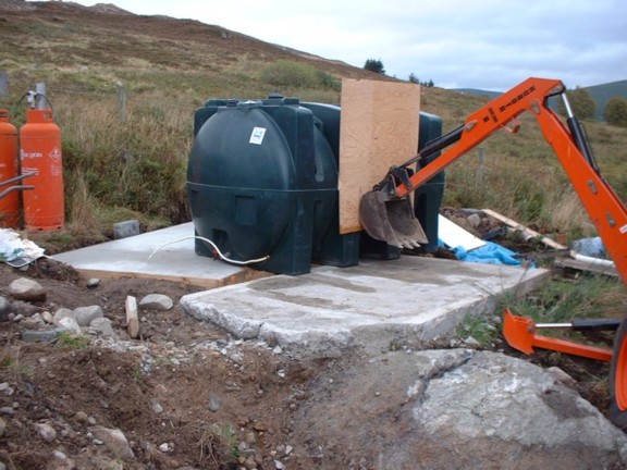

There we are. One big hole at the side of the rock which seems to just get bigger.

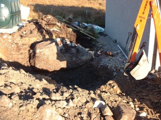

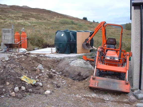

Well after lots of digging and then trying my theory of pulling into the hole I admitted defeat. I measured the rock and it is 6 foot long 5 foot high and 4 foot wide. Oh yes it is granite by the way. Well I think I will have to call in reinforcements when the weather gets better.
Well that's me up-to-date on my adventures in the tractor seat. I will keep you posted when I arrange for someone with a rock breaker attachment on a large machine to come and get rid of the rock.
