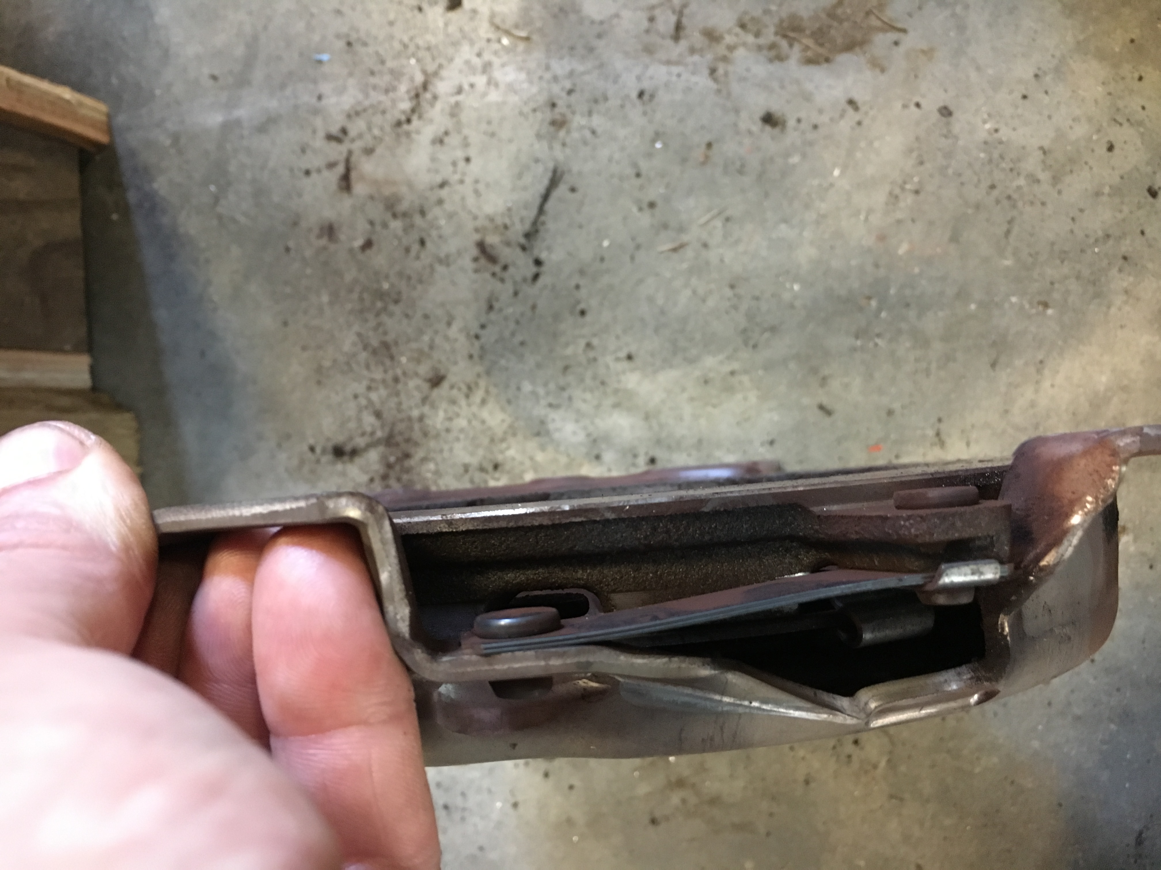

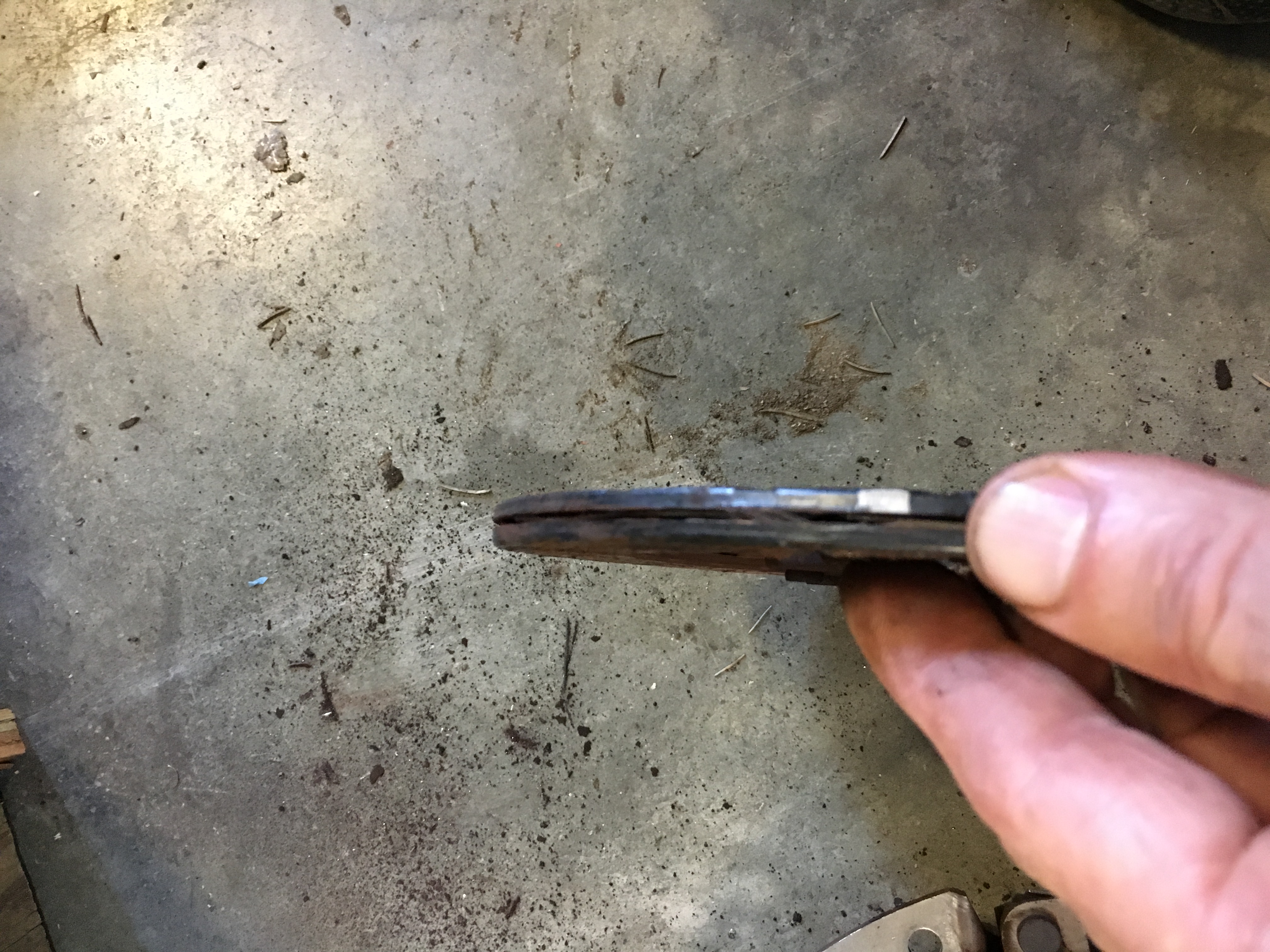

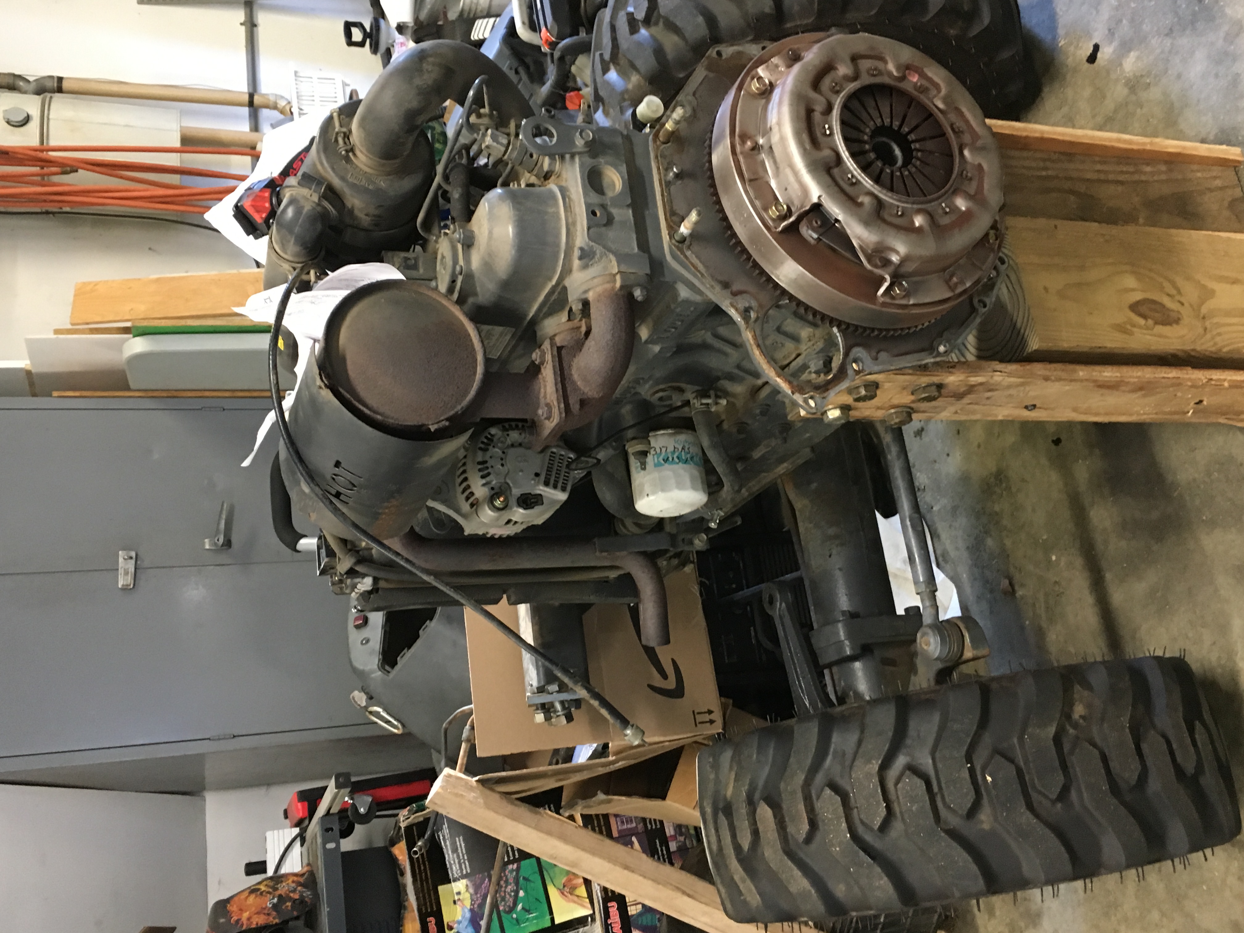

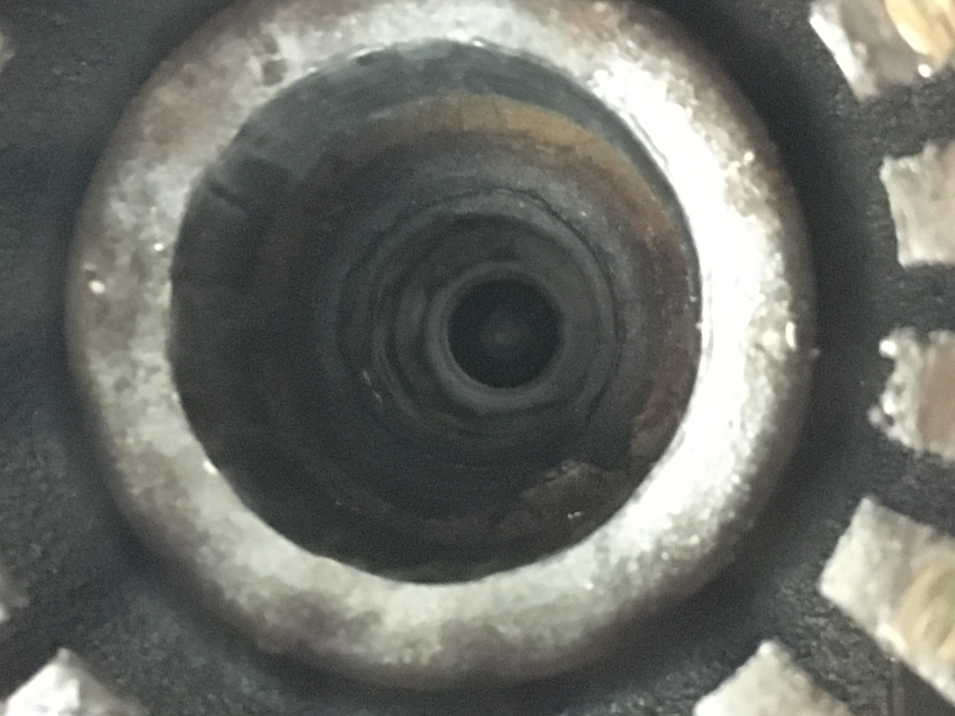

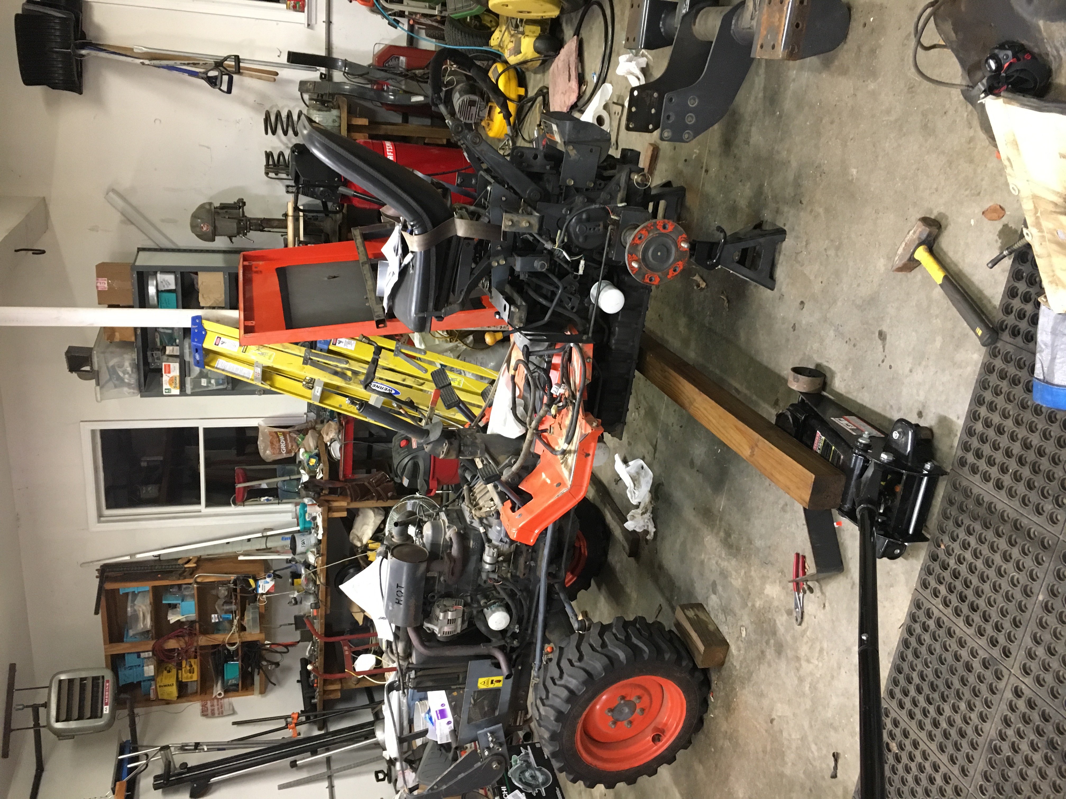

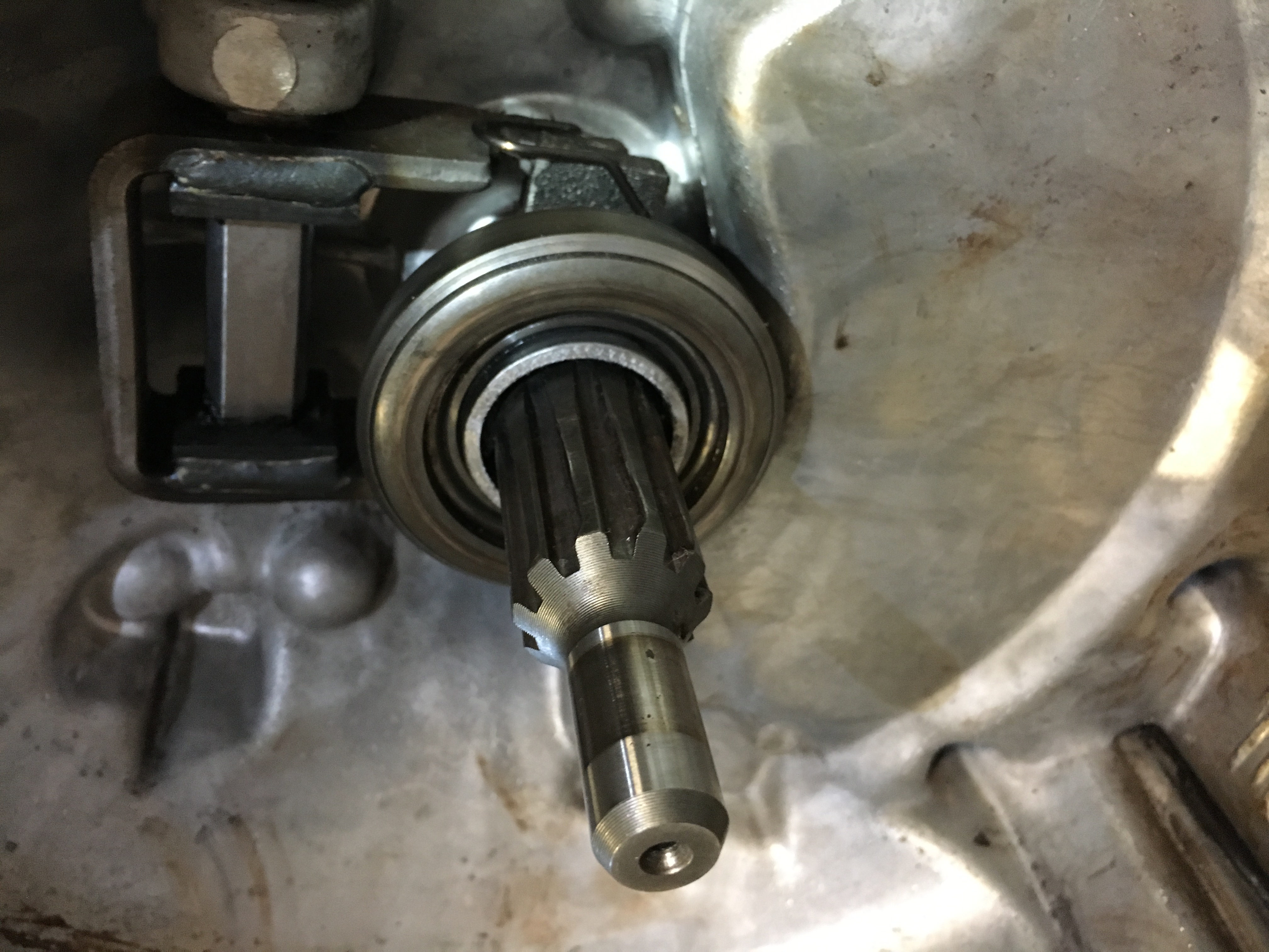

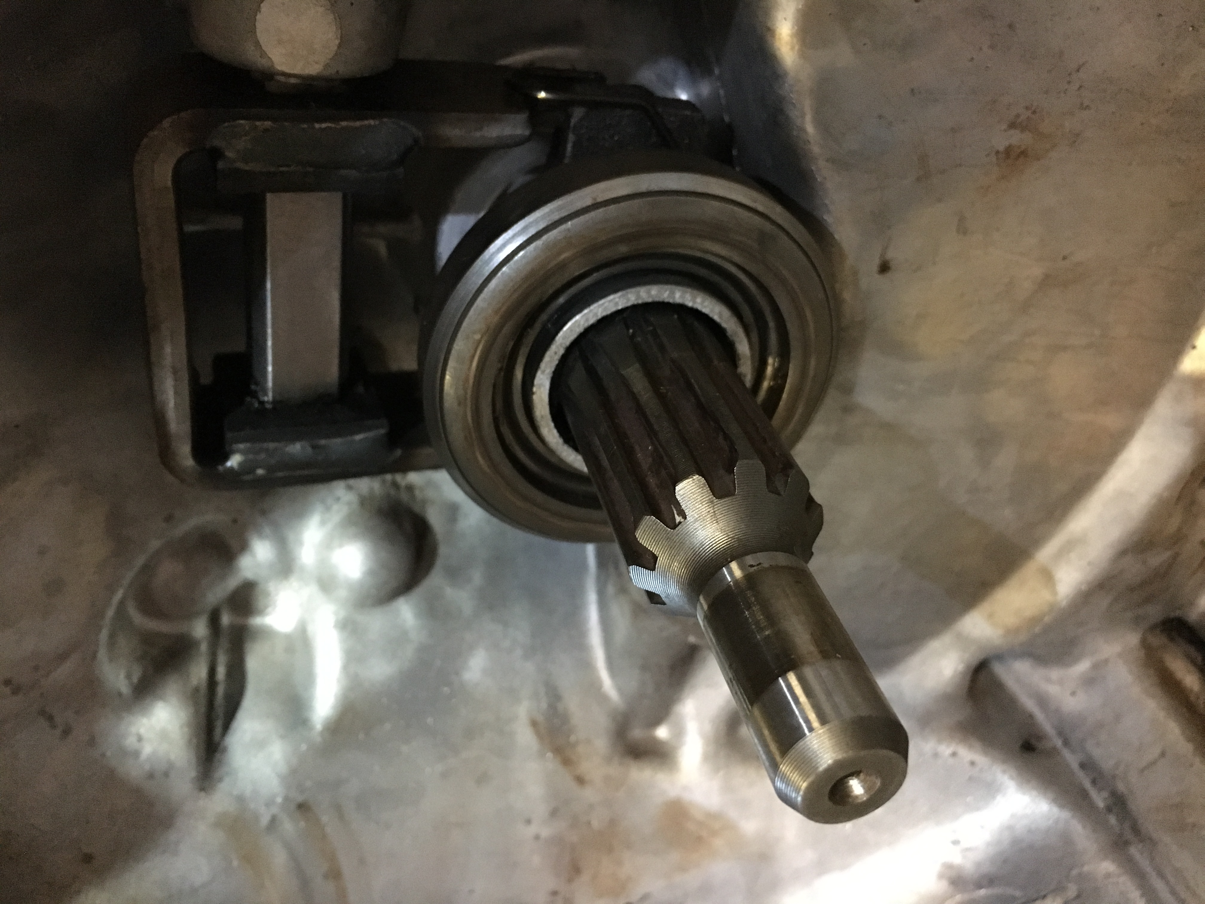

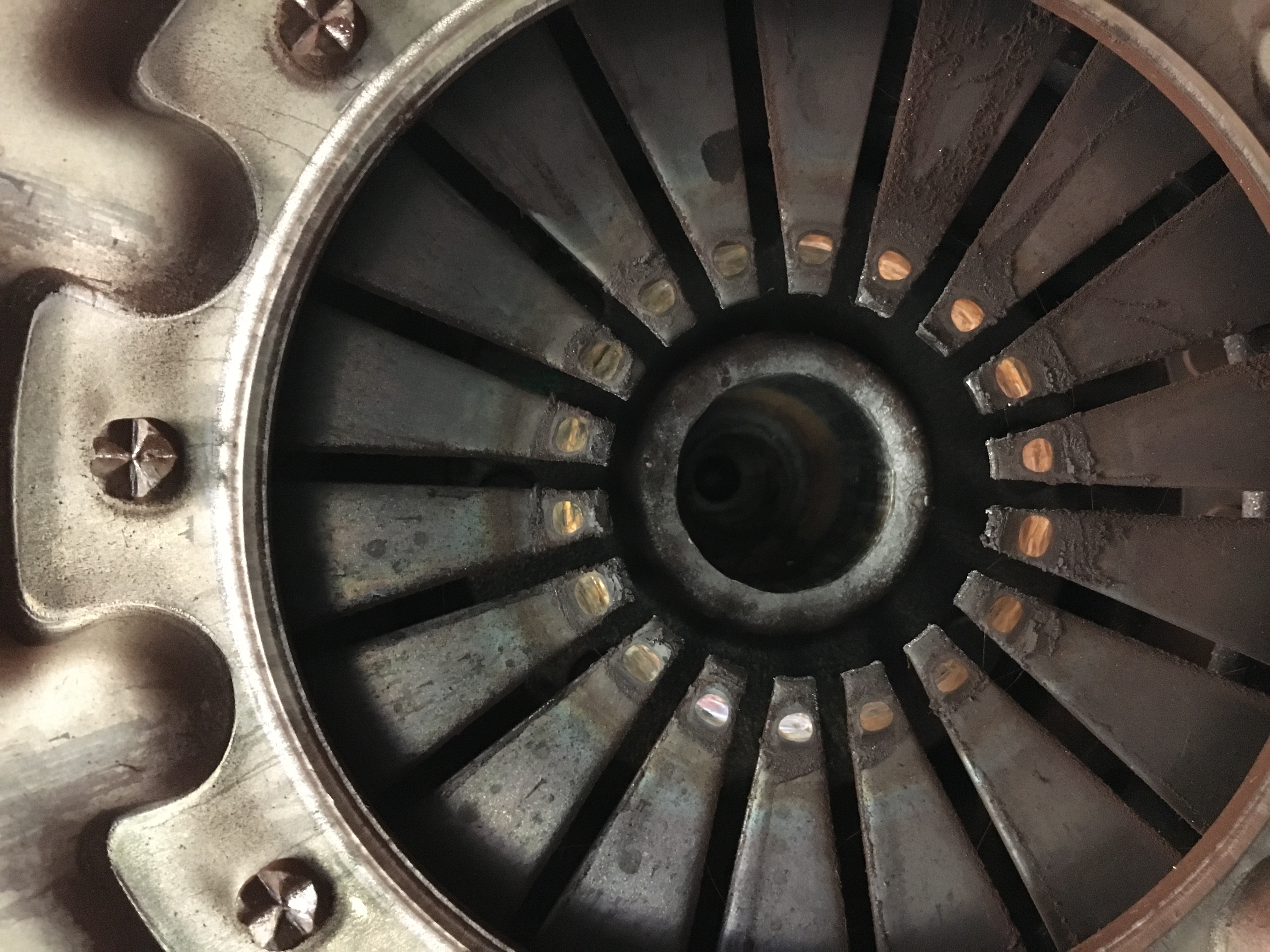

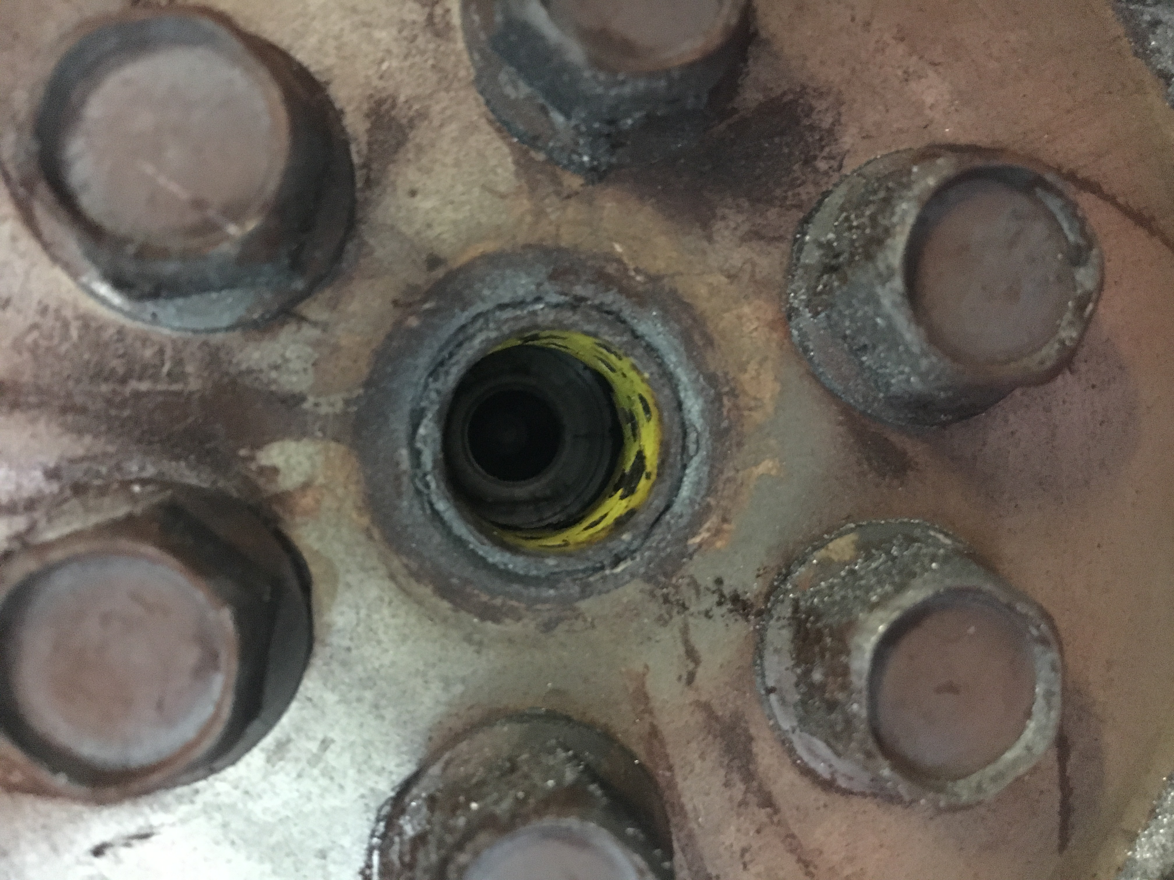

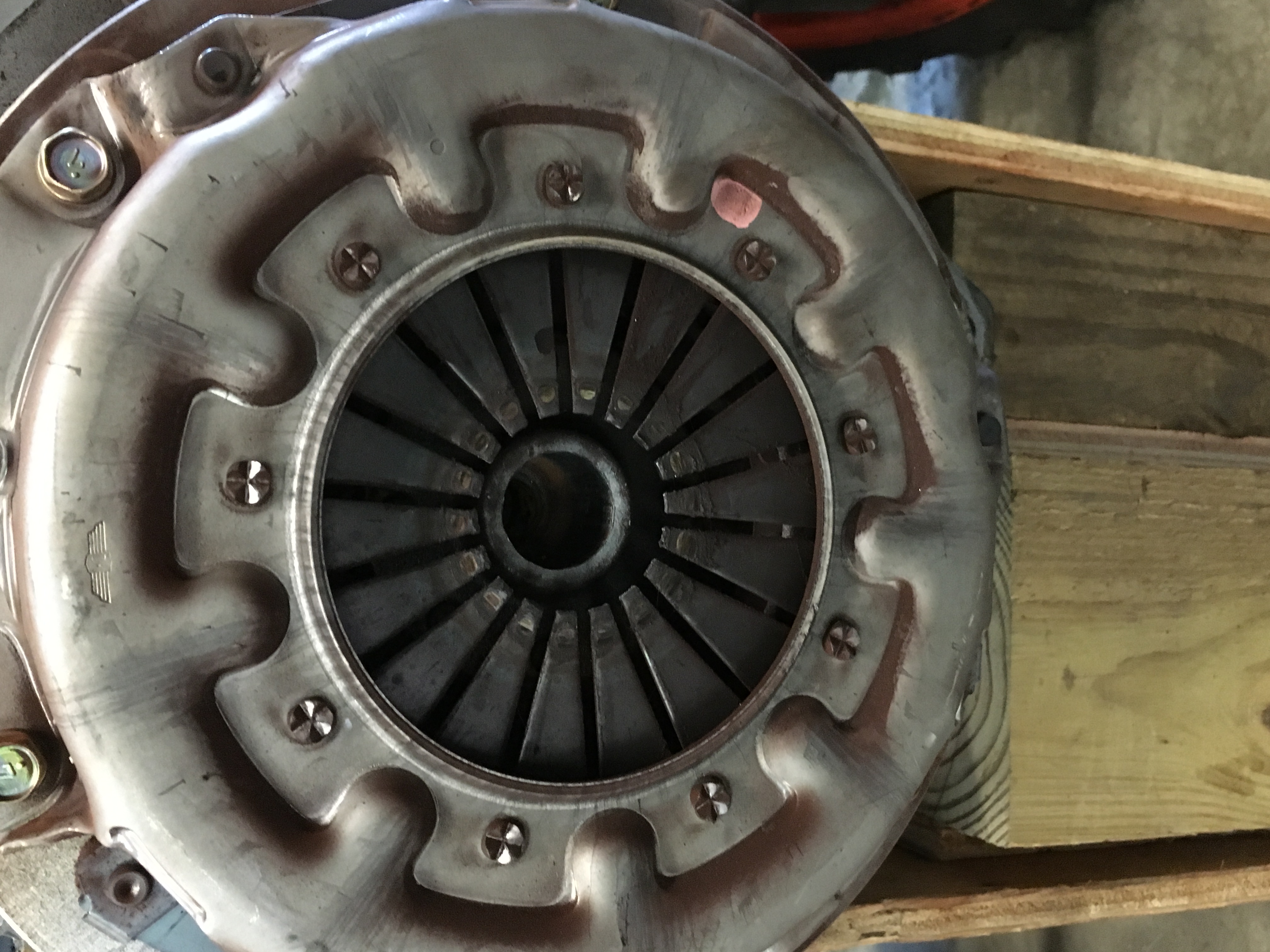

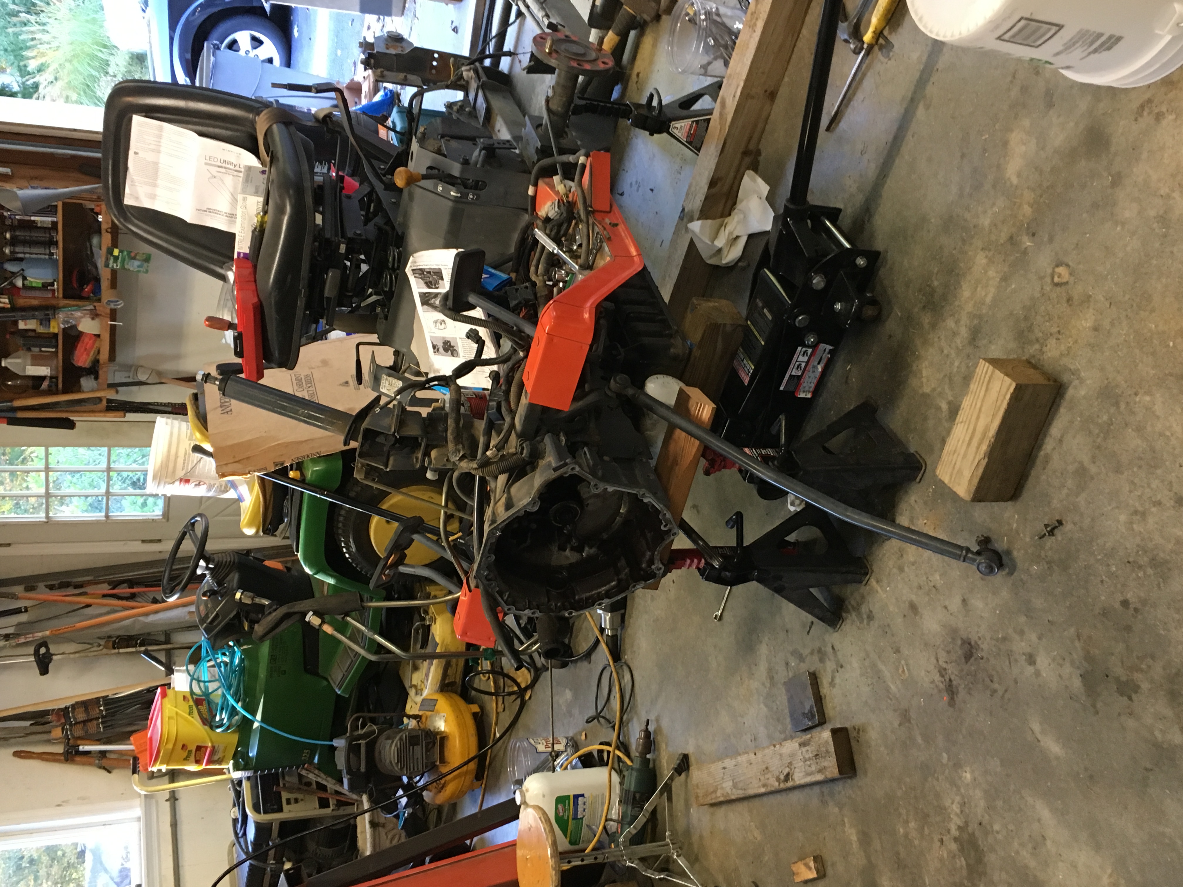

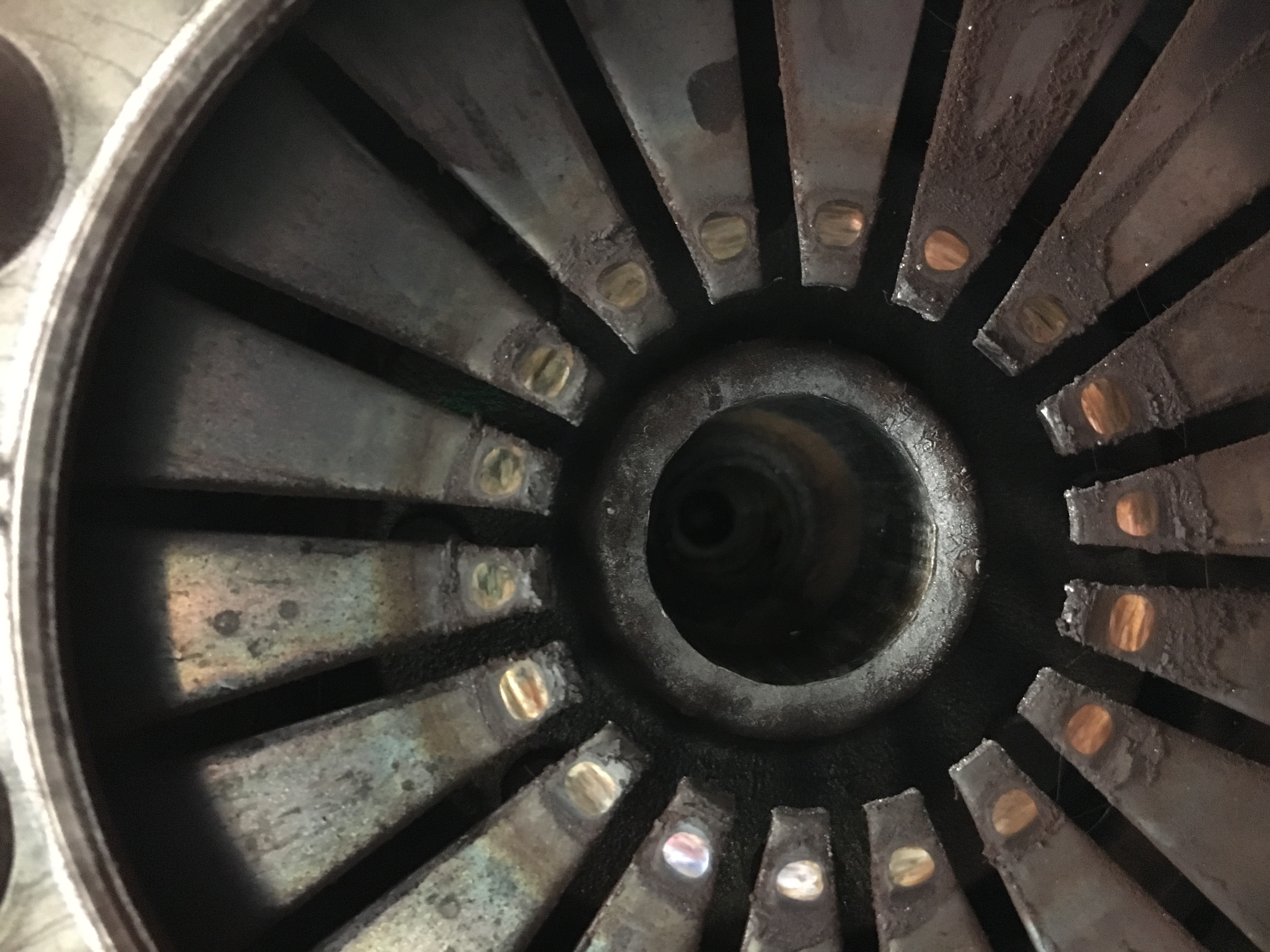

#58
47F29998-53DF-4947-8FA9-408AFC0AEFB2.jpeg6B8529CF-FFE9-42DE-95AF-C99D6F59F247.jpeg7CB3A5EB-277F-4238-BDF1-DF17A7C58176.jpeg36D9EE48-593D-4281-B03E-0867E1E91927.jpeg722DAB10-B2A1-42AA-8613-E1ADB83D07FC.jpegA01BF805-5780-4782-BAB5-A8C4966BABC0.jpeg
What should I look at and test to see if anything else was damaged and needs replacing?
/ B21 Clutch Problem? #59
Standard clutch 'job' parts (Clutch plate, Pressure plate, Release bearing, Pilot bearing) and the splines on the trans input shaft look pretty beaten up - so you better think about replacing/repairing that. Maybe look at the input shaft bearing as well...
How's the flywheel facing?
Well done getting this far.
/ B21 Clutch Problem? #60
Can't quite see but looks like pilot bearing is toast? I'm wondering if it's the chicken or the egg, does the clutch spline slowly wear and then start to run out of centre and flog the pilot bearing, or does the pilot fail allowing the opposite to happen.
Given that this is a HST machine and the clutch is used rarely, meaning it's generally always engaged, I'd take a guess at the centre splines start to wear, and then each time the clutch is engaged it clamps a tiny bit out of centre causing out of balance and more wear and ultimate failure. I wonder if I can get a borescope in through the inspection hole and around the back of the pressure plate in front of the throwout to get a look. Somehow I doubt it?
Looks like the throwout bearing carrier has touched the pressure plate fingers, should be able to take the burrs off the end and reuse.
