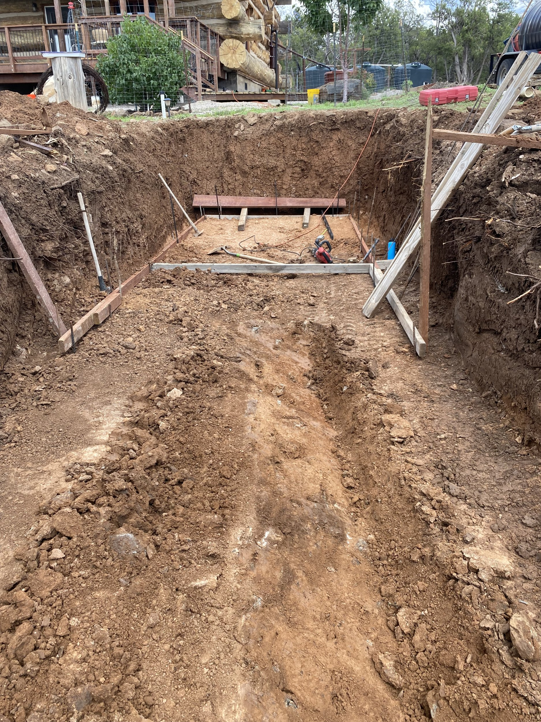

So two of my block walls on my underground greenhouse are going to be 6 ft tall and 19 ft long. When they are finished and cured, I will backfill. I’m planning on inserting rebar and filling some of the holes in the block around the center of my walls at least.
Question;
Should I put a small block wall perpendicular to the long walls at the midpoint for support?
   / AZ ranch #1,359
Is the soil expansive like the Texas Clay? If so, then I'd say for sure, but other than that, it is hard to tell for sure. If you do it right, you can do the same sort of thing on the outside to brace it, but getting it tied in properly so it works will be the key. (Not a soils engineer but did stay at a Holiday Inn Express once...)
   / AZ ranch #1,360
Something happens when retaining walls are more then 4ft tall. The amount of pressure on them increases to a point of needing some engineering. Less then 4ft, and it's all easy pleasy.
The two biggest issues are water and water freezing. If you can drain the water away from the side of the bock, you will eliminate all of your potential issues. Adding a deadman, or anchor, or some sort of reinforcing structure to the wall will help, but there is a limit to what it will do when fighting water, and water that freezes.
How much rain do you get in the worse case scenario?
Does it freeze there when the ground is saturated?
