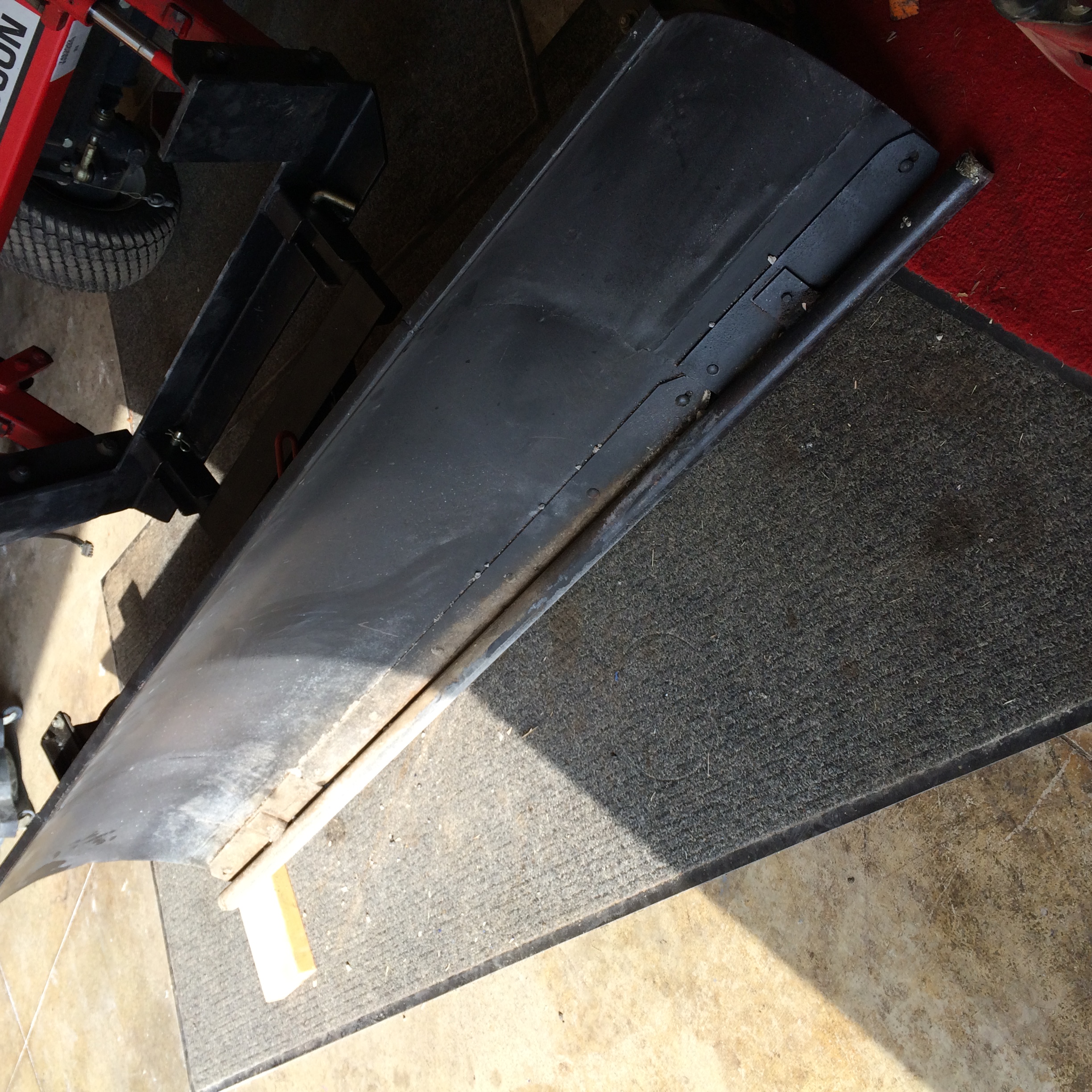

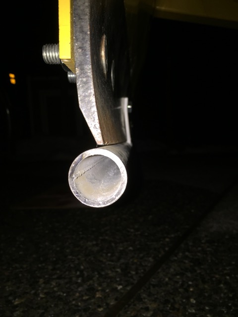

Here's how I set mine up. You can weld the ears on any position you like. I tried to minimize any front overhang.

/ Avoiding removing gravel while plowing snow. #10
One issue I see with this is the when the pipe is on the front of the cutting edge, it would have a tendency of holding snow on the blade, perhaps if it was bolted behind the cutting edge would be better.
You could certainly do that. Or, mount it in the center below the blade.
My thought was, ice and any obstructions would not be able to bend it away in the front.
It's been the way it is in picture, for 5 years. And, it works great. Including when I back drag the plow.

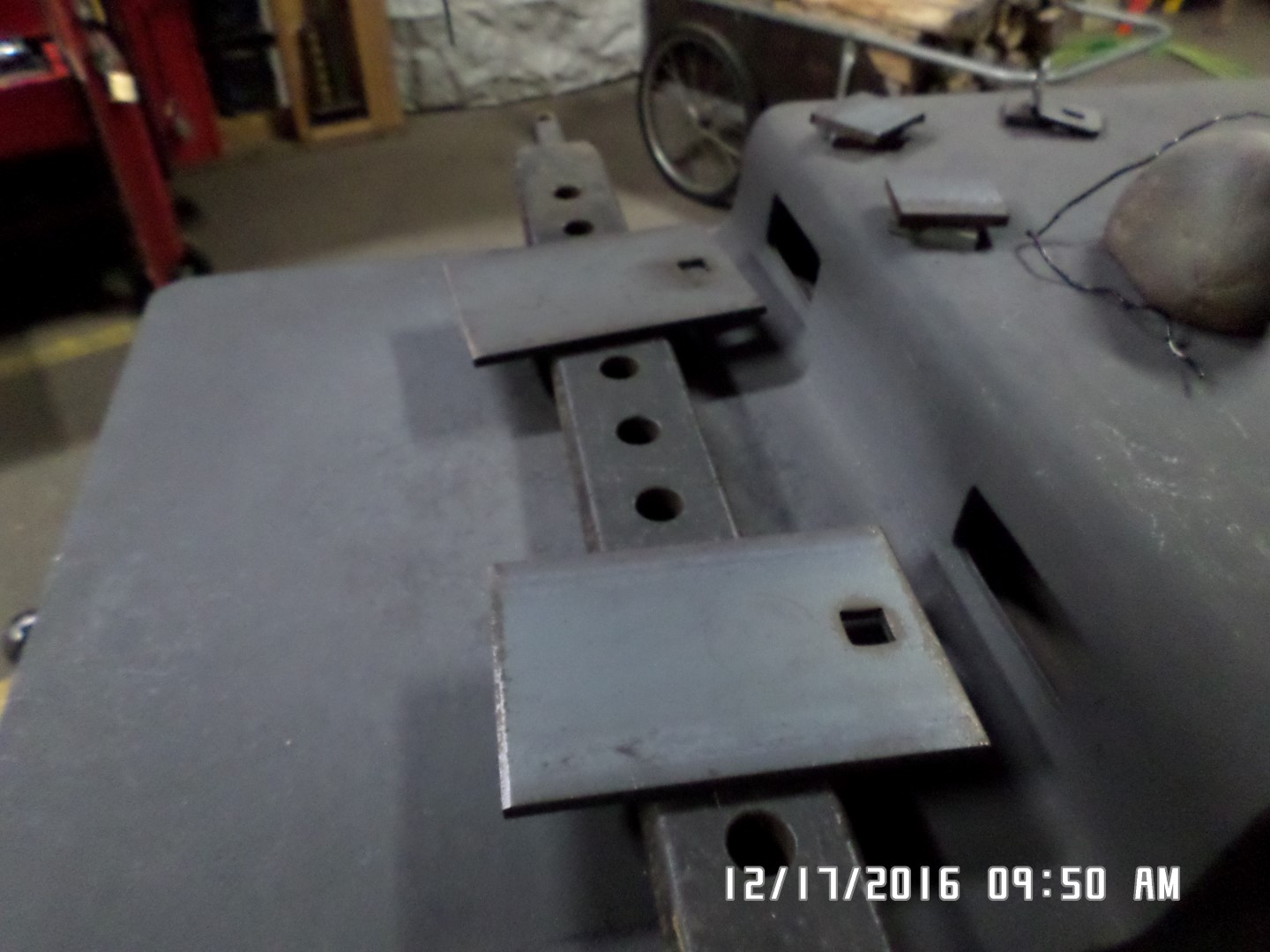

It's common practice up here to add pipes to plow blades in the winter. Also can be used for pushing leaves on trails in the fall. Local machine/steel/welding shops sell 8.5 foot pieces and tabs for $90. The slot is cut into them with a plasma cutter, and they make up a bunch of them each summer to install that winter. The usually use schedule 80 1/4" wall 2" pipe. A pipe should last a homeowner for just about forever, not so a contractor.... Here is a picture of a left over piece I have laying around and the tabs they gave me from just doing my 78" front blowers [ I made my own tabs ]...

Any of your local metal fab/machining/welding shops can make one for you. Just need to figure out how wide a slot you need, you can cut 2" pvc pipe using a rip fence and the blade set just above the table surface ... CAREFULLY...!!!! Then take the dimensions to the shop and have them put a slot in some 2" heavy wall schedule 80 steel pipe. You can have them make the tabs, or do it yourself.. Most of those places will install it for you. Shipping on something like that would have to go via freight... $$$$$$.
