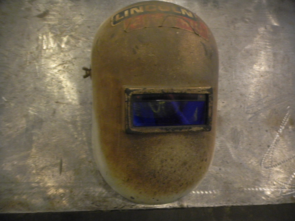

Do you guys with the auto-darkening masks miss the big lens?
My mask has a lens that is 4.5 x 5.25 inches and it seams that a 2x4 inch would be hard to get accustomed to?

I have a Miller hood and the window is a little smaller than that but it's the only hood I've ever owned so I guess I don't miss the larger window. However, in my first welding class I used an old non-auto hood and I hated having to flip the helmet when starting the arc.

i have an old jackson fiberglass helmet with a big lens.that has been my helmet for 30 years.i have made many welds in tight places by looking through the corners.i also use a jackson nexgen .i have a harbor freight for tack welding with the mig.the harbor freight only has one advantage over the nexgen,you do not have to turn it on.the nexgon is superior in every other way.i also have a helmet with a gold lens.i use all 4 helmets depending on what i am welding.they each have their advantages.if you wanted a auto helmet and could afford it i would recommend a nexgen.if i could only have one of my helmets it would be the old big window jackson.
