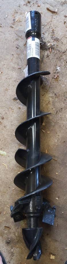

The first set of holes I dug about a month ago went great - the 9" auger sank fast and it was wonderful. Unfortunately the ground has dried enough that even two feet down there's no moisture and a new 6" auger goes nowhere.
I hung 340# off the back of it and the added downforce didn't help.
Buying a hydraulic unit for the front or a hydraulic pounder I'm sure would work, but fortunately I only need about 20 more holes this summer so a purchase wouldn't be reasonable economically.
Best I'm finding is to start the hole with the 6", use a digging bar to break things up, and go manual from there with the occasional auger attempt. Next batch of holes, I'm going to try starting with the auger and then soak the holes for a few days and see if that helps at all, and see if maybe I can find a long 1/2" auger at a yard sale to help get the water into that layer better.

Pengo carbide frost teeth are useless in clay, ask me how I know... The ones I had were at thick & as sharp as my thumb. Doing stupid thing for a couple hundred lbs of down force did nothing. Finally got a cheap farm store 6" auger & drilled pilot holes fine. Enlarged them with the 9" Pengo. Finally wised up & replaced the teeth with relatively thin dirt teeth & it worked fine. A cheap auger with thin sharp teeth will outdig a better quality auger with not sharp teeth.
I still have the 9" Pengo with a 2" round drive even though I now have a hydraulic SSQA PHD that takes 2" hex now. It's a beefy auger way stronger than the farm store ones. I sold off the cheap 2" round farm store augers with the PTO PHD. May get a round to hex adapter if I can't sell it for what its worth.

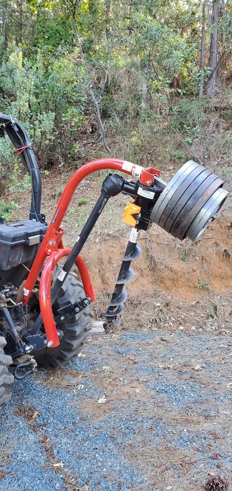

My QH mods gave me down pressure from the hydraulic toplink for a little over a foot. Not in the photo is a 200lbs chunk of steel mounted right over the gearbox held on with that handle. Both of those helped out a lot, but I upgraded to a hydraulic SSQA PHD when I upgraded to the new tractor. Not a massive increase but its an improvement in usability if not digging power.IMG_20141109_134834.jpgIMG_20150328_151018-1.jpg

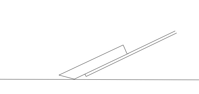

Way back in message #@, RJ suggested throwing some gravel into the hole. I wonder if anyone ever tried that trick and how it worked? It sounded good to me, because it seems like some hard sharp fractured gravel might help to tear up the clay. We don't have clay here - except for a few cherished little pockets of mostly sticky blue clay. So I don't know much except to use the right tip angle, lots of pressure, and very, very slow rotation.
If the gravel trick doesn't work, I'd agree with others to take a close look at the post hole drill bit for the angle that the tip and the cutting edge makes with the hard clay. Like any drillbit, if sharp but held at the wrong angle all they can do is skate.
When carbide won't cut clay even with lots of pressure and dead slow rotation, then what else could it be except the cutting angle?
