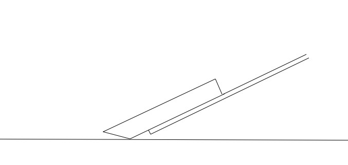

Check the angle of the cutting edge of your teeth.
Here's a diagram of a PHD auger I examined in the store. The cutter would be running on the heel of the angle, not the tip. It probably worked in soft ground but wouldn't in the really hard stuff.

/ Auger won't drill hard clay #19
Bruce
That is interesting and a good catch on your part. Same issue on subsoiler points if not set at correct angle, the subsoiler.
/ Auger won't drill hard clay #20
This was my problem as well a few months back. Over time the cutting edge had worn away until it was just a rounded edge rubbing on the clay. Made two new ones and bolted one on. I was unable to find the manufacturer to get a new (hopefully hardened one) but none to be found. So at least I have a spare.
