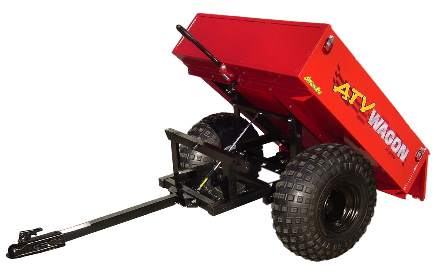

so this
Is just over a $1000 on amazon.
which the body looks much like my existing trailer. Im thinking i weld some angle iron on the the corners for reinforicement and go about reproduceing the bottom half and buy the E-cylinder and ive got $400 in it??
I have the duel wheel version of that trailer and it is GREAT! Had it for about 5 years and it is still solid and works great. I load it with a MX5100 and it will hold about 3 full buckets of dirt (and it is LOADED down) but pulls fine and can still dump the load. I would buy another one if I needed one even thought they are a bit expensive.

Partly it is a question of how ALL TERRAIN capable you want your trailer.
To be capable of going everywhere your ATV goes the trailer load has to sit LOW, between the wheels.
If the CG is above the wheels the trailer will be tippy/dangerous being pulled over uneven ground.
The MUTS in Post #3 has CG has the load low, between the wheels.
The pictures in Post #1 and Post #9 look like the CG is above the trailer wheels.

Mine has the same ground clearance as the ATV and does very well on rough terrain.
It'll handle more than the ATV will pull on soft ground.
