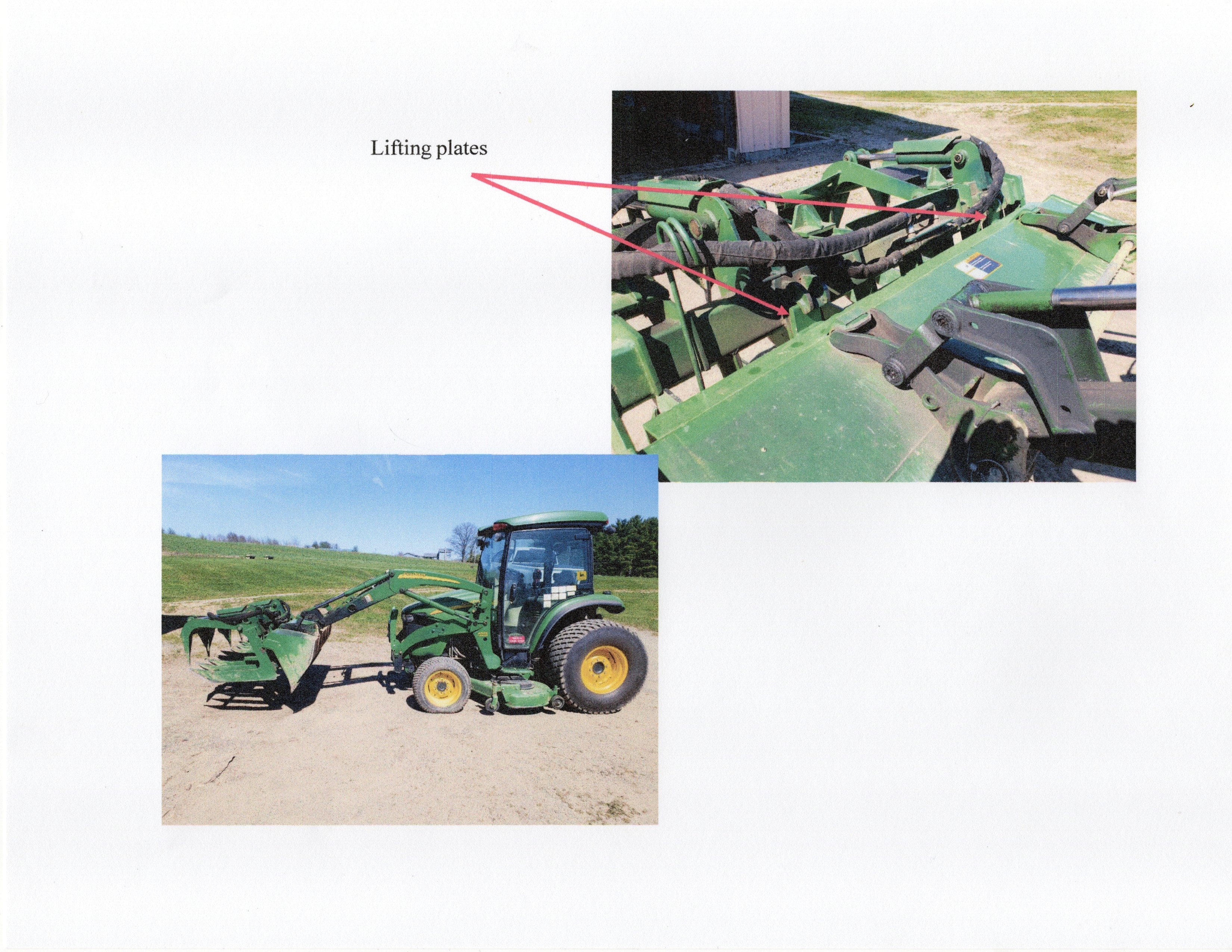

This lifting mod relates to the John Deere loader bucket pin mount. You could possibly do this same mod with a skid steer mount. I did this mod some time ago. It was after I got my grapple. I had to remove my bucket each time if I only wanted to move the grapple out of the way.
With this mod I could leave my bucket on and still move the grapple out of the way. This can be applied to other loader mounted devices. This is not intended to be used for working the implement, only moving it. Attached pictures.

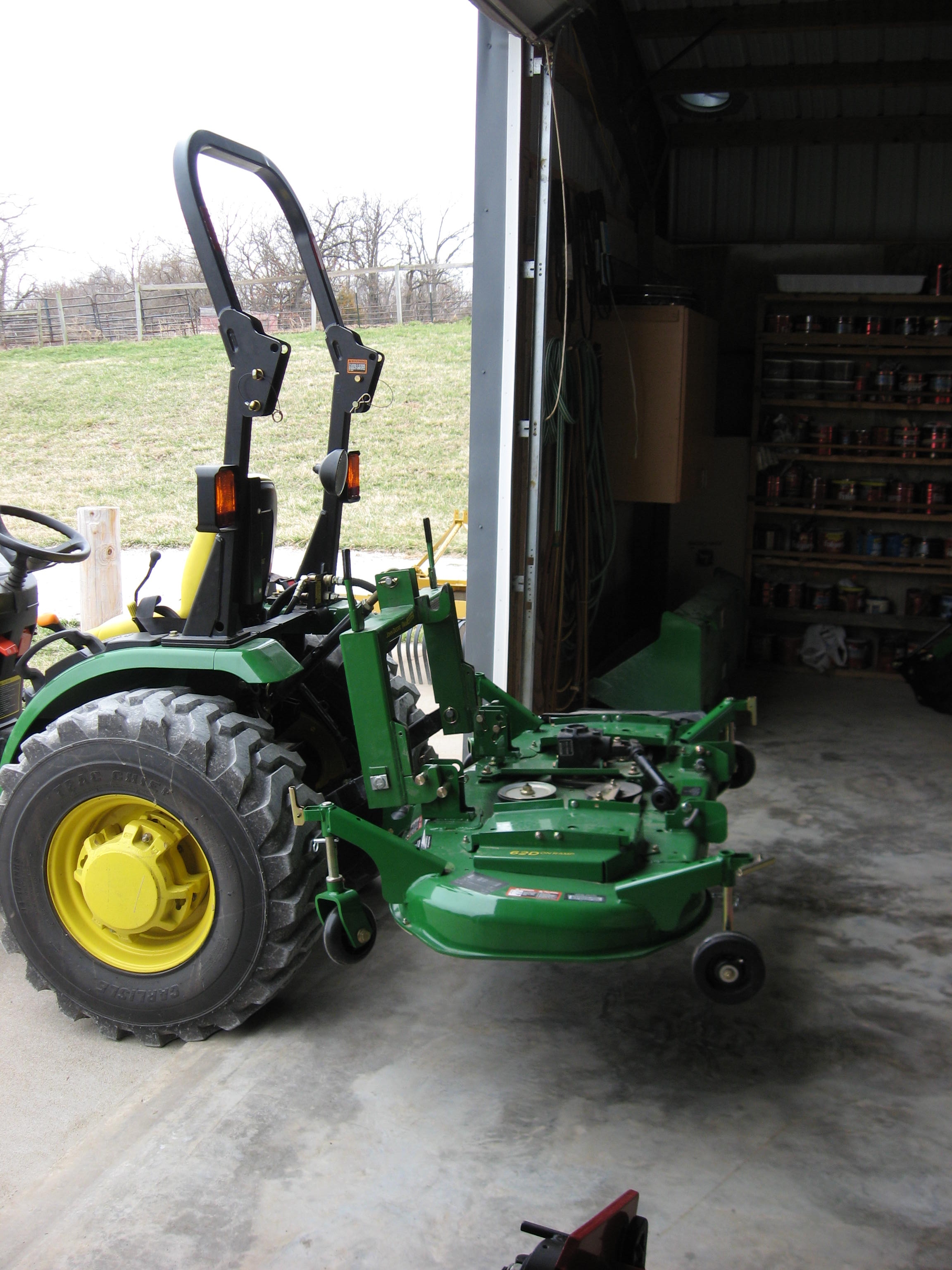

   / Lifting attachments with forklift - anyone install lifting points? #24
JD mid-mounts used to be made so you could pick them up with a quick hitch. Not sure if they still are or not.

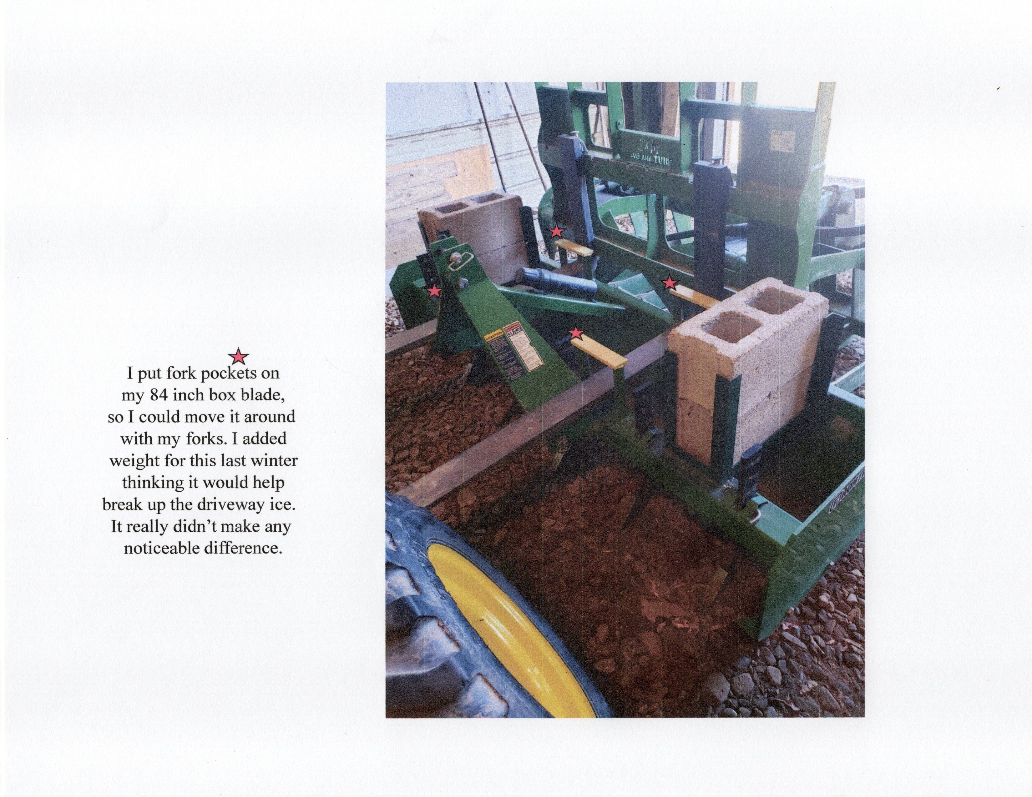

   / Lifting attachments with forklift - anyone install lifting points? #25
I modified my box blade for fork pockets, attached picture. Next will be my snow blower maybe.
