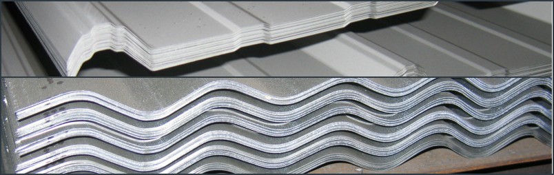

The zinc coated does, but their galvanized, they said, came in 4x10. No idea why.
/ ATV Trailer build #85
??? What is the difference?
Here is the definition: galvanizing, is the process of applying a protective zinc coating to steel or iron, to prevent rusting. The most common method is hot-dip galvanizing, in which parts are submerged in a bath of molten zinc.
Galvanized roofing panels can be 4'x10', maybe this is what they meant.
