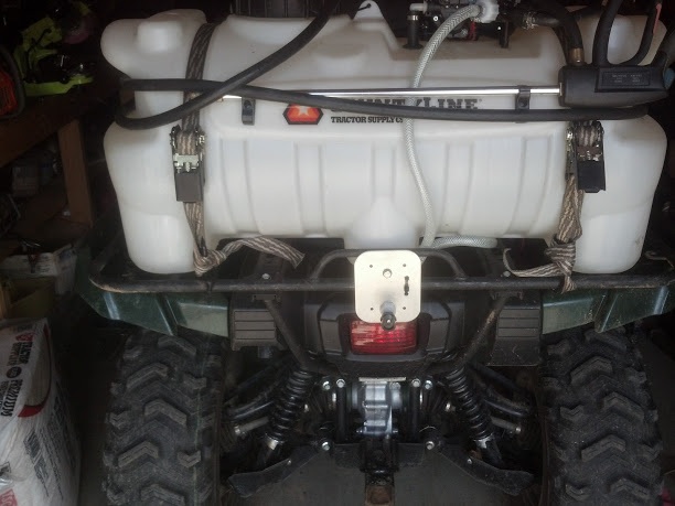

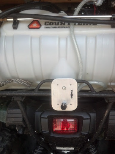

I bought a 25 gallon spot sprayer a couple of years ago. It works well for my spraying around the yard. I've wanted an alternative to the 60 gallon sprayer for the tractor. So I picked up a kit to set up the spot sprayer as a broadcast sprayer. What I found was a funky arm that attaches to he hitch of the ATV. I decided to something different so I can spray my food plots.
I used an aluminum plate I had on hand. Drilled it to accept the broadcast spray nozzle and fabricated an attachment to the rear rack. The plate attaches with a wing nut and a tie wrap. It worked like a charm!
