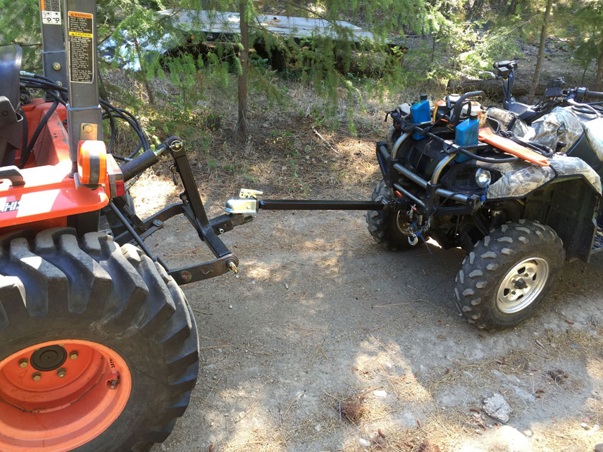

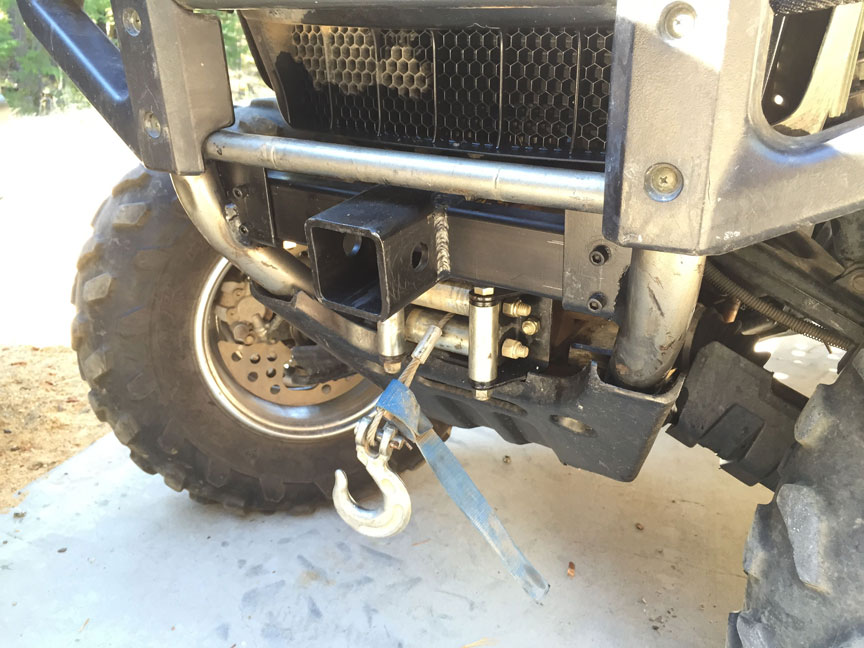

Added a front hitch to my ATV so I can tow it with the tractor. Sometimes I want to leave the tractor where I'm working but need transportation back to the shop, for whatever I broke, or forgot. Towing the ATV seems to be a good way. ATV always has a chainsaw, gas, oil on it, But I can still can load more stuff on the ATV (shovels, pick, level, chains, winch, cooler etc)
437035d1439154611-atv-front-hitch-towbar-tractor-atvhitch0tractor-jpg

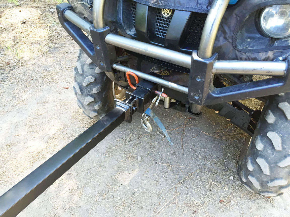

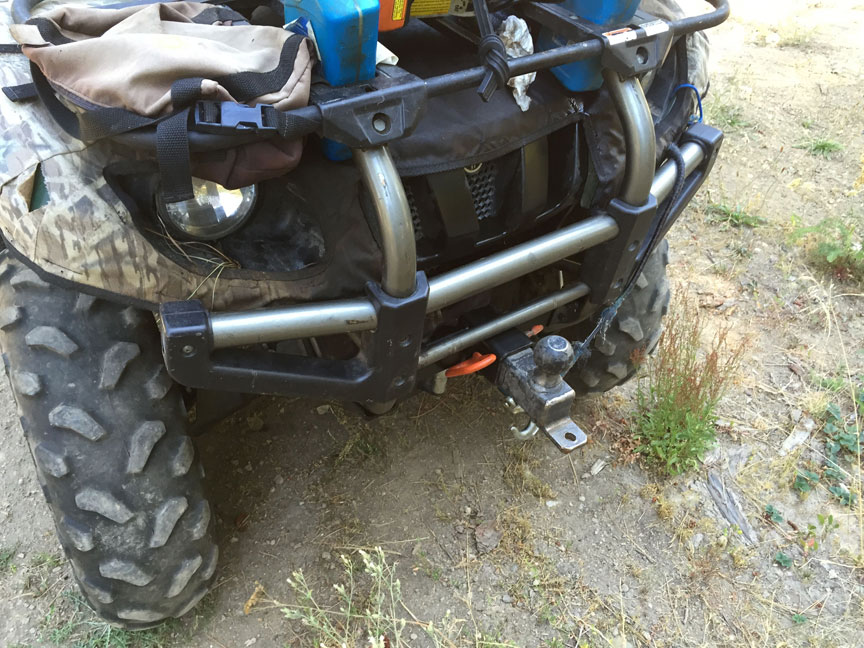

Towbar has option to use a 2" trailer ball; can tow the ATV with my pickup too. It tows nicely forward. I drove thru the forest towing it, just followed along nicely. :thumbsup: ATV doesn't reverse well (being pushed by the towbar) if the steering turns, it goes to full lock and remains at full lock, the only thing you can do is go forward again, or walk back, straighten the handlebar and reverse a little, again.
437048d1439154611-atv-front-hitch-towbar-tractor-atvhitch10tractor-jpg

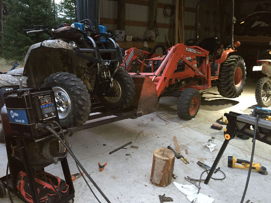

OK first things first. :D Obligatory pic showing how I lifted the ATV front to save my aching back. :D

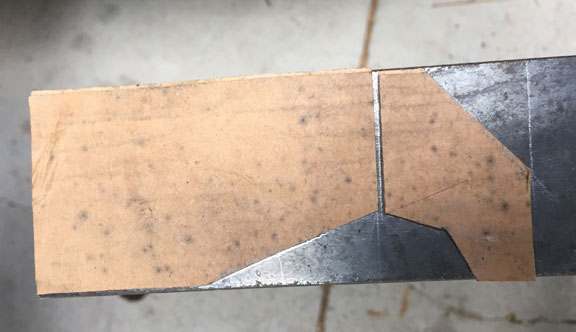

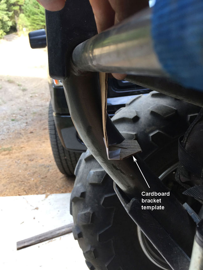

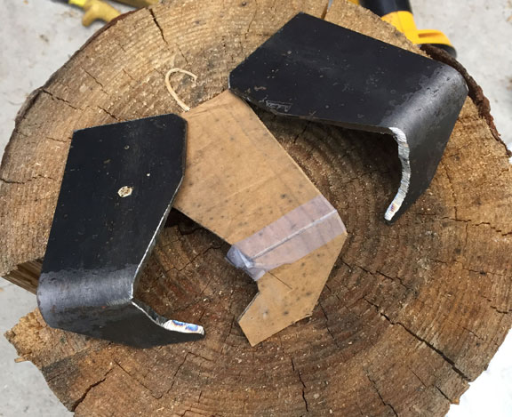

Made a little cardboard template for the bumper bracket.
Cut out the flat pattern with an abrasive cutoff blade on the angle grinder.

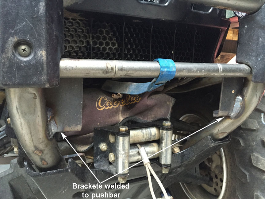

Bent the brackets, and ground them to fit the bumper tubing.
Welded the brackets onto the bumper.

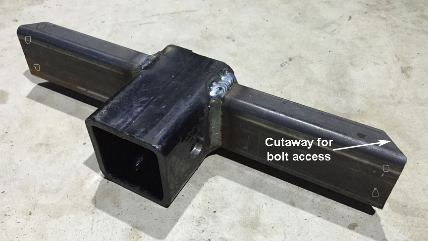

Welded the receiver.
Receiver bolted on.
437042d1439154727-atv-front-2-receiver-towbar-atvhitch7installed-jpg

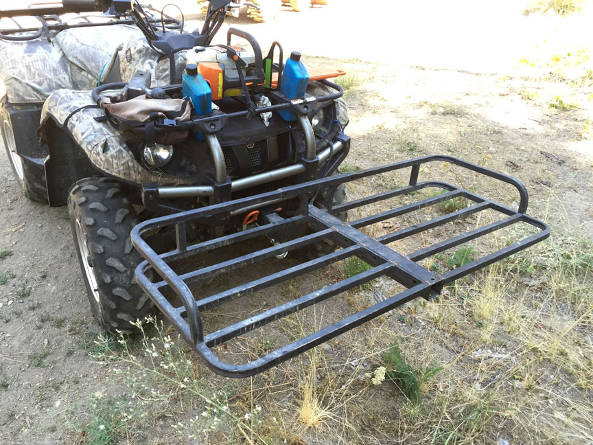

Receiver "cargo shelf" on front.
Hitch ball on front for maneuvering a small trailer or (?)

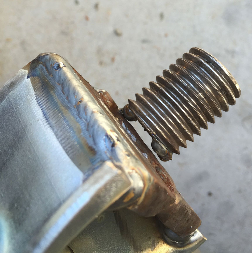

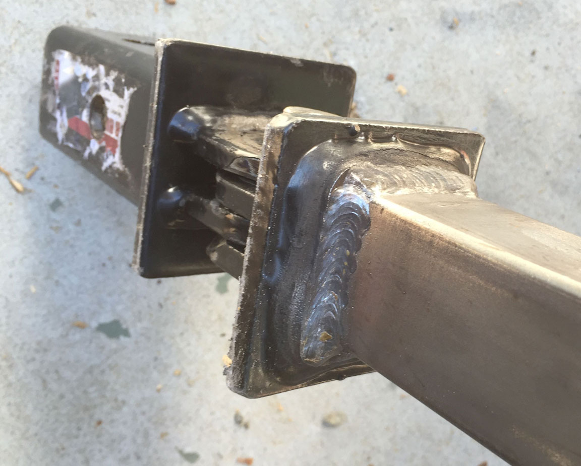

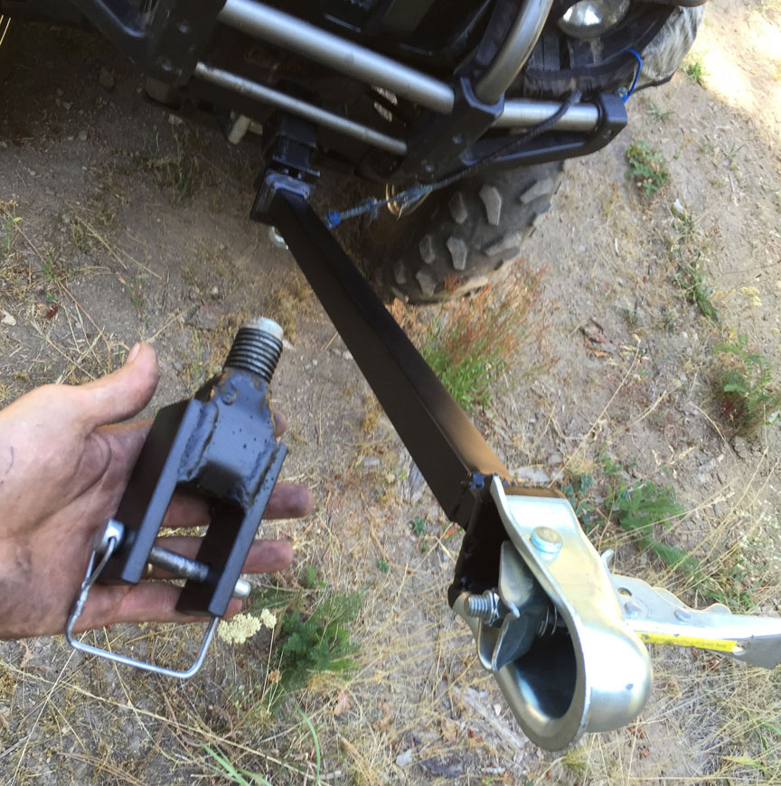

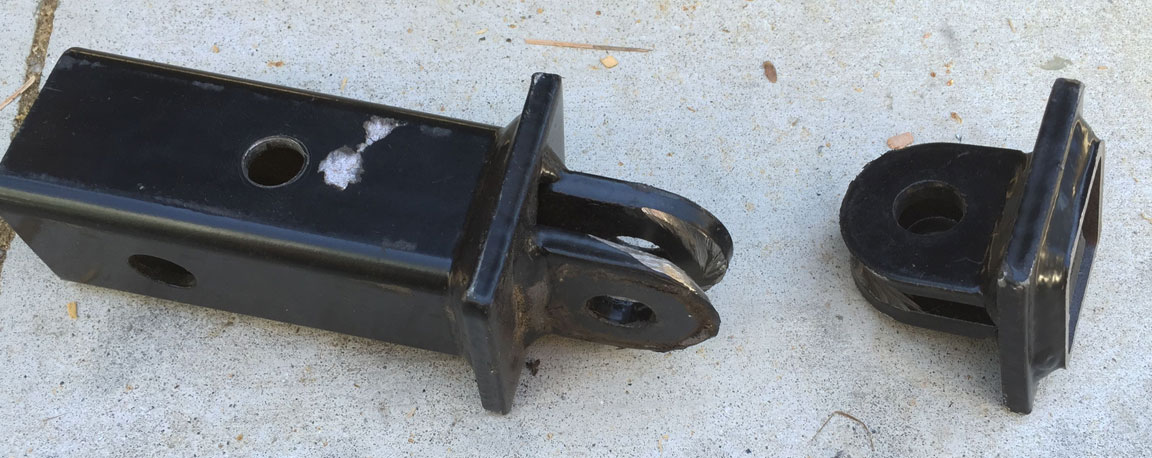

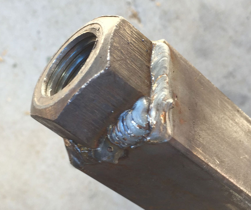

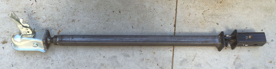

Heres the towbar construction. Also have a clevis type attachment. All of my ATV hitches have this interchangeable swivel arrangement that use a large 1" thread and welded nut.
437071d1439160897-atv-front-2-receiver-towbar-atvhitch22bothends-jpg
437069d1439160897-atv-front-2-receiver-towbar-atvhitch20towbar-jpg
Lots of ways to make a simple one-degree hinge, I used these Harbor Freight "D-Ring Hitch" parts from my scrap pile, pinned them together for the "hinge".

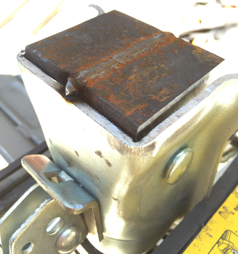

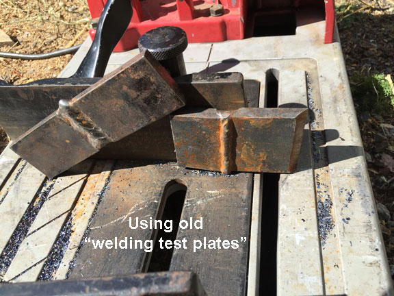

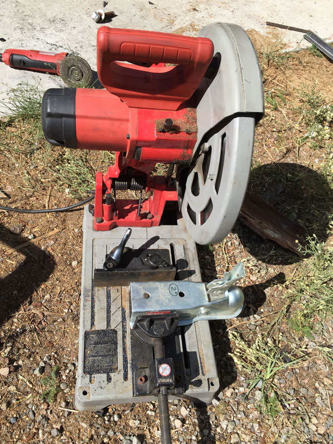

Cutting off most of a HF 2" coupler. This coupler will be a "2" ball coupler attachment" for my ATV hitch swivel.
Cutting some old 3/8" welding test plates from the scrap pile. Some might consider these to be
"historical artifacts in the push to legalize 120v MIGs for TBN members" but here they
are being desecrated as basic scrap steel ! :D

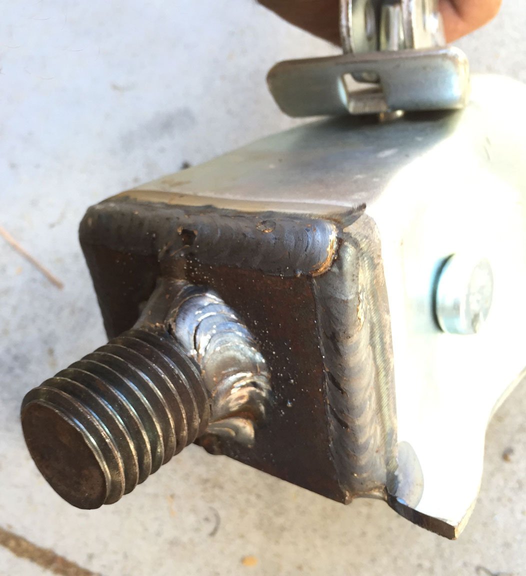

Tacked onto the shortened coupler.

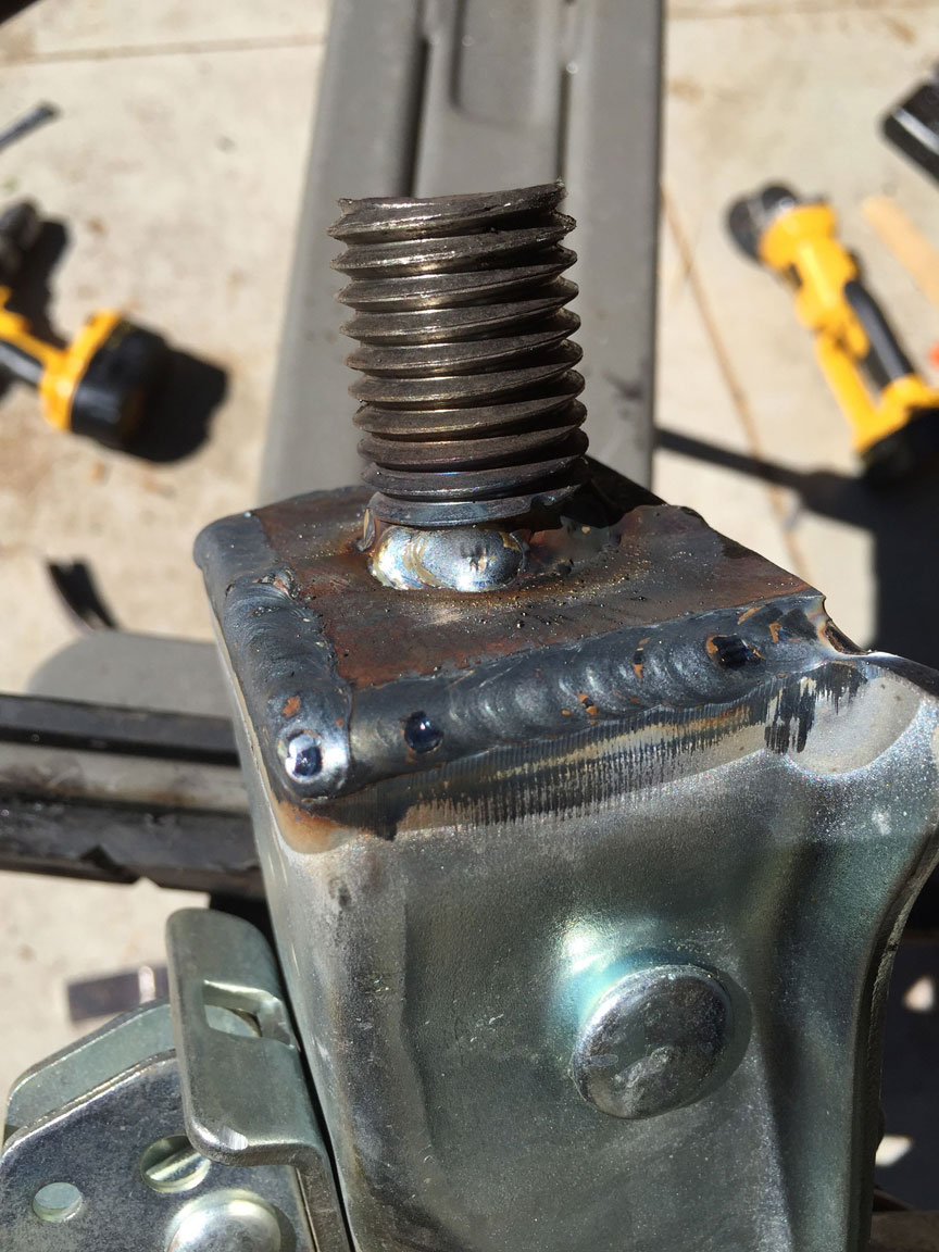

1" thread stub tacked onto plate. Trued up and ready for the root weld. Ain't that somethin' - hobby/maintenance guy slingin' buzzwords like a pro welder! :D
The root weld.
2nd pass. Actually the hobby/maint guy just "welded it twice." :D but he HAS learned a LOT on this forum. :thumbsup:
Welding towbar (1 1/2" x .065" SQ tube) to the hinge. .065 is thin wall stuff, light weight. But theres no need for thicker to drag a 600 lb ATV around the farm. I have 1/8" wall SQ tube too - but decided I don't want to have to lift it every time. Sometimes weight just adds up to more stuff to carry around. Plus it would be unwise to subject the ATV bumper to more than the thinwall can withstand. Sorry just being the engineer,,,,,, :rolleyes: Also it's just so easy to weld .065 with a MIG. If I had only a stick welder I would have used the 1/8" for sure.
Nut part of the swivel welded to towbar SQ tube.
The complete towbar.
Plugged into the ATV front receiver.

I like this towbar, I REALLY like it. Here's today headed off to "capture a seep".
Gravel in the bucket.
Drain tile on the ATV
ATV rear cargo bench to ferry 5-gal buckets of gravel to the site
Trailer full of woodchips, shovels, tools
attachment.php
Got'er done too, the water's running (trickling). Just before dark. Rode the ATV back, all the other stuff is still out there, will go get it in the AM & looking forward to it. Its a good system!
