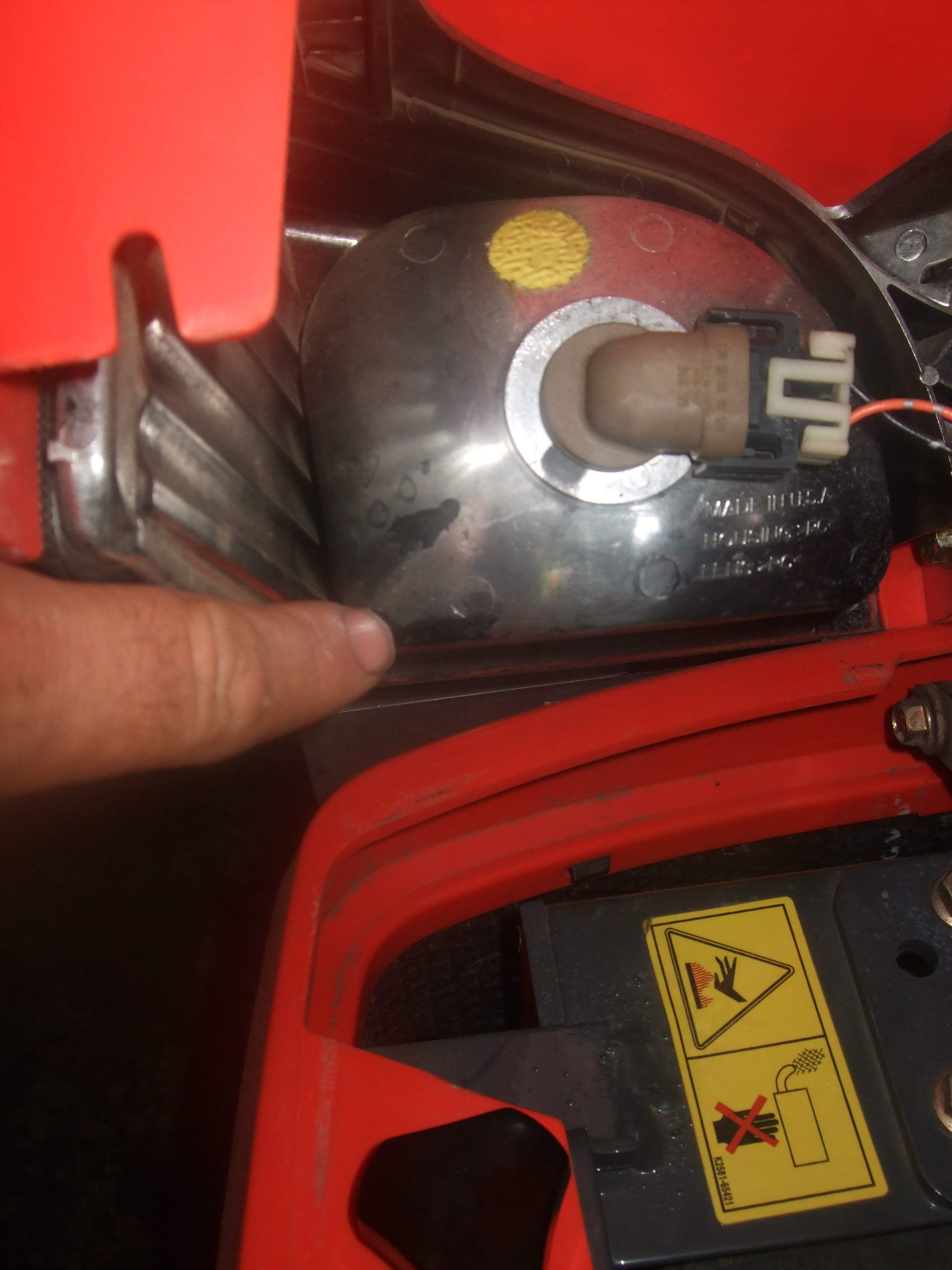

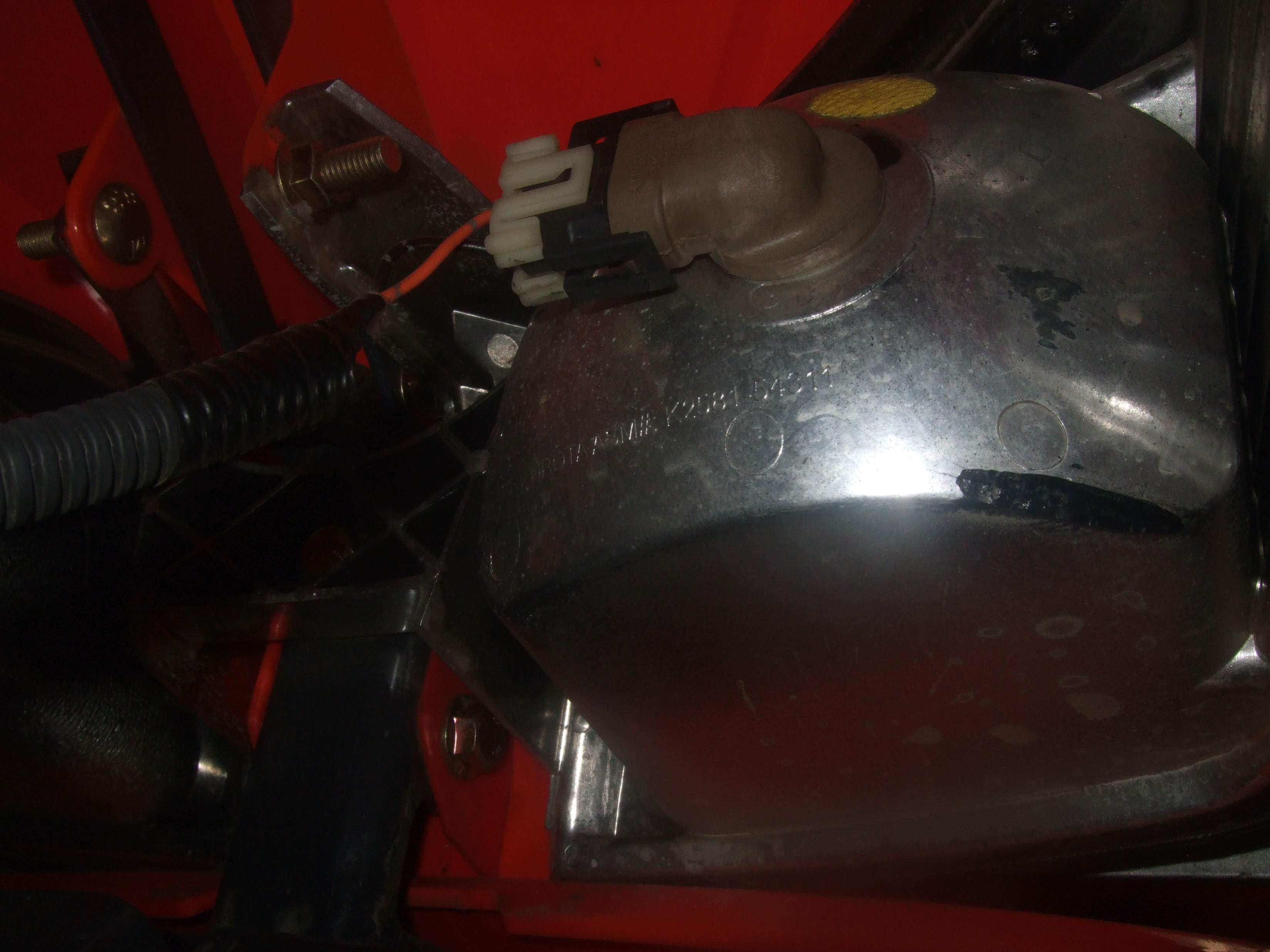

Please look at the photos on the attachment and then inspect your headlamps/headlights for the same cracks. This headlight assembly costs $170 and is a bear to install, I am on my 3rd set of headlights and I know of others who have had theirs fall out also. This is from vibration only.
Kubota says that I am the only one having this issue and I dont believe it for a minute.
Please respond if you have this issue.

That'll stop any articulation at that point . The design is poor , but that
doesn't mean you'll get any satisfaction from Kubota Corp. Fix it and
forget it . We've all had to do something like this with stuff over the

I admit- your post had me go out and take a look at my BX24. I don't have any cracks, and the it appears to be plastic too. I was wondering what in the heck would make it crack and all I can think of is excessive play in the hinge system for hood. Mine appears to have no play side to side.
One thing I did noticed that I didnt realized till now, On the ends of the headlight appears to have worn rubbing that may poke a hole in some day in future in headlight dome. It looks like the bonnet was rubbing it and I checked to see if bonnet was tight and moved all the way forward to seat and it was. I only can conclude that it was from shaking of engine when shut off. Perhaps yours keeps breaking since there is no space between bonnet tabs and headlight dome cracking it in middle since mine rubbed away already providing this cushioned space?
I think I am going to make it my next project to grind away the bonnet tab a little to stop any more rubbings.

OK I just came in from checking my light assembly on my BX2660. It is also cracked in the same area of the mounting bolt. I might try some JB weld and re-install using rubber washers. I will not pay $150.00 for a new part.

Hi Grantslicker. I just discovered the exact same problem on my 16 month old BX 2350. The cracking is in a fan pattern just like yours and appears to be fatigue/stress related.
I found your post after doing a search to see if I am the only one. It seems like something that should be covered under warranty. Were you within the warranty period? If so, did they cover it? I plan to ask my dealer about this but figured I'd see how other fared. Thanks.

Yes, they fixed it, even though my warranty had expired. In my mind was a design flaw, mine originally had the plastic hood which was even worse. Assuming you have the metal hood, they replaced the headlight assembly and at that center bolt hole they added a washer or a "shim" between the the headlight and the hood to make up for a gap. In other words when the center bolts is tightened it stresses the the center of the headlight assembly. The diagram or drawing from Kubota does not show a washer or a shim there but the regional tech from Kubota said that he installed one there to make up for the space. At first he told me it was improperly installed (by me) but then I forced him to admit that he installed a shim where the official drawing shows nothing there, in other words designed wrong and I did not install incorrectly.
Anyway this was a regional guy that came in to do the repair and I think he may have nailed it and hopefully they won't have to listenen to me complain anymore. I keep my fingers crossed.
