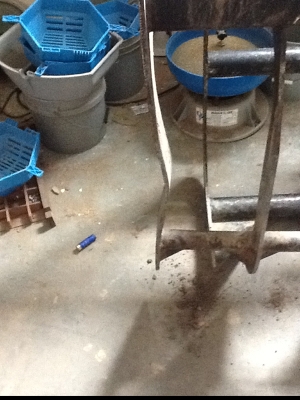

Try ramming a tree on the outside tine while going about 5 mph. I accidentally did this and it bent my grapple. How much are you paying for that job opportunity? I'd probably do that for 75 cents an hour.

Another Dillon man I see!:thumbsup:
It was an accident. I was driving through one of my trails it the woods. I had to make a sharp turn and I didn't hardly make it.
/ Attempted Grapple Destruction #28
I was referring to the vibratory case cleaner and case media separation device
Actually I don't like Dillon. I bought a load of reloading equipment at an estate sale for $50. I sold some of for more than $50, so in my book the tumbler was free. The media separator is a midway. :smile:
