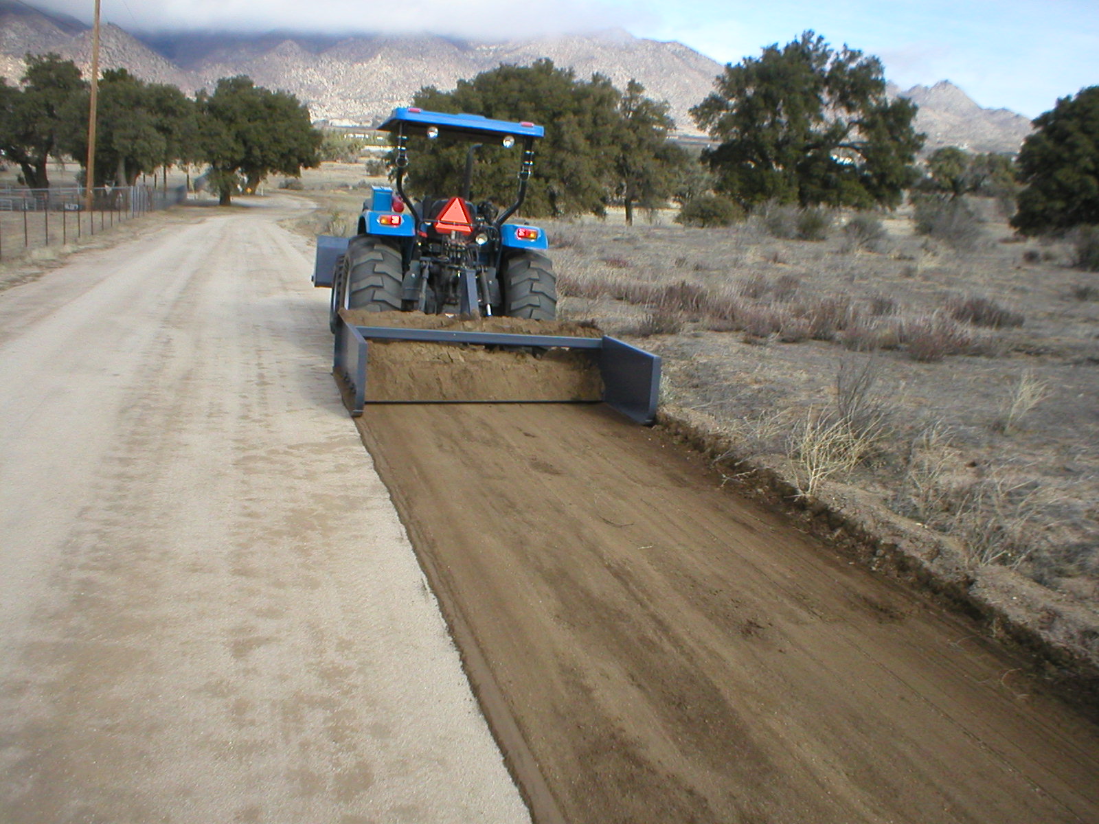

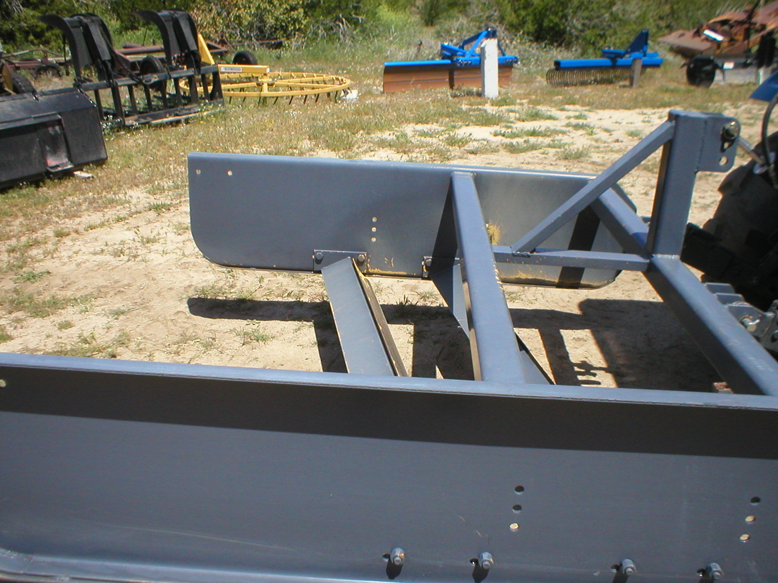

For your size tractor, (80 hp) you need to figure at a bare minimum of 800lb+ implements for what you are looking at and really 1000lb+ implements would be much better.:thumbsup:
You may want to consider a land plane grading scraper (LPGS) for maintaining your drive. Much faster and easier than a box blade. ;)

Man MtnView, how many times have you posted those pics? (I'm not complaining).
Can't wait till I get my LPGS. Maybe this spring.........

I know, I need new ones, but, I need time more than anything, that and some rain, no rain here in Southern California for quite some time now. :(
Noticing the height of the sides, I was going to ask if he ever fills it up ... and then I looked at the 3rd picture ... holy crap ... yeah, I guess so ... :eek:
/ Attachment Sizes/Ratings #13
Remember though, you can't move any dirt with these things. :rolleyes: The sides are 22" tall and 84" long. I figure at a minimum I can move 3 cubic yards at a time, if the ground has any moisture in it at all. I use it for moving large amounts of dirt when I want to even out areas. Waaaaaay faster than the box blade. :thumbsup:
/ Attachment Sizes/Ratings #14
Nice set-up, will that do gravel as well?
/ Attachment Sizes/Ratings #15
Yes these types of implements do gravel. I assume that you are talking about roads. You won't move large amounts at a time like can be done with dirt though, not that they were even intended to do that. Just a side benefit. :cool:
