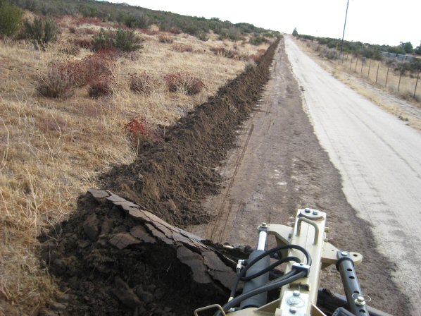

I built mine 8' wide with bolt on reversible cutting edges and set them straight because most of the time I use it to level and smooth lawns. I agree with MtViewRanch though these need to be heavily built with long skids. Mine is right at 1000 lbs and 1500 lbs wouldn't hurt a thing. I find it to be a very handy tool to have and an even larger one with 14' grader blades would work well behind a large tractor on a farm or ranch.
A good heavy duty rear blade with hydraulics would help alot with crowning and ditching too. These aren't cheap but for your use I wouldn't get a lighter duty unit, it won't hold up in Caliche.
To work Caliche you need to get on it when it has just the right amount of moisture in it to be workable without sticking. When it dries out it is like concrete, I would think you have a very small window of opportunity to work it.
edit; Include two pictures of the landplane and heavy duty boxblade with hydraulic scarifiers.

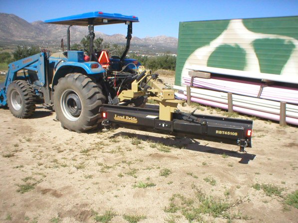

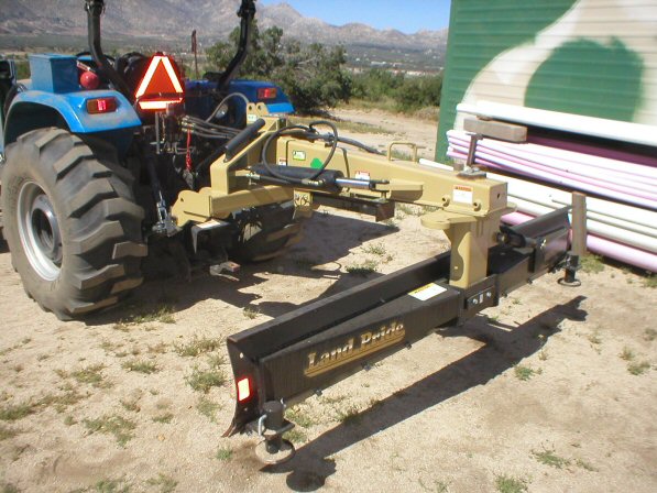

MtViewRanch could post a pic of his rearblade as his is better suited than mine is.
   / attachment for road work #15
A good hydraulic rear blade is the only way to go.

Jack,
To do a good job on the roads so that you can drive them at 20 to 30 mph you will need the rearblade and a plane/grader. If the budget will allow for all three implements, so much the better, get the boxblade too.
Alot can be achieved with any of the three choices, the rearblade is great for the ditching and crowning the road, the plane/grader is the best for smoothing and flattening (making the surface planar) and the boxblade is great for cutting down the surface to remove pot holes and redistribute large amounts of material.
So what you need the most depends on your road condition. My experience has been that the rearblade is essential to shape the ditches and crown properly, a hydraulically operated blade is ideal but the less expensive version of this blade is available with manual control. You can add hydraulics later if needed. If the ditches and drainage is already in place then a landplane/grader may be the best first tool to smooth out the road.
All three of these implements can be used for smoothing the yards, pastures and other areas on your place as well. So they are all beneficial and "keepers" in my book. I deal with a lot of properties that are rough with holes, slight depressions, mounds and have tilled and disked these places then run the landplane or boxblade over the top to smooth everything out. Makes a huge difference in the final result.
Hope this helps you decide what to do.
