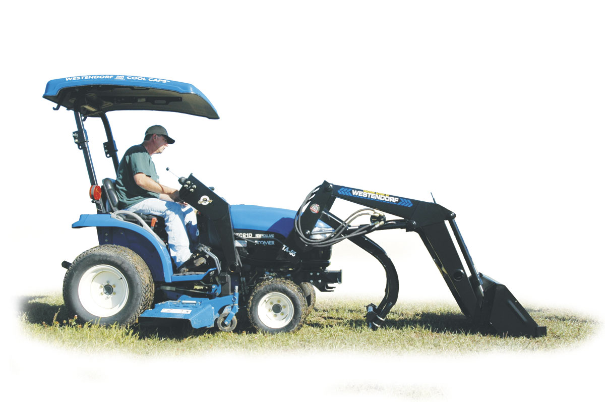

Our history indicates that it is not the make of the tractor, it is more the stature of the tractor. I show many fits in the Allis, Case, NH, JD, Kubota, Mahrinda, Cub Cadet, and Massey that are able to have a loader and deck mower installed at the same time. Kubota returned most of any that worked with both a FEL and mower, however they also returned a lot of required rear axle kits to strengthen the tractor frame when used with a FEL. Buy the tractor you want and add a Power-Mount FEL that dismounts in just minutes without any hassels, tools or stands. Then it is on when you need it and off when you need to mow.
