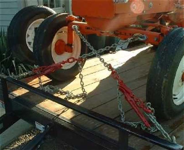

Over the last 13 years I have trailered quite a few tractors and crawlers long distances and I have had to learn the hard way a few times. I used to use ratchet straps for most applications but I noticed that once in a while they would break or tear due to the load bouncing as the trailer went over a bump in the road. I have long since switched over to grade 70 transport chain and have had zero problems.
2 things I noticed in the picture have been pointed out to me in other forums concerning tie down. Eye bolts are not considered good points to pull from as their load is severely compromised at an angle. I too have used them in the past. Second thing is the using the railing on a landscape trailer. Welded D-rings are far more secure from the frame of the trailer.

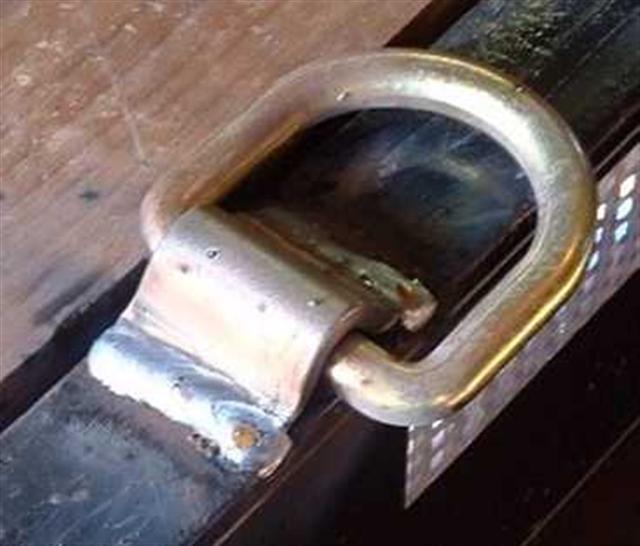

Thanks for your concern but: The chains are ran through welded on D-rings at each corner of the trailer. It's difficult to see them in that picture. Those are not I-bolts they are drop forged 5/8" lifting rings. I agree that pulling at an angle they can't carry the same load as pulling straight. Each lifting ring is rated at 5,200 so just on the front axle the combined strength of the 2 rings are 10,400 lbs on a straight pull. The front end of the tractor weights less than 1,700 lbs. so without getting out the slide rule to calculate the stress load at the exact angle I would say that it is safe as-is.
In the picture you may also notice that the binder handle wasn't tied up yet to prevent it from snapping open. That is the last thing that gets secured, usually with a heavy wire.
Here is a picture of type of welded D-rings on my trailer that I posted a few years ago:

Yeh the picture was such that I assumed you might have tied down to the railing. Good looking weld on the ring. The tractor club has someone making tie downs that attach to the tractors with implement bolts and makes for a super secure point to chain from. But they have to be custom made for each model. I too have just threaded in a forged eye bolt on the side on in the front to bind from. I got some concerns from others about that. Thats why I passed it along.
