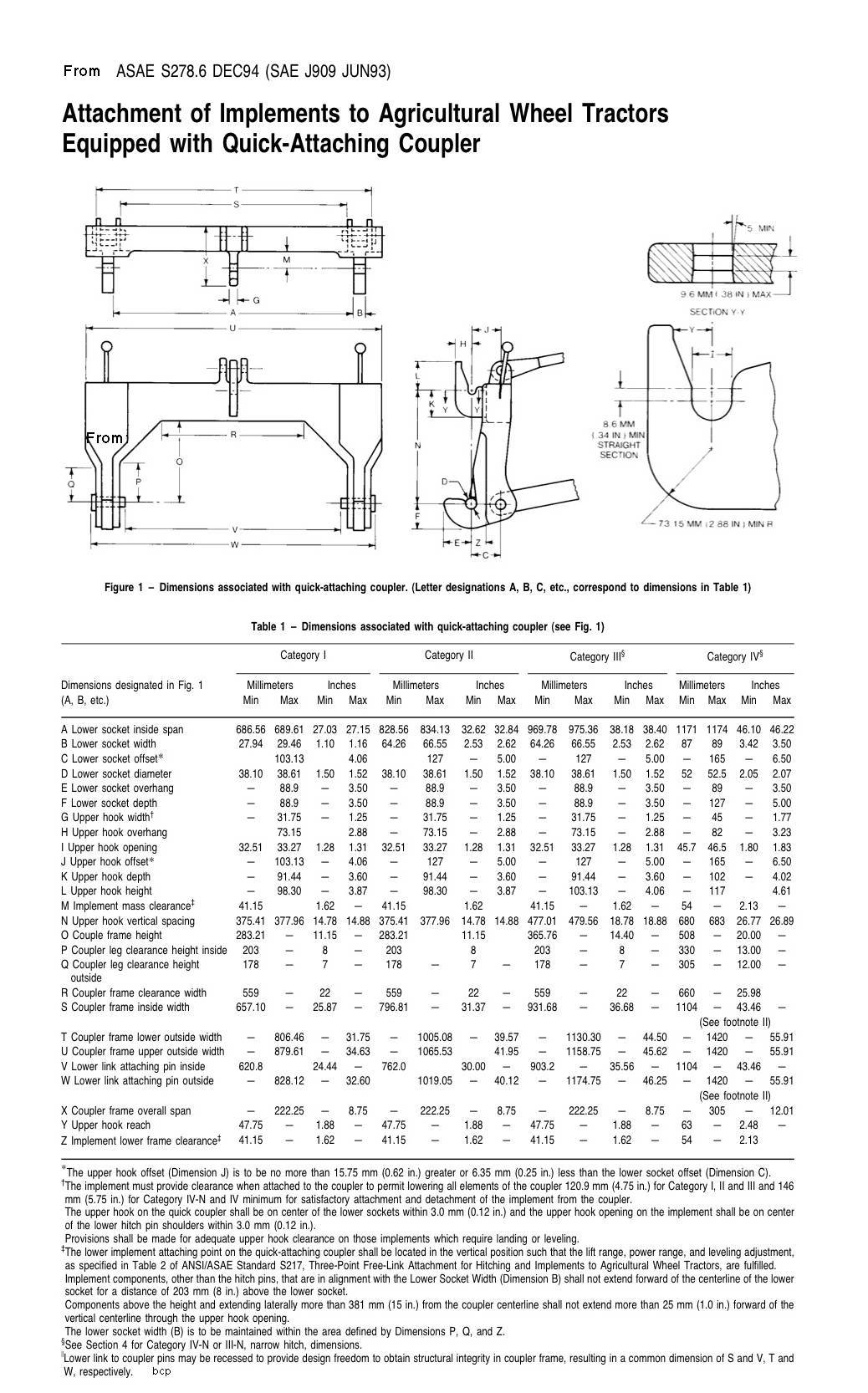

What size (how long) pin for the lift arm to attach a quick hitch on a Kiubota tractor?
   / Attach a quick hitch #2
What is width of quick hitch where the arma attach?.....Maybe a length 1/2 to 1 in. more for clevis pins .... ( "t" minus "s" divided by 2 plus length for clevis pins) Would not worry about being to long, just being to short is a problem... A good quality QH should come with the pins needed to connect QH to your tractors lift arms ...
