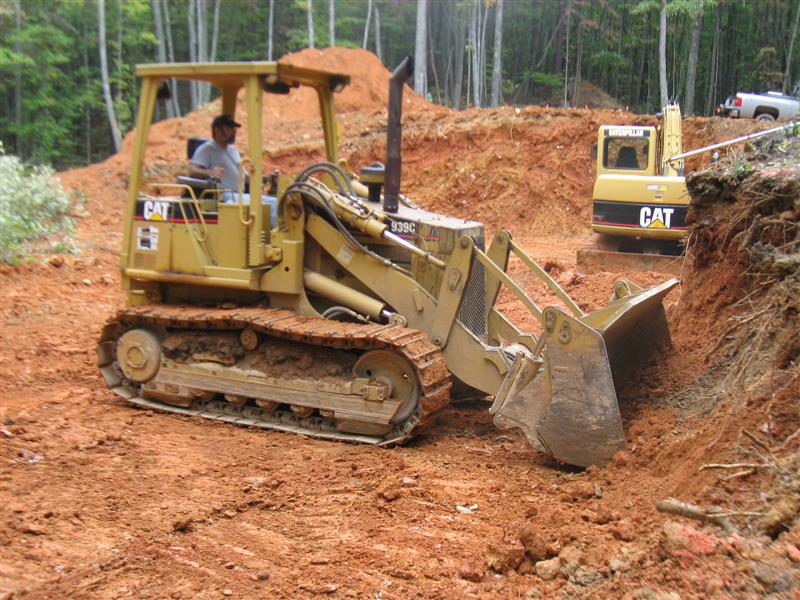

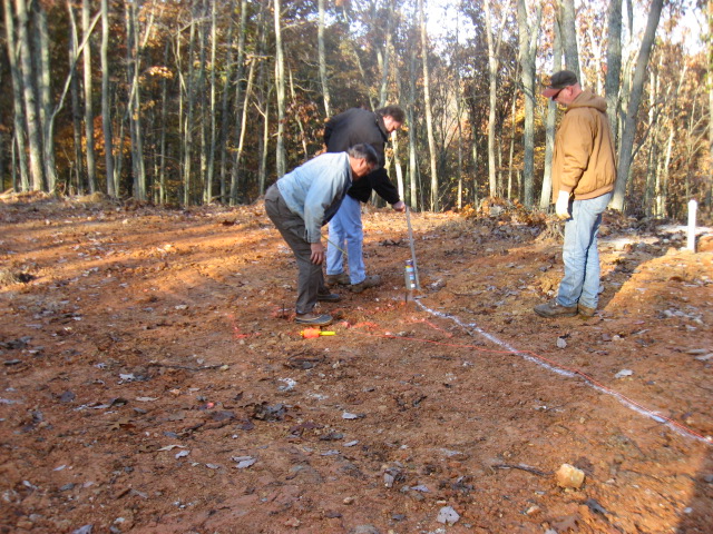

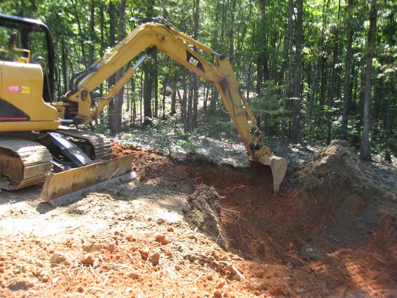

With the house plans completed, in Sept. we asked 3 contractors for bids. Two of the contractors were licensed general contractors and one was a framer who will do more than just framing. The bids from the 2 general contractors made me fall off my seat. Their quotes would make the house cost about 40 - 50% more than what it could sell for when finished. There was no way we could do that. So my wife and I are now the general contractor. We hired the framer I mentioned above to do the framing and help us do some other stuff that we don't know how to do.

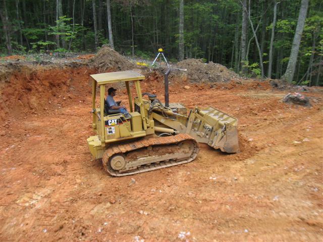

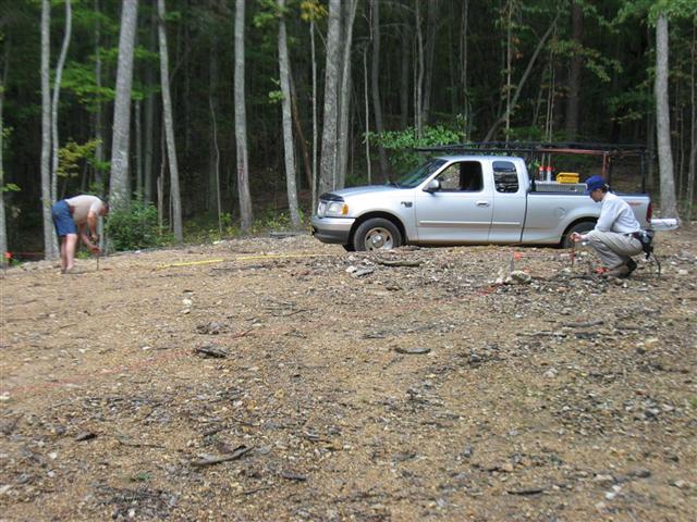

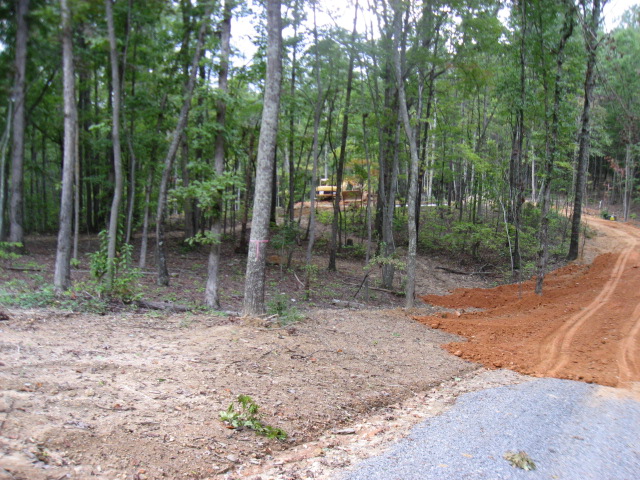

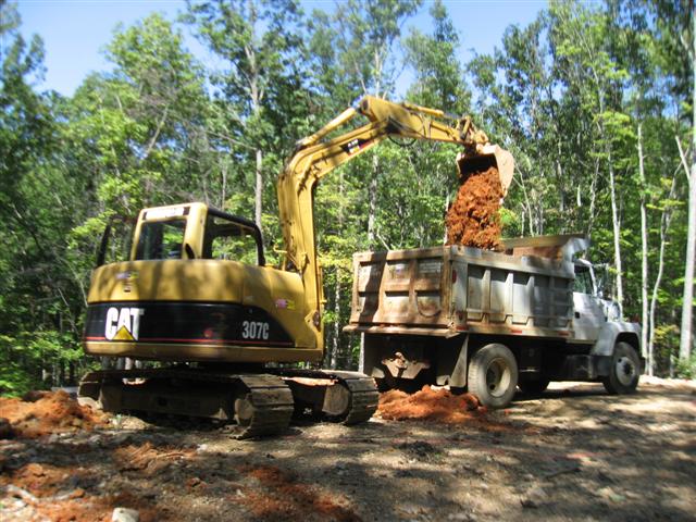

In late Sept., we marked the house and excavation began. We used dirt from the basement to raise the lowest part of the road. A lot of dirt went on this section of road. The approach to the house is much nicer now because it is not as steep.

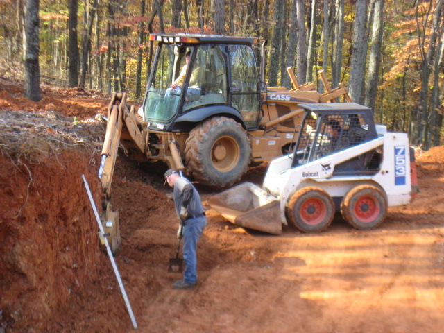

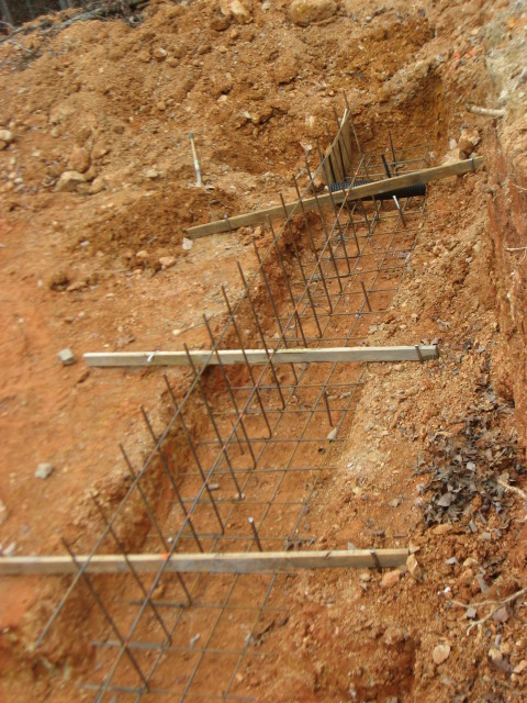

With the basement excavation completed, the footers were dug on Nov. 3.

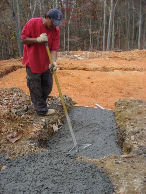

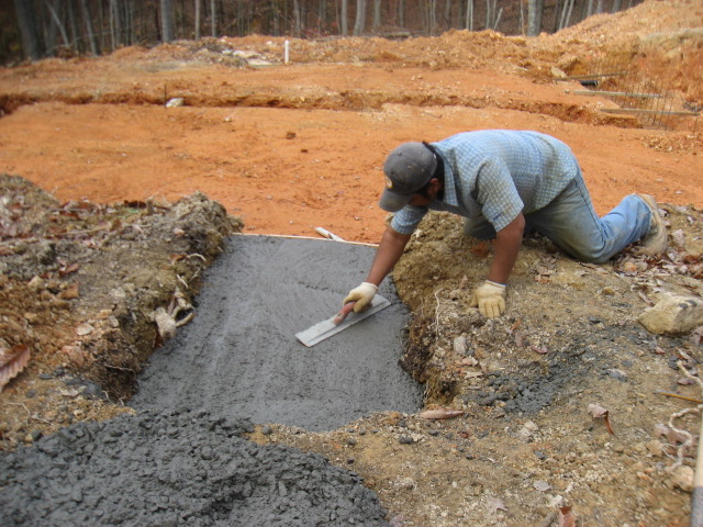

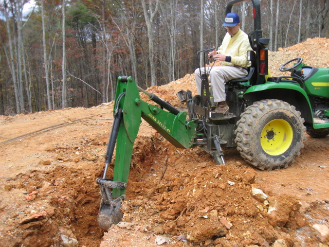

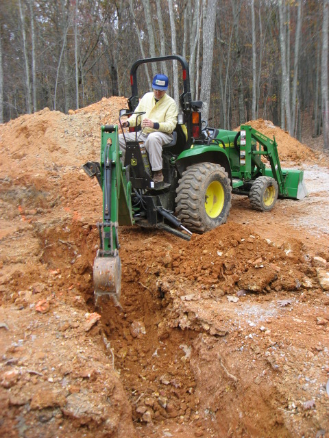

When I looked at the trenches for the footers, I observed that the footer trench did not extend underneath the garage doors. This was how our framing contractor had marked the lines, just as he had told me he would. However, when I saw the trench showing that there would be no footers underneath the garage doors, this approach began to worry me. The main floor will have a 2 car garage. There will also be a single car garage in the basement. The fact that there would not be a footer under the basement garage door really bothered me. I started imagining that the house could settle a couple inches on one side of the garage door more than the other side. I could almost see the cracks forming in the bricks on that wall. The next morning, I called the foundation guy to get his opinion. He said that for his house he poured the footers underneath the garage doors. While he said I probably wouldn't see cracks in the bricks, he said he wouldn't be surprised if the footers on each side of the garage door settled 1 or 2 inches differently. That didn't make me feel any better. The problem was, it was almost too late to dig the footers because concrete was scheduled to be poured that afternoon. The backhoe was already offsite.
I talked to my wife and she offered to use our tractor and extend the footer trenches to include the 3 garage doors while I stayed at work doing my computer job. A little later that morning, the wife called and said she was having trouble digging the trench. I decided to leave work, take a long lunch, and go out and dig the footers under the garage doors during my lunch break. When I got there, my pregant wife had finished digging 75% of the trench for the basement garage door footer. I helped her finish the basement trench, then went to the main floor garage and dug the trenches under the 2 remaining garage doors. The foundation workers dug the dirt out with shovels while I loosened the dirt and rock using my backhoe. As soon as the trenches were complete, I changed back into my office clothes and hurried back to work after a 3 hour lunch. It takes about 30 minutes to commute each way between the property and my job. The workers were able to lay the rebar before the concrete was poured that afternoon.
It was a stressful day but we got the footers underneath the garage doors and I'm extremely glad we did. Whether or not this step was really necessary, I don't know for sure. However, I believe I'll sleep a little better knowing we did it this way.

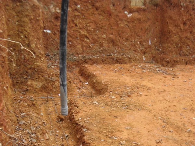

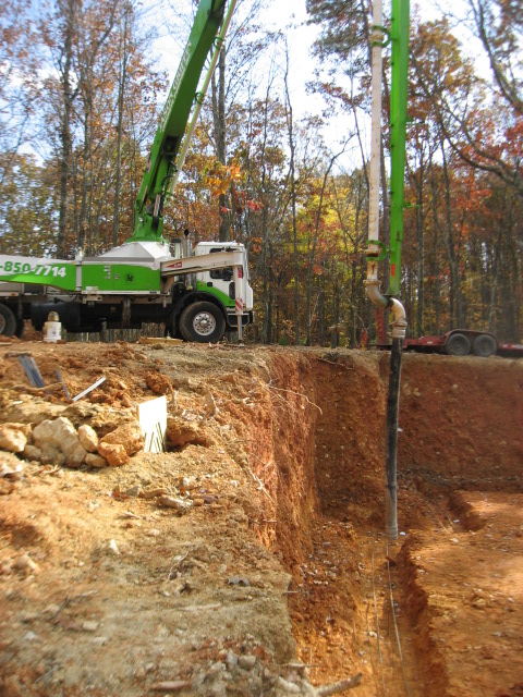

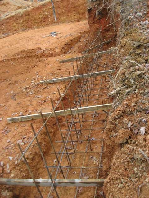

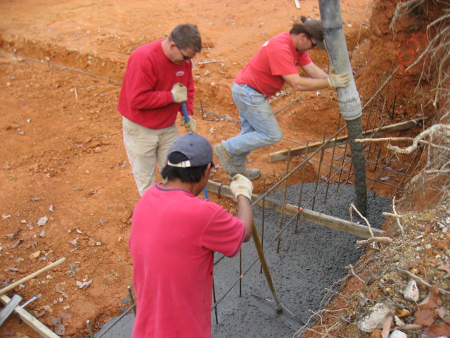

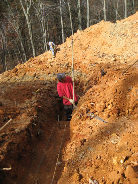

Not long after I left, the pump truck and concrete trucks arrived. It took 3 concrete trucks to fill the footers. The footers are 12 inches deep and 2 feet wide. The footers with the vertical rebar are for the two retaining walls.

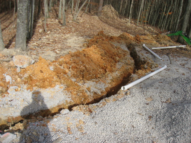

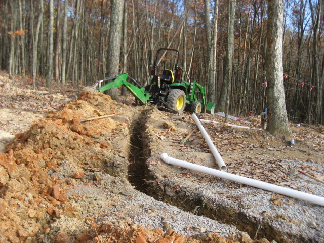

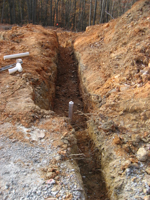

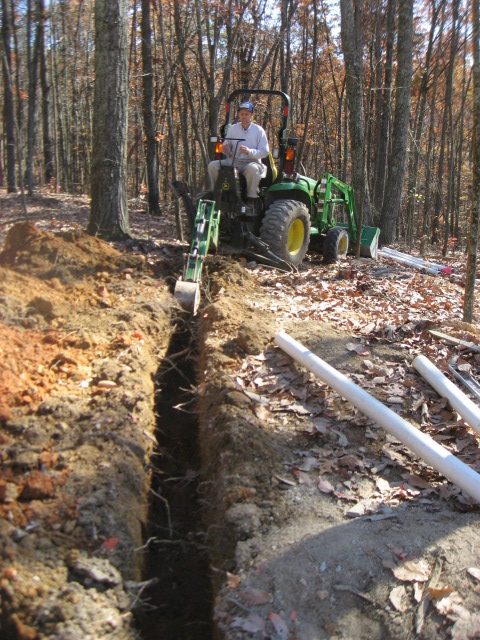

We will be moving the camper and ourselves onto the property around the time that the basement and garage concrete slabs are poured. We had our excavator install the first 80 feet of camper septic line from the septic tank along the back side of the house to a cleanout. I installed the remaining 60 feet from the cleanout to the camper location.
To get the angles right, I laid out on the ground the pipe with 22.5 degree and 45 degree joints temporarilly attached in an orientation that caused the pipe to end at the camper location. There was no science or math involved, just trial and error. With the pipe on the ground, I painted the ground around the piping to mark where to dig.
In the first picture you can see where the subcontractor's septic line ends with a cleanout. Since my tractor backhoe has a small 9 inch bucket, my trench is much narrower and the excavator's trench.

Very nice progress. Glad you found someone to do the work for a reasonable price. I also think you did good by running the footers under. I tend to overbuild everything and while I know nothing about footers it seems reasonable to want to have them tied together on both sides of the opening.

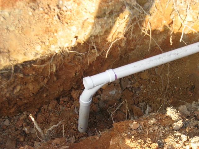

After digging the trench, I glued the subcontractor's cleanout to the piping. Just as I finished, my wife walked up and I proudly showed her my work. The first words out of her mouth were, "The cleanout is upside down." Suddenly, a nice even-keeled day of work became a drama. There wasn't much daylight left. We had to get this trench filled in because the next day the foundation contractor's trucks would need to cross this trench.
I immediately sent the wife to Lowe's to get a new cleanout. It would take her 45 minutes to get back. While she was gone, I started working on an unrelated task. It then dawned on me that I did not need a new cleanout. All I had to do was cut off the existing cleanout with about 3 inches of pipe still attached to each end, then re-attach the cleanout in the correct orientation using some pipe couplings that I had. By the time I realized this, my wife was almost back. So I cut off the cleanout, flipped it and re-attached it. I then hastilly glued the rest of the pipe in the trench and fine-tuned the pitch of the piping. I finished gluing the pipe just as it got dark. Unfortunately, my wife and I had to backfill the trench in the dark using a flashlight and tractor lights. Backfilling was more painful than you might think. Because of all the large rocks in our ground, you can't just dump the dirt in with the tractor. You have to make sure the large rocks aren't against the pipe or you could break the pipe as the dirt settles. Thus, I would dump some dirt in the trench and my wife would throw out the large rocks.

Can't imagine why there would be no footer below the garage doors. People get funny ideas in their heads.

Good job on the footing under the garage doors. I can't imagine why that wasn't done from the beginning. It's not that much more work, or even that much more money in concrete and rebar, but the advantages are pretty significant.
On the cleanout, I put in two. One going in each direction, right next to each other. While it's rare to need them, when you do, it's sure allot cheaper to have them there, then to have to remove the toilet or find some other way to get to what's in the line. With a kid on the way, anything is possible that might get flushed down the toilet. Hotwheel cars and small plastic animals are very common.
