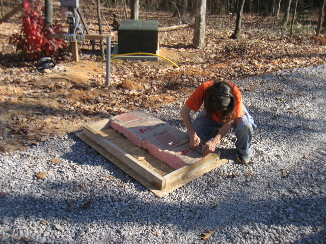

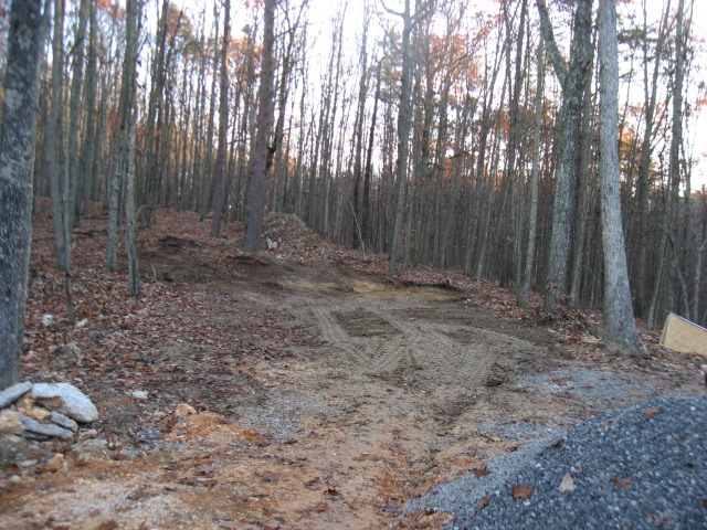

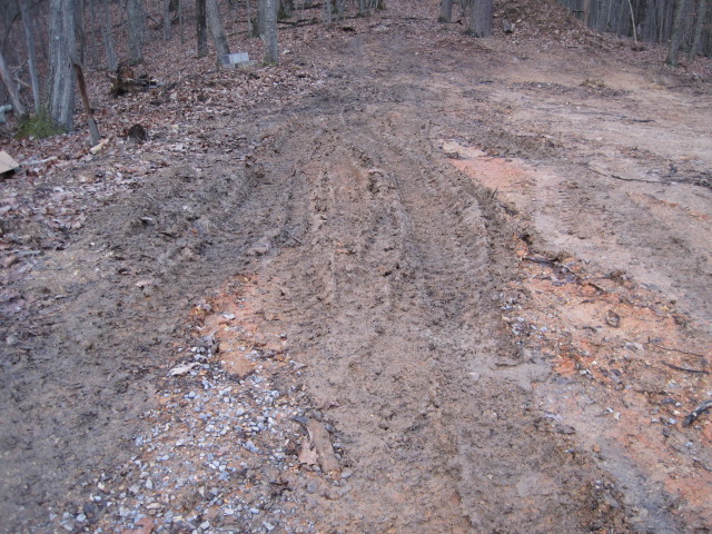

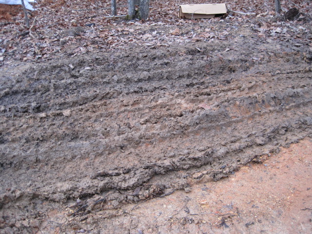

This past Saturday, I went to the property and wired up on our temp electric pole a 30A jack for our camper. We have a long extension cord that I made a few years ago using outdoor grey wire from Lowes. I just added a jack and and a plug to the wire. The wire is probably 100 feet in length. My homemade extension cord cost a fraction of what one at a camper store would cost. My wife found a plastic water hose reel that had been thrown away that we use for rolling up the extension cord.
Saturday morning we got 2 inches of snow which melted in the afternoon. I wish I had take pictures of the snow in the woods here. It was probably pretty but I was too distracted concerning the work I had to get done before moving to really notice.
Three weeks ago I had prepared the pad for the camper; the camper pad was in fairly good condition in spite of the wet conditions. However, due to building materials that had previously been in the way, the area for the storage trailer was not it great shape. And now the snow didn't help matters because it saturated the ground. Later in the afternoon on Saturday, I thought the ground had dried out enough for me to use my tractor to at least get rid of the ruts that the concrete trucks had made. Well, as I started using my tractor tires to even out the ruts in the soft dirt, I ended up making my own ruts. I was able to do some good but there was a low spot that was just unfixable in the conditions. The truck and storage trailer would have go through this low spot in order to put the storage trailer in its final destination.
Saturday I left the property resigned to the disappointment that I would have to ask the trailer mover to park the storage trailer in front of the future garage. I would have to move the storage trailer myself with my truck at a later date when conditions were better. I know it sounds pretty easy to just hitch up the trailer to the truck and back it in place. However, the trailer is completely full and very heavy. Moving it is a real effort. The trailer is so heavy that I can't lift it by cranking the jack handle. I have to put blocks under the tongue and use a small hydraulic jack to jack it up. I can only jack it up with this jack about 6 inches at a time. Then I have to add more blocks or wood and jack some more. This process takes forever. Also, once the camper got parked, the maneuvering room for moving the storage trailer would even be more constrained.

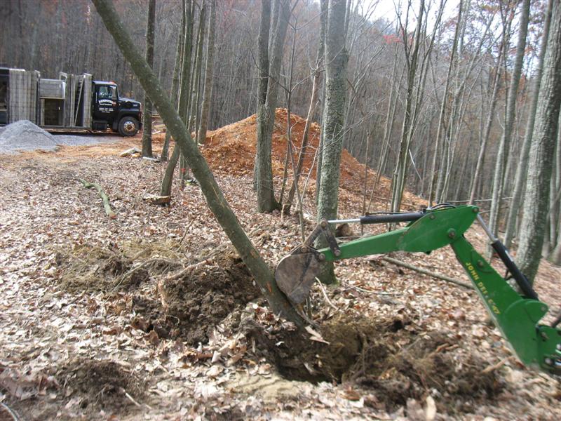

Sunday morning, the wife and I got as much ready for the move as possible. Don arrived with his Chevy dually at around 11:30 AM. Don is wearing an orange coat in the pictures. I had blocks and my hydraulic jack all set up for jacking up the storage trailer tongue. We hitched up the storage trailer to Don's truck and caravaned to the property with two of our cars. When we reached the bottom of our steep street that runs straight up to the top of the ridge, we had Don park his truck and our trailer. I drove him to our property so he could decide how he would maneuver the trailer. I recommended that Don might want to back the trailer down our 900 foot long driveway because of tight maneuvering conditions. However, Don wanted to pull forward down the driveway and turn around at the house site.
We went back to the bottom of the street where Don had parked. Don drove the trailer right up the steep grade without any problems. I was concerned that the low trailer might drag down our driveway. However, dragging was not an issue. I'm pretty proud of our driveway. It has handled the large vehicles fairly well.
When Don reached the house site, he started maneuvering the trailer in position to back it up into its final destination, not the temporary spot in front of the garage. I really wanted the trailer in its final spot and was happy to let Don try it. As he was maneuvering, a pile of gravel was in the way so I moved it with my tractor.
Once the gravel pile was out of the way, got the trailer lined up and backed it toward its home. Unfortunately the back of the low riding trailer hit a hump in the parking pad it could not get over. I got on the tractor and started back-dragging with the front end loader but didn't make much progress because the hump was to well settle and hard. This hump was just to the right of the low muddy point we were trying to avoid. Don asked if he could use the tractor and I let him. He started digging with the FEL. I was grimmacing because I was watching my hard packed dirt get removed and deposited as soft dirt on the camper pad. And with conditions left over from the previous day's snow, I knew what would happen to all this (now) soft dirt - MUD! Don saw me grimmacing and got off the tractor and said he saw I was displeased and didn't want to make me unhappy. I tried to smile and told Don to keep going so he did.
After removing the hump, Don backed up the trailer. As he maneuvered back and forward, his truck kept sliding little by little closed to the low muddy area. With heroic efforts, Don eventually backed the trailer into place. What a relief! I was dreading having to move the trailer myself later.
