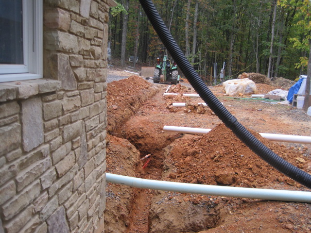

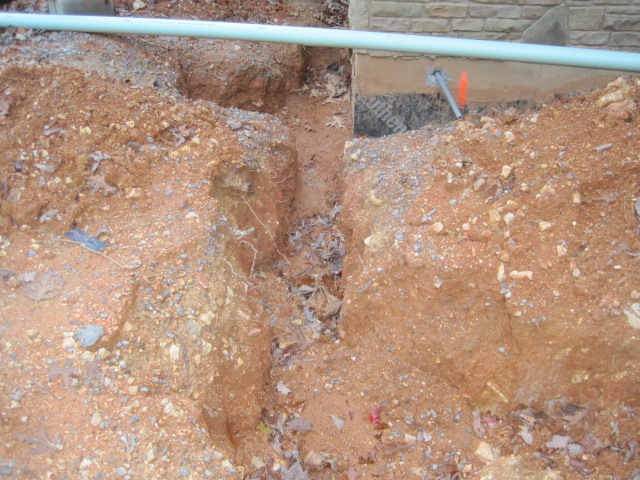

The delay in installing the waterline from the well to the house caused by the well guy last week has had some negative impacts. He was supposed to install the waterline last Friday (6 days ago) but had failed to verify his helper would be available. So the big push to get the "early on" electrical permit last week was somewhat in vain.
Sunday night we got 1" of heavy rain. The black temporary drain pipe we have attached to the gutter came apart during the heavy rain and dumped a lot of water into the trench. In addition, water came through the basement wall where the electrical service line runs through the wall and attaches to the one of the house electrical panels. Fortunately we did not see any other water in the basement. The foundation drains must have helped. I opened the covers off both electrical panels in the basement so they can dry out.
Tuesday my wife reattached the black drain pipes and put screws in them to prevent the pipes from coming apart again. Tuesday night we got 2 1/2 inches of more rain. Wed. and Thursday the waterline trench had several inches of water in it. Fortunately, we didn't appear to have water come through the electrical hole again.
attachment.php
In preparation for having the waterline installed tomorrow, tonight, I cleaned some of the debris from the storms out of the trench using hand tools. It was a muddy mess and not much fun. There were some places where the sides of the trench had caved in from the tremendous amounts of rain. I had to shovel out the cave-ins and remove rocks and extra silt from the trench.
I don't know what is is about digging near the house by the dining room. It just seems that when I do so, we get some unusual rain and I have to redo the work. For example, back in May when I was working in this spot, I got rained out and had to completely re-do the drain tile I had almost finished installing.
Some of the rain that hit Memphis and Nashville also reached here. We did not get nearly as much but we still go enough to cause me some extra work. We got 3 1/2 inches of heavy rain. I was working on this drain tile when the rain started and I had to stop. I was 15 minutes away from finishing. I had a steady stream of rain running down from the roof valley onto this spot and there was no way I could continue working. Unfortunately, my drain tile and gravel got filled with silt so I'm going to have to completely redo it including shoveling out all the gravel and replacing it with clean gravel.
I'm wondering if someone buried a root near this spot and put a hex on it.

Water shouldn't be coming in the conduits for the electrical service. Make sure the electrician seals those conduits with electrician's putty, and I'd say make him do it ASAP, unless they are going to be running more wires through them. It is required by code (at least up here, probably everywhere)

Dave,
They "sealed" both electrical panels in the basement with silicon caulk. The caulk in one of the panels looked good and didn't leak. However, the caulking of the other panel was visibly poorly done and is the one that leaked. We will get it caulked. However, once we fixed the temporary gutter drain, it did not leak again even when we got 2 1/2 inches of rain. Caulk is a last ditch attempt at preventing the water entry. The real solution is to prevent the water from reaching the electrical hole to begin with.

They "sealed" both electrical panels in the basement with silicon caulk. .... Caulk is a last ditch attempt at preventing the water entry. The real solution is to prevent the water from reaching the electrical hole to begin with.
Obed
Absolutely, but that is also a main reason to keep penetrations out of the foundation walls if possible. Around here, most electrical service comes in through the rim joist, if it goes in to the basement. Very little chance for water intrusion that way (assuming reasonably proper detailing...) as it is above grade. When all you have is the caulk as the seal, you will eventually get a leak... In your case, you clearly understand the need to keep roof drainage and surface water away, you just aren't done yet. Carry on!:thumbsup:
