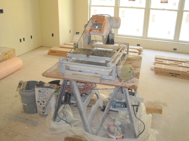

The first 3 pictures are the master bath.
The second picture is the hall bath.
The 4th picture is the laundry room facing the W/D connection. Note: The floor slopes to the middle where there is a drain in case the washer tries to flood the house. I had a co-worker whose washer flooded two floors of the house. We hope to prevent that nightmare. The smaller tiles enable the tiles to be sloped toward the drain.
The 5th picture is the laundry room facing the laundry sink cabinet.
None of the grout has yet been installed.

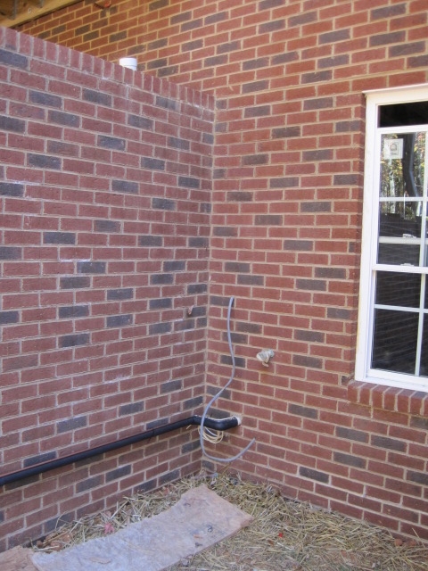

We got the H&A units mostly installed. The outside unit requires an electrical disconnect installed on the outside wall. The third picture shows a grey wire coming out of the wall where the disconnect needs to be installed. Both the electrician and the H&A sub both claimed that they "never" install the disconnect but that the other guy "always" installs it. After you've heard claims like these for the umpteenth time, you get so you don't believe half of what the workers tell you when it comes to getting out of work.
So my wife got disconnect installation prices from both the H&A guy and the electrician and asked the H&A guy to do it because he was cheaper. There's a part of me that thinks the disconnect should be part of the electrician's job original bid and now he's just trying to get out of doing it or trying to get extra money. Let's face it; every house will have one of these so why wouldn't that be part of the electrician's standard job? How is this disconnect different from wiring up the outlet for the refrigerator?

I sure agree with you..Seems like the electrician would be responsible for the disconnect....I wonder what the inspector would say?....surely they have to have some opinion on this as they have on everything else :)....It could be that the A/C guy would have to connect his equipment to the switch, but electricity is electricity...Tony ps You are almost there :) and I know you will be pleased with yourself..
   / At Home In The Woods #2,145
Yeah that's the electrician's job, for sure. But I think you have discovered that you did not find a decent electrician already. It is a big problem with residential electricians - many of them look at it as scut work, best I can tell, and they cut corners and try to bang it out as fast and cheap as possible. I bet he is using the push-connect outlets too (where you just push the wire in the spring contact socket on back of the 29-cent outlet and hope it remains connected and doesn't cause a fire from a high-resistance connection in a couple years). Well why not? It's fast and cheap! :( In my place(s), I only use screw contacts and spend the extra money for commercial grade outlets. They are only like $1 ea, which is a trivial cost increase but the quality is way higher.

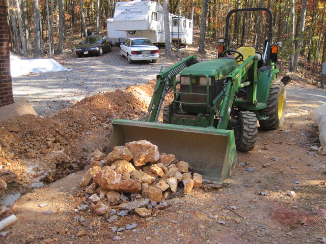

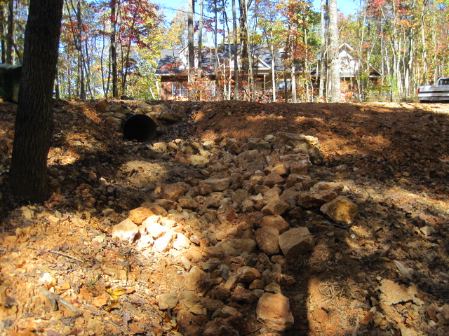

I straighted up the mess below the culvert. Originally I had haphazzardly dumped a bunch of brick and concrete debris below the culvert. It ended up to be a big ugly pile. I really didn't like being able to see the brick and concrete rip-rap right beside the driveway. This week after work I tossed the whole pile, brick by brick, down the gully. I loaded some rocks from the waterline trench and put them below the culvert near the road in a more orderly fashion. I like the looks of the natural rocks as rip-rap much better than the bricks, mortar, and concrete. The bricks, mortar, and concrete are still acting as rip-rap to resist the gully's washing out, but they are now farther away from the driveway and less noticeable.
