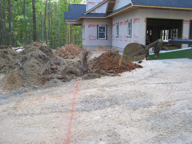

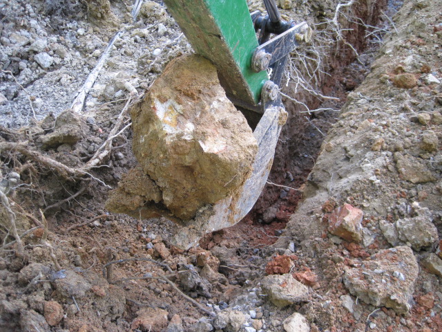

The delay in installing the waterline from the well to the house caused by the well guy last week has had some negative impacts. He was supposed to install the waterline last Friday (6 days ago) but had failed to verify his helper would be available. So the big push to get the "early on" electrical permit last week was somewhat in vain.
Sunday night we got 1" of heavy rain. The black temporary drain pipe we have attached to the gutter came apart during the heavy rain and dumped a lot of water into the trench. In addition, water came through the basement wall where the electrical service line runs through the wall and attaches to the one of the house electrical panels. Fortunately we did not see any other water in the basement. The foundation drains must have helped. I opened the covers off both electrical panels in the basement so they can dry out.
Tuesday my wife reattached the black drain pipes and put screws in them to prevent the pipes from coming apart again. Tuesday night we got 2 1/2 inches of more rain. Wed. and Thursday the waterline trench had several inches of water in it. Fortunately, we didn't appear to have water come through the electrical hole again.
attachment.php

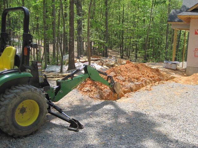

In preparation for having the waterline installed tomorrow, tonight, I cleaned some of the debris from the storms out of the trench using hand tools. It was a muddy mess and not much fun. There were some places where the sides of the trench had caved in from the tremendous amounts of rain. I had to shovel out the cave-ins and remove rocks and extra silt from the trench.
I don't know what is is about digging near the house by the dining room. It just seems that when I do so, we get some unusual rain and I have to redo the work. For example, back in May when I was working in this spot, I got rained out and had to completely re-do the drain tile I had almost finished installing.
Some of the rain that hit Memphis and Nashville also reached here. We did not get nearly as much but we still go enough to cause me some extra work. We got 3 1/2 inches of heavy rain. I was working on this drain tile when the rain started and I had to stop. I was 15 minutes away from finishing. I had a steady stream of rain running down from the roof valley onto this spot and there was no way I could continue working. Unfortunately, my drain tile and gravel got filled with silt so I'm going to have to completely redo it including shoveling out all the gravel and replacing it with clean gravel.
I'm wondering if someone buried a root near this spot and put a hex on it.

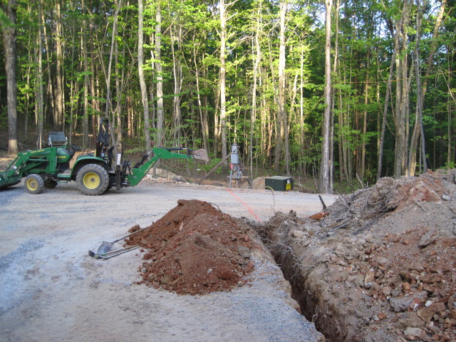

The waterline and pressure tank got installed yesterday. The orange wire runs to a 220V breaker in the electric panel in the basement. Inside the grey conduit is a #10 wire that runs to the well to power the pump. When pressure in the tank gets low enough, a pressure tank switch powers the pump in the well.
We have a freeze protected garden spigot at the well. There is a bed gravel at the base of the spigot. When the valve is closed, water in the pipe drains into the gravel. Before backfilling around the well, I will put some landscaping fabric over the gravel to act as a sort of French drain.
You can see the two waterlines; one is a spare and is capped off at both ends. At the house, there is a tee with a capped off line for a future waterline for the garden.

I worked on backfilling the trench today. I first covered the pipes with a few inches of sand to protect them from rocks. To I placed a piece of landscaping fabric over the stubbed line that will go to the garden. I'm hoping that when I dig this line up later to connect the waterline to the garden that the landscaping fabric will make it easier to uncover the line. I also placed a piece of landscaping fabric over the 3 inch sleeves to minimize silt getting into the sleeves.
