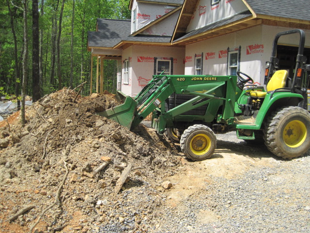

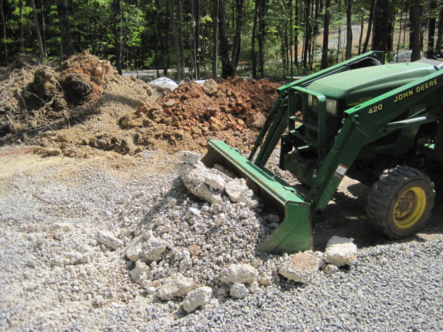

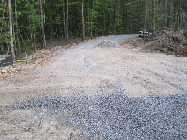

I straighted up the mess below the culvert. Originally I had haphazzardly dumped a bunch of brick and concrete debris below the culvert. It ended up to be a big ugly pile. I really didn't like being able to see the brick and concrete rip-rap right beside the driveway. This week after work I tossed the whole pile, brick by brick, down the gully. I loaded some rocks from the waterline trench and put them below the culvert near the road in a more orderly fashion. I like the looks of the natural rocks as rip-rap much better than the bricks, mortar, and concrete. The bricks, mortar, and concrete are still acting as rip-rap to resist the gully's washing out, but they are now farther away from the driveway and less noticeable.

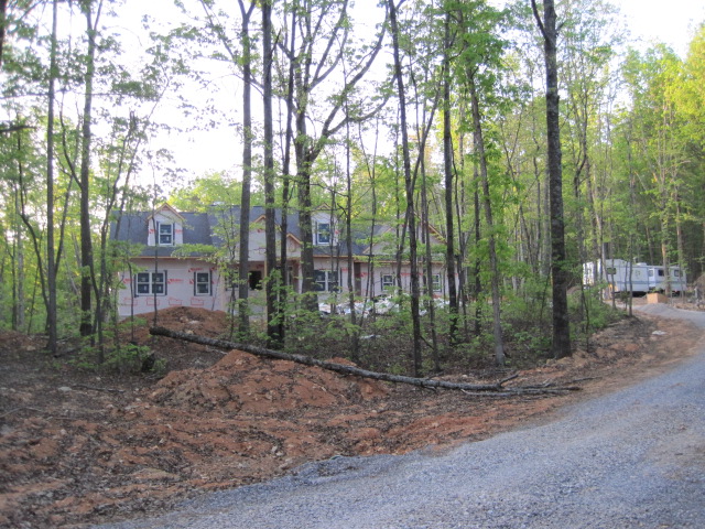

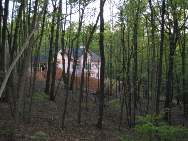

The leaves are getting more colorful each day now.
attachment.php
The weather continues to be incredible, sunny, lows around 40 and highs in the mid-70's. Good weather for digging. We have had very little rain.
