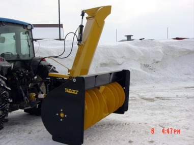

In searching for a new 80 to 82" snow blower, I came upon the Artix from Canada.
I'ts a 3pt bidirectional. You don't need to decide if you you want a backup or a inverted forward pull, it works both ways.
Best of both worlds. Does anyone have experience with or know anything about this blower.
Thanks

You might also look at at the Riest industries single stage rear mounts as they have fewer parts and no impeller fan.
A Reist single stage snow thrower will use 20 percent less power to throw the same amount of snow and they are very well built machines.
With the exchange rate being so good now you would be better off buying a 7 foot single stage unit from the Reist dealer in British Columbia.

Thanks Leon's,
But you have to decide whether you want their inverted or their back up model so you suffer from having the best of both worlds. That's why I'm trying to figure out if the Artix is any good, because you can back into a big pile if you want, or if it's a light snow With only three or 6 inches you can just drive forward and according to the videos I've seen looks like it blows very nicely.
I also researched the Reist, but can't find too many testimonials are much information about whether people like them or not the only thing I can find is that it seems like most people like the two-stage blowers over the single stage.
For some reason it doesn't seem like many people want to make a single stage snowblower and if they're so good I wonder why more people don't make them.
Leonz do you have any experience with the Reist inverted pull behind rear blower.
I have an L 6060 so it seems like there are 3000 series with that big drum would work well on my machine but I have no experience with it at all.

They don't make single stage snow throwers because the market is flooded with 2 stage units and RAD only makes 2 stage units for large mules and small garden tractors.
If you go to youtube and type in reist snow throwers the Reist company has several vidoes and there is a video of a large landscaping company that has 42 kilometers of sidewalks to clear that bought single stage snow blowers from Reist to replace the 2 stage units that were provided with the Steiner tractors they bought because they broke down constantly and the owner really likes the singel stage units he has because he does not have to repair them at all.
They stopped making them for lawn tractors because they needed to be built stronger than the 2 stage junk offered for large and small garden tractors and sub compacts.
I do not have any experience with the Reist blowers but I can and will tell you from using a single stage snow thrower mounted on a 1968 cub cadet tractor that a single stage is the way to go period. I wish I could have bought a single stage snow thrower for the JDLA115 as the two stage blower they have is junk and a maintenance nightmare with a 2 belt drive. I HATE IT and its just more RAD JUNK!!!!!!!!!!!!!!!!!!!!!!!!!!!!!!!!!!!!!!!!!!!!!!!!!!!!!!!!!!!!!!!!
I spent a lot of time describing the Reist snow throwers on another snow thread a few weeks ago and for the money you spend you get much better snow blower that has fewer parts and costs less money. The steel they use is very heavy and the units have full welds like the Pronovost 2 stage units.
As an example and just so you know, a 48 inch series 2000 model is $2,750.00 Canadian dollars as of 3 weeks ago. You are going to save a huge amount of money even with frieght costs to your door from the Reist dealer in British Colombia if you buy one from them.
I am sure if you call Reist that they will give you a list of dealers that have sold them and the buyers of the single stage snow blowers too.
Once you see how they work you will not want a snow caster that has more parts to deal with and you will have almost no spillover when clearing snow.

I talked to Reist. Their 2000 and 3000
Unit are in the $7500 to $8500 range.
He also said it doesn't throw the Snow as far as a two-stage.

around several buildings. So its important to have something i can pull behind so I'm not looking backwards for 90% of the work I do.
Reist wants $10,250.00 for their pull behind #3000 snow thrower and thats stock with no options. I can't find one video of their pull behind in action, so seems a little risky, like you said, once the $10,250 is gone its over. Its not like I"m going to drive it from Idaho to Canada to return it.
I dont mind spending the money, I just only want to do it once and have it work perfect with my Kubota L6060.
Also the Rep. for Reist said that the Hydraulic really isn't totally perfected yet and it really needs super high flow and
if i'm woried about throw distance he certinatly wouldn't suggest hydraulic. He said they mainly use the hydraulic on high flow
skidsteers.
I'm with you, I want something built to the highest standards with as little maintenance as possible and i don't mind paying for it.
I just want to do it once. I want it to last 20 plus years if well maintained. It will be perfectly maintained and operated by yours truly,
so i don't have to worry about it being miss used. Also it will always be stored with the tractor in a heated building.
I'm not trying to argue with you, i'm just trying to show you in words what my conditions are here i Idaho and what daily uses will be.
Now that you know a little more about how I will be using the machine on our property do you have any suggestions of the proper
machine for my particular property and situation.
I can't seem to find anything on the #3000 Reist pull behind.
What would you do if you were in my shoes now that you have a little more info on our needs.
Not trying to bargain shop or save money, just want the very best machine possible for our conditions and property here.
Do our home work once try to buy the best and never be sorry.
This site is great, I have learned so much here. this is the first place I go when i want to learn something about our tractor or attachments.
Thank You for all your help.....
/ Artix snow blower #13
Hello genze
I just found your posting, I will go into this in greater detail for you.
The reason you see the forward scatter of the snow as the mule advances into the snowpack is due to the Series1000, 2000 and 3000 not having a scatter stop shield in the upper center portion of the rotor housing that's all. Installing a scatter stop shield plate would keep the snow from being thrown forward which is something you do not want with a parking lot with cars in it of course.
In saying that a scatter shield that would be long enough to meet the height of the rotor paddles could be installed by Riest with ease with a bit of welding. All that it would require is more steel welded to the rotor housing and then bolting the scatter shield to the roor housing and weldment in the event of a rotor bearing or bearings requiring replacement some time in the future you always want to replace both bearing in any case of a bearing failure as neither bearing floats.
After this is done any forward scatter would be eliminatedor reduced to a bare minimum as the paddles would continue to lift the snow up through the chute and spout..
1
I am going to ask/suggest that you contact Paul Vanderzon; Deneigement Vanderzon | Deneigement Saint-Bruno
The reason I want you to talk to him directly is six fold:
1. he sell Pronovost snow casters
2. he uses Kubota Equipment
3. he uses Pronovost inverted snow casters in contracted snow removal in his business
4. he is a member of the SIMA organization which is all things snow in the United States and Canada
5. The Pronovost inverted and PXPL units have scraper blades to used to pull snow and scrape pavement if desired
Paul is a great guy and he has sold and used Pronovost snow casters for a long time. His phone number is 1-450-653-4675 all times eastern.
Sending you a PM.

/ Artix snow blower
#15
Thanks for the reply.
I ended up ordering a Normand 82 inch inverted pole behind snowblower.
It was just delivered last week to my home in Idaho and I'm very impressed with the build quality and how substantial it is
