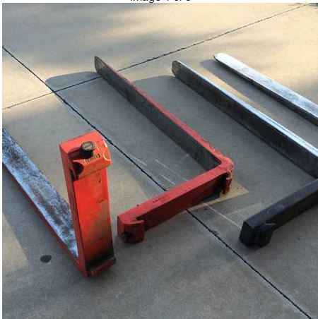

I was thinking of ordering the artillian forks but was wondering if I could save a few bucks by just ordering the frame and getting some used forks locally off of CL. Would they fit? Here's a pic of some available locally, if the attachment works that is. Forks.JPG
