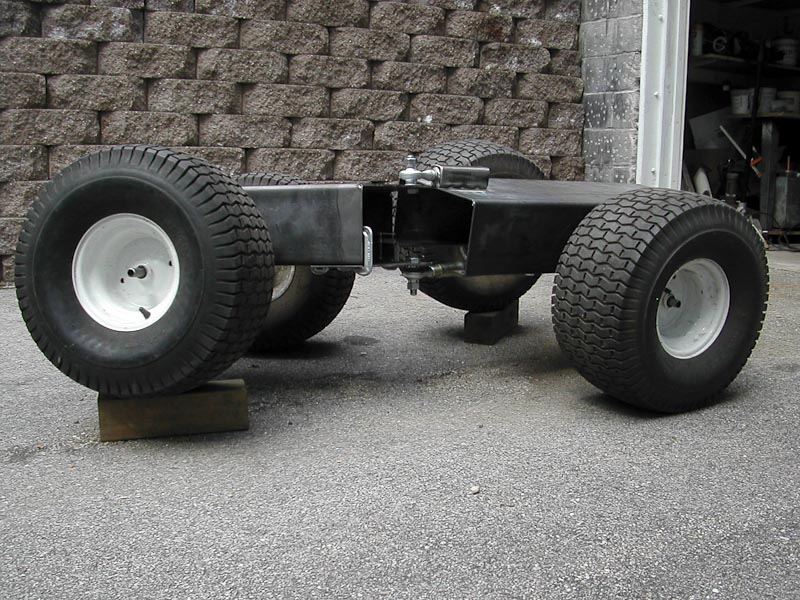

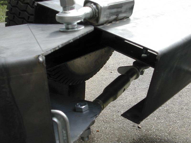

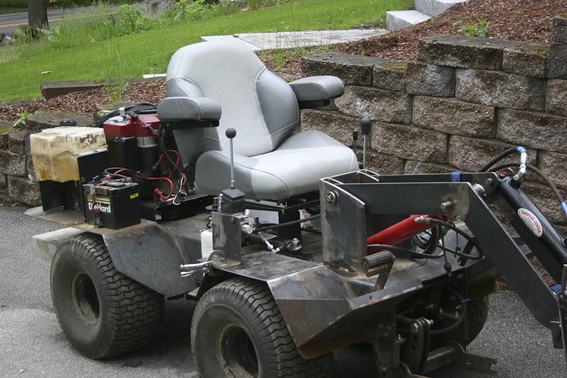

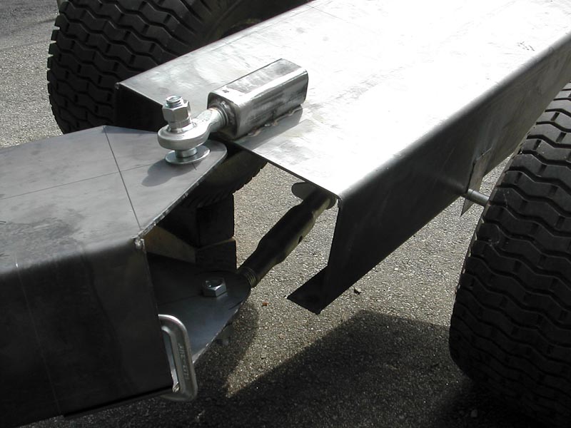

I'm building a utility vehicle that will have articulating center joint for steering. The photos show what I have now, but I don't like the design for the front part that has the downward force on the side of the bearing. I don't think they're really designed to take the load from the side. Any suggestions what I could use that is fairly cost-efficient and is more designed for that type of load. They will probably be about 1000 pounds on the joint at all times.
I'm presently using a Standard 4 Bolt Piloted Flanges Bearing for the front of the joint. That is the right-hand side of the photo.
About your project-
Will the front axle be an oscillating axle? If not you will have mouch more force created and absorbed by the articulating joint and bearings.
A single pin and dual bushing will work best for you as the tapered roller bearings employed for these things do not last very long unfortunately remebering my experience with mining shovels as they do not handle non linear side loading well at all as they are ment for use for low speed rotating
applications in conveyor belts.

The company i work (as a designer) hasnt ever used ball or roller bearings on the center pivots of wheel loaders since the 70's: when an impact is a wee bit more than the bearing can take, the rolling bodies dent the cage, and then they grind at every articulation. Spherical plain bearings are a far better choice, they can take less dynamic load, but are virtually immune for extreme static (=whilst not in motion) impact loads. Because center joint bearings have low slide velocities, the lower dynamic load bearing capacity is not an issue.
SKF - Image
Another benefit is that these are way cheaper than spherical roller bearings. Ball bearings are useless in this application anyways.

Take a page from the build-your-own-backhoe guys, some DOM tubing, some hardened rod, and a few minutes with a welder to weld the tubing into your pivot plates...the DOM tubing will be under $20 a foot, plus shipping. Online metals, ebay, whatever, and a foot should be more than enough. Drill your center section 1/4" NF for a grease fitting. Fasten the pin so it rotates in the lubricated section, not the other way around. If you have access to a lathe, you don't even need the DOM tube, and just about any random chunk of mild steel will work.

Check out the used truck parts wreckyard and take them off a big rig. Thats cheapest, and requires least machining. just have a conical bush lathed, to accept the taper of the steering joint, which you weld to your frame. A 1:20 taper is used often.
Medium sized utility loaders just use bronze bushings on a 1.5 foot long shaft, with thrust washers on top and bottom: they just need to be shimmed out or it will knock every time you lift the bucket.
