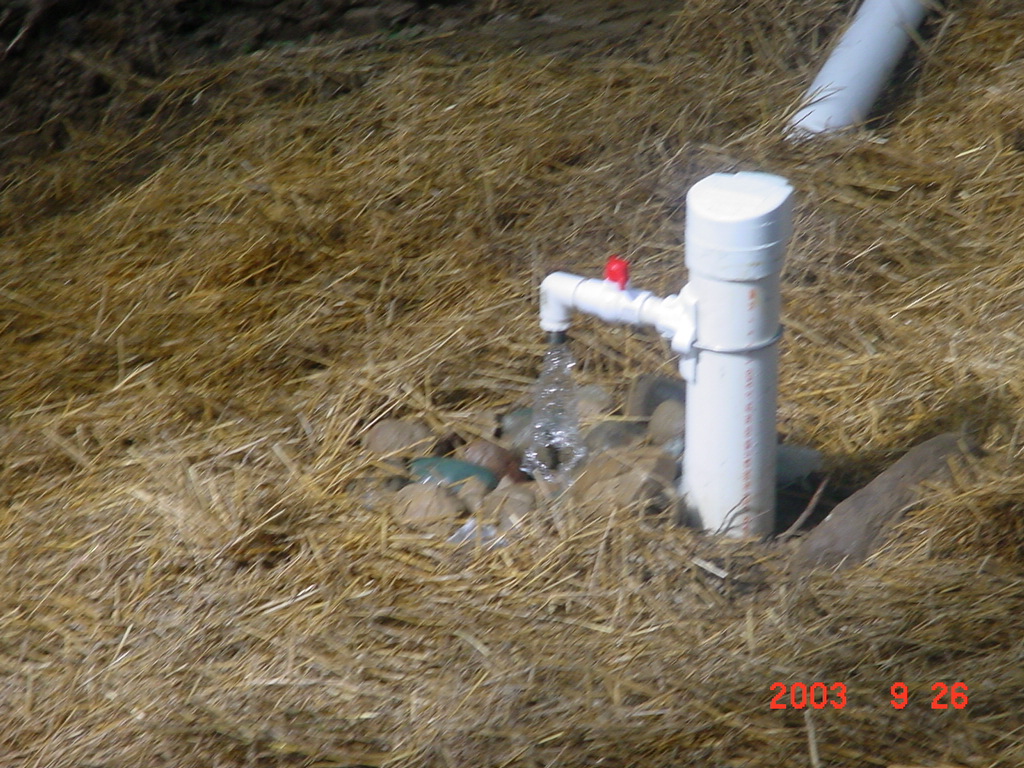

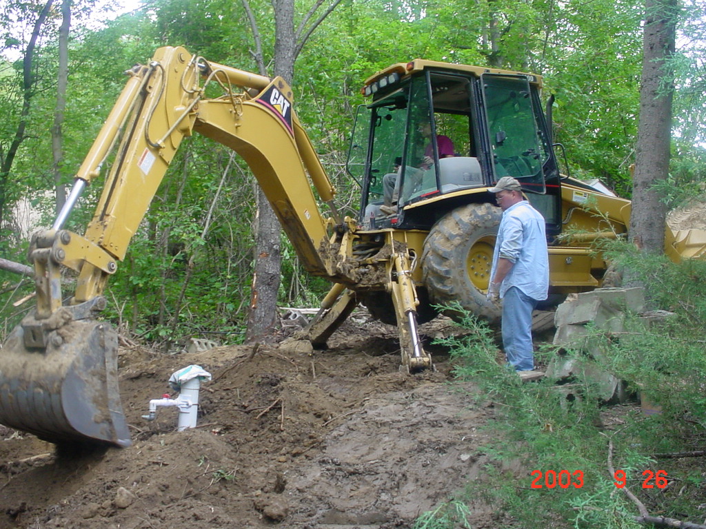

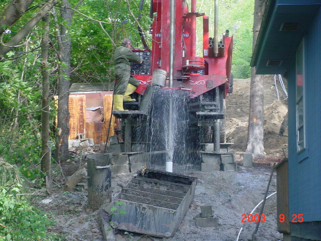

I have never heard of not capping an artesian well. I am in north Fl and have had true flowing artesian wells my whole life on different properties. We have always plumbed them into the the house with no overflow valves and never have had a problem. I am not doubting what some are saying but I would like to know the answer
   / Artesian well - what to do? #25
The big reason not to cap some flowing wells is that the pressure is sometimes great enough that the water finds another way out. Usually up along the casing. Once this happens, you now have no casing to control the amount of flow.
   / Artesian well - what to do? #26
I'm sure that this would not apply to those living in the south. They would not have the same problem that I did. We had to open the valve on the artesian well and let it run all winter so that it would not freeze. Dunning the summer I would shut the valve off.
