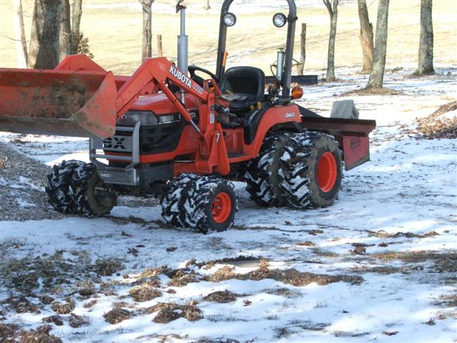

About the duals-
The duals set up would be better if the spacer was between the rears with the wheels mounted at the axle to avoid stressing the axle stub more.
( I am unsure if the casting would tolerate having gussetts welded on them to stiffen the axle stub as a matter of repair later on)

I have a BX 1860 and i definitely find it "tippy". My property is on the foothills of the Shenandoah mountains. So many times I have felt like the tractor is going to tip over.... and many times one or two wheels are off the ground. Not a good feeling!
Perhaps the smallest of the compact tractors are more tippy than the bigger ones? Not sure.
I'm definitely looking into the spacers. Thanks for all the information on this thread.

I use a ballast box so I can remove the weight when mowing or other non-FEL work. I don't need the extra weight when using the roto-tiller or tank sprayer.

The bare BX-style tractor is one of the more stable compact tractors owing to the small tires keeping the weight close to the ground. A "B" sized machine is a bit wider - helps stability - but that's offset by the larger tires and higher ground clearance.
Anything you add in the center or rear that's low to the ground (mower deck, liquid in tires, wheel weights), helps. Anything you add that's high up and/or toward the front (notably a loader with a filled bucket that's raised), makes it more tippy. Adding weight at the front makes it more tippy because it shifts more of the overall weight to the front axle that pivots side-to-side. Wheel spacers help, but getting the weights right also makes a huge difference.
