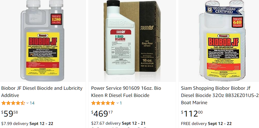

I use Power service white bottle sept-april then switch to power service silver bottle May-Aug. with biobor JF biocide year round. 1.75ml per 5 gallon can my bottle will last me my whole life. The clear diesel from power service is not a biocide, just helps remove water and clean the system. I used a bottle of it but I don't think I will use it again.
I had a tractor gel up on me once but it was in dec and at the time I think I was waiting too long to switch to the white bottle and I probably still had summer fuel in it since I don't use the tractor a lot. I got lucky. I was able to start it back up and get it to the garage before it died completely so I didn't have to deal with the whole tarp and heater thing.
