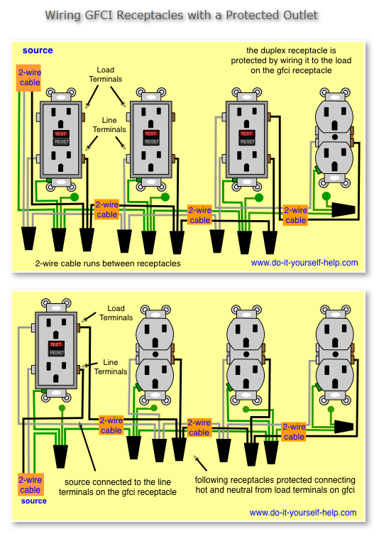

Since we're including GFI breakers in this discussion, what about a circuit that has a GFI and then downstream (farther from the main panel electrically) there is another GFI? I always thought that the first GFI protected the rest of the downstream outlets.
/ ARC Fault Breakers. Your Experiences. #97
I thought they made 2 types of GFCI receptacles, one that protects downstream devices and one that doesn’t. Now I’m not sure if they make ones that don’t. I don’t see any sold on-line that don’t.
/ ARC Fault Breakers. Your Experiences. #98
Pretty sure every one I have seen will protect downstream receptacles. Some of them don't have an outlet on the front, but they all protect downstream receptacles.
Aaron Z
/ ARC Fault Breakers. Your Experiences. #99
See the attached diagram. These two setups both have four ground fault protected receptacles. The first way is more expensive, but it has the advantage of not killing power to the other receptacles if either of the first two upstream GFCIs sense a ground fault and trip. That might be important if, for example, a freezer in a garage is plugged into the downstream receptacle but the upstream receptacle has something plugged in that has a history of tripping the GFCI.
Chris
/ ARC Fault Breakers. Your Experiences. #100
As you can see by the illustration above, the downstream receptacles are ONLY protected when they are connected to the LOAD terminals on the ground fault receptacle. Which MAY or MAY NOT be a good idea, depending on what you are trying to do. The freezer analogy was a good example of that.
