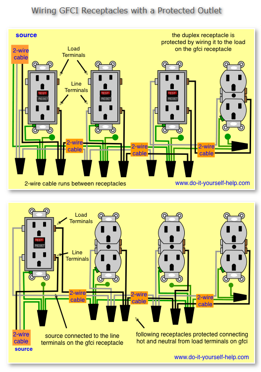

See the attached diagram. These two setups both have four ground fault protected receptacles. The first way is more expensive, but it has the advantage of not killing power to the other receptacles if either of the first two upstream GFCIs sense a ground fault and trip. That might be important if, for example, a freezer in a garage is plugged into the downstream receptacle but the upstream receptacle has something plugged in that has a history of tripping the GFCI.
Chris
Interesting, now I wonder which version I have. I'll have to go test it.
