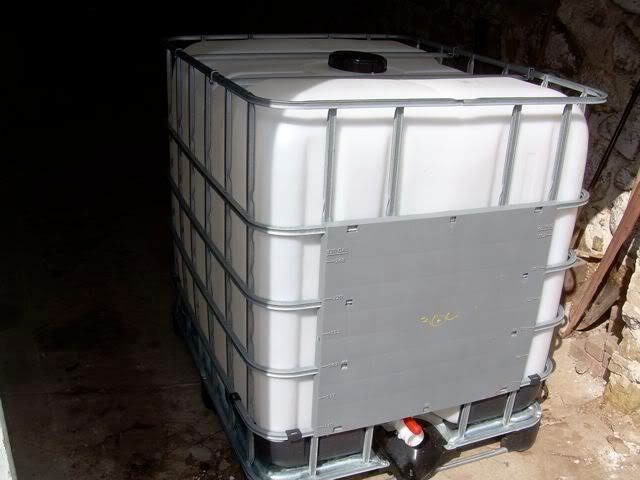

The snow has finally melted here in southern Wisconsin. Boy, winter was hard on our trees, we have white cedar, white pine, blue spruce, black spruce, quaking aspen, swamp white oak, red oak, silver maple and tamarack, about three thousand, which we have planted over the last four years. Many of the pines and cedars were bent flat to the ground by the snow , putting a 90 degree kink in the trunk (praying they bounce back), while the hardwoods turned into browse for the moles. That of course is my fault, for letting the grass grow up around the trees in order to hide them from the deer, not realizing I had created a perfect habitat for the moles. I am a proud undergraduate of the School of Hard Knocks :rolleyes:
So this year, instead of planting more we will be focusing on what we have, and that means lots more spraying, mowing and watering (unless our summer turns out like our winter, in which case everything will likely drown and then we can start from scratch). Here's a pic of my new 300 gallon watering can:
