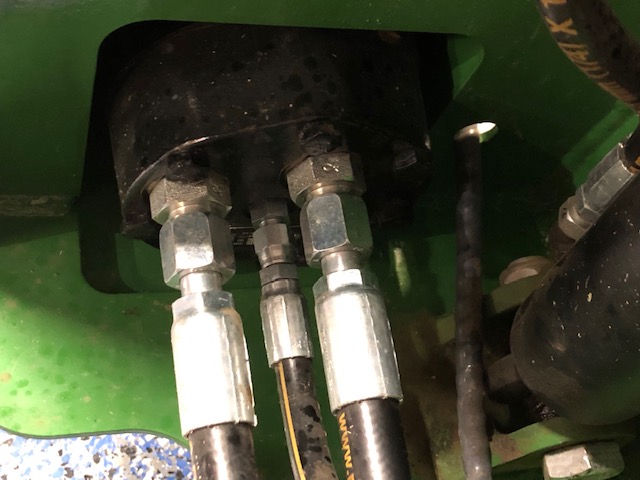

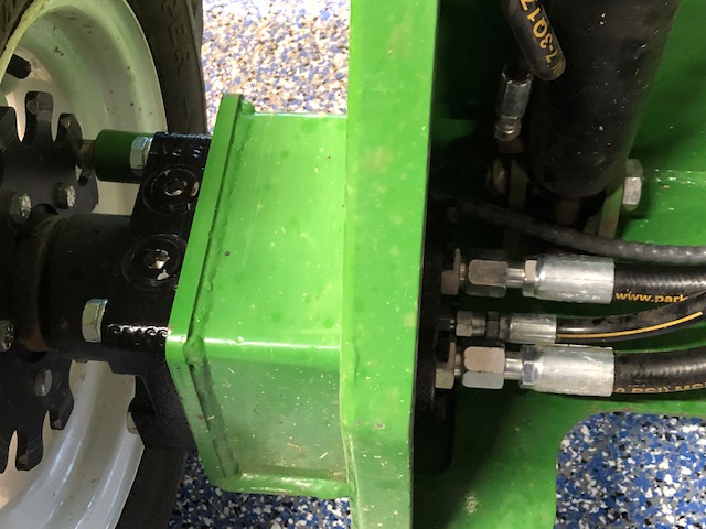

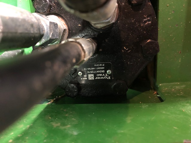

   / Anyone with the new 425... #35
Here you go.
I'm not convinced this wheel motor is the White CE 14.3 that folks on here generally refer to as the "larger wheel motors" (compared to 15-20 year old 425's). The back doesn't say Roller Stator, the bolts are not recessed, and obviously it now is end ported either by the manufacturer or by powertrac.
Curious what your thoughts are.
#36
Thank you for the pictures. Yes, this is a somewhat unique motor for a PT. It's using a square mount but with holes capped for the hydraulic ports. Also, it appears there's a number ending in "CE" on the motor mount? I assume it's still a tapered shaft. The end porting is an option for some Danfoss (White) motors. Because the end cap has cast lettering, this is not a PT fabricated end cap. It also looks like it may have medium duty bearings. I'm convinced this motor has been spec'd by PT. My only question...is this a custom OEM assembly (i.e., not readily available for retail purchase) or can we find the exact specification. So far, I've not found a way to spec this exact motor on Danfoss's website.

   / Anyone with the new 425... #37
I haven't been able to find any pictures of wheel motors like this either but there's a ton of 'em. No "CE" markings that I could see. There were these stamped numbers but they didn't lead me to any particular motor.
35713
4474544 - Google reveals that this is a patent # assigned to White Hydraulics
6321
One day I'll just call up PT and ask them. Mostly I was curious where it sat in the power spectrum.

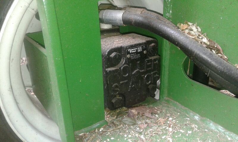

   / Anyone with the new 425... #38
Here you go.
View attachment 619334View attachment 619335View attachment 619336
While we are somewhat on the subject and I just want to learn about these, what does the Roller Stator signify?
   / Anyone with the new 425... #39
I think this might explain it better than my words...
#40
As far as I know, this is a brand name. It's probably a play on words from the electric motor world (Rotor/Stator). This motor is likely a gerotor design which is common for small high torque, low speed motors.
