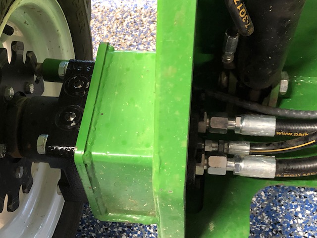

I hate to keep asking for more pictures, but could you take a picture of the back of one of the front wheel motors where the hoses connect? I'm curious to see if this connection point is an option offered by the wheel motor manufacturer, or is a modification made by Power-Trac (which I suspect).

Here you go.
I'm not convinced this wheel motor is the White CE 14.3 that folks on here generally refer to as the "larger wheel motors" (compared to 15-20 year old 425's). The back doesn't say Roller Stator, the bolts are not recessed, and obviously it now is end ported either by the manufacturer or by powertrac.
Curious what your thoughts are.

Thank you for the pictures. Yes, this is a somewhat unique motor for a PT. It's using a square mount but with holes capped for the hydraulic ports. Also, it appears there's a number ending in "CE" on the motor mount? I assume it's still a tapered shaft. The end porting is an option for some Danfoss (White) motors. Because the end cap has cast lettering, this is not a PT fabricated end cap. It also looks like it may have medium duty bearings. I'm convinced this motor has been spec'd by PT. My only question...is this a custom OEM assembly (i.e., not readily available for retail purchase) or can we find the exact specification. So far, I've not found a way to spec this exact motor on Danfoss's website.
I notice the parking brake plate is now bolted on. Not sure why but it can be removed if not needed...and to stop the "clicking" from the pin rubbing. I redesigned my parking brake (actually, a friend did) and it's much better now. I need to post some pictures.
I'm always trying to figure this stuff out not because I don't like paying PT's high prices on parts. Personally, I've got no problem with their pricing because it comes with free tech support from Terry (plus, if you think their prices are high, try buying some stuff for a Bobcat or Takeuchi). I want to know what's in these machines because I'm curious. Plus, if I want to upgrade something (like I recently upgraded my 14.2 cu. in. wheel motors to 22.8 cu. in.), then PT doesn't offer this option and I need to know what to order. In addition, there's no guarantee PT will be around forever and, since they mostly use off the shelf parts, I want to know what's in my machine.

I haven't been able to find any pictures of wheel motors like this either but there's a ton of 'em. No "CE" markings that I could see. There were these stamped numbers but they didn't lead me to any particular motor.
35713
4474544 - Google reveals that this is a patent # assigned to White Hydraulics
6321
One day I'll just call up PT and ask them. Mostly I was curious where it sat in the power spectrum.

While we are somewhat on the subject and I just want to learn about these, what does the Roller Stator signify?

As far as I know, this is a brand name. It's probably a play on words from the electric motor world (Rotor/Stator). This motor is likely a gerotor design which is common for small high torque, low speed motors.
For even more torque, the next step might be a fixed displacement piston motor. And for even more torque, add a planetary gear set. For example, a tracked machine will often use a hydraulic motor coupled with a planetary gear set to drive the tracks.
