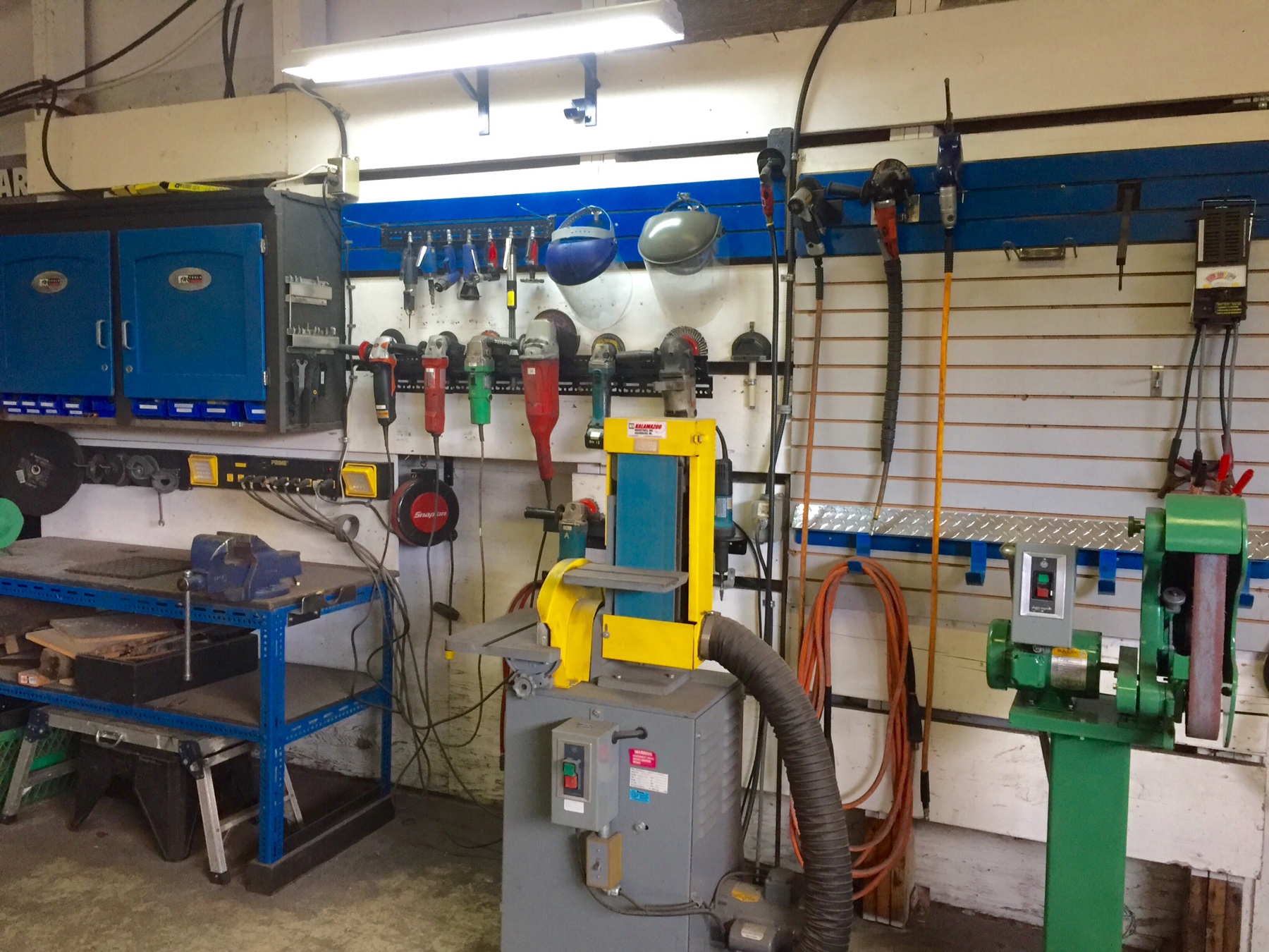

I like belt sanders. There aint much you can do on a bench/pedestal grinder that cant be done on a belt.
Belt sander is my go-to for drill bit sharpening as well as rounding corners off on metal etc.
6x36 works nice.

^^^ X2 on the belt grinder. ^^^
When I have a bunch of drill bits to sharpen I'll re-read the directions for the Drill Doctor and use it but I'll most often touch up a bit I need on the belt.

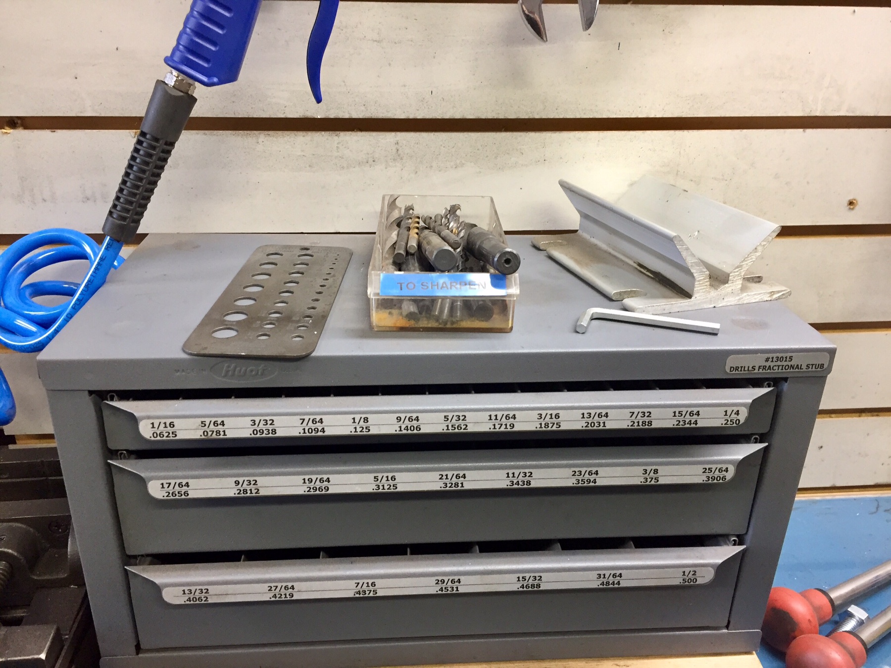

That is a sweet looking sander! Also like your drill bit drawer. No way I could fill that up even close but it would be nice to be organized that way.
Got one of those too. Every industrial setting I have been in used the same thing.
I have yet to come up with a better way to organize bits. Its a "Huot" brand drill organizer. Usually run ~$60-$70 online

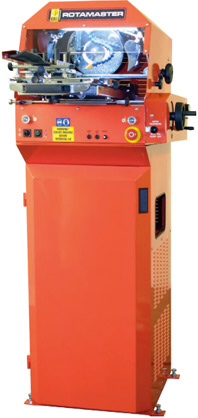

Yes, the belt grinder is great for mower blades for the reasons you mentioned. The proper way to grind a blade though is with a jig on a wheel grinder or a specialized mower blade grinder. The grinding wheel achieves a hollow (concave) profile which creates a longer lasting "edge".
The worst way to sharpen mower blades is to clamp it in the vice and use an angle grinder. The result will be a razor sharp (convex) cutting edge that will immediately start to dull when used.
Here's a Google image of the Rotomaster blade grinder I sold when I retired.
Probably TMI. Sorry
