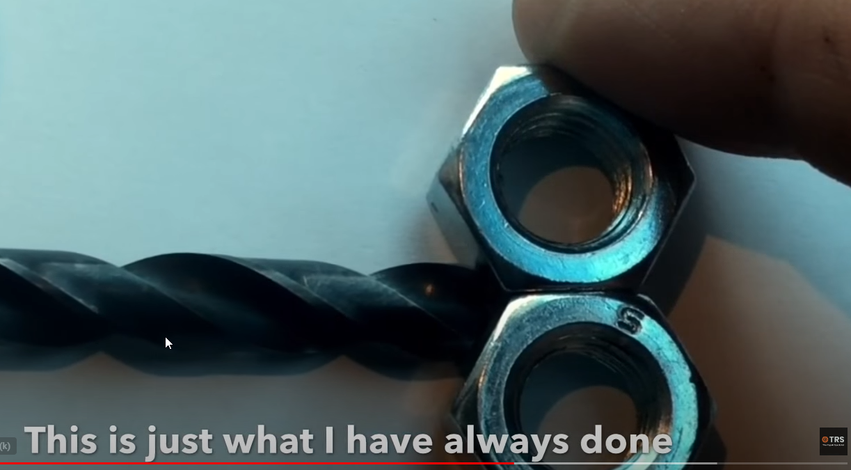

Anyone ever free hand sharpen pilot point cobalt drill bits? If so how? Should I just grind what's left of the point off and try and sharpen it like a regular bit?
