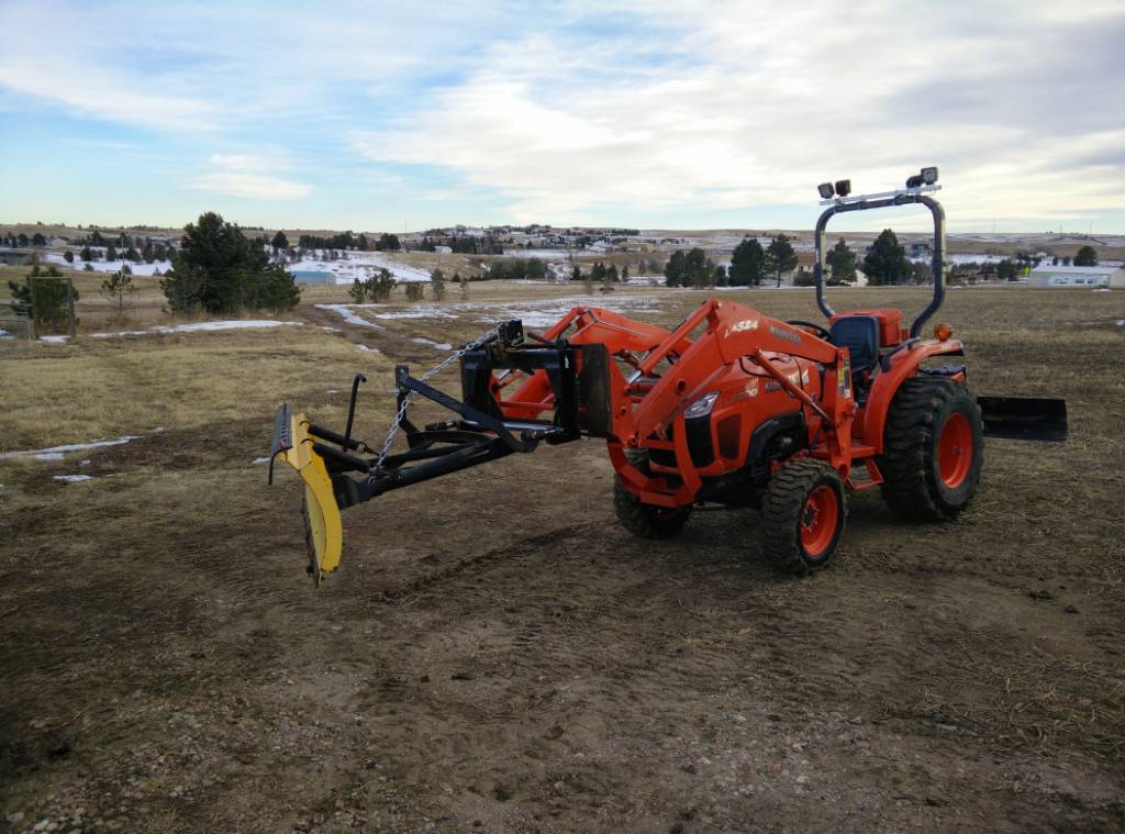

Gauge wheels may be better than shoes, but not enough. We get a lot of freeze that cycles here & that means mud. Lots of soft ground & mud. Setting my shoes an inch below the blade is sometimes not enough to stop from plowing mud.
The extra weight of the whole loader driving the plow into the ground sinks the shoes & plow. My old plow on the old tractor had float on the mount. Because of that & the light weight of the plow it did a bit better at not plowing mud than my current plow, even without shoes. The light weight meant it wasnt nearly as good cutting drifts or scraping things clean though. It's all tradeoffs. It was also further out than my new plow so would push the machine sideways harder.
View attachment 596930View attachment 596931
I only have this to deal with in the early fall and late spring...but everyone with grass and/or gravel has it to greater or lesser degree.
What if under the QA plate we added a roller instead of gage wheels? It would be about 40" long and say 8" in diameter. I used a slit 3 1/2' pipe on my plow edge this year and it reduced gouging considerably but at the cost of reduced scraping. I can live with leaving an inch of snow during the beginning (need to build a base anyway) or end (it will melt soon) of the snow season.
Comments from anyone would be welcomed.

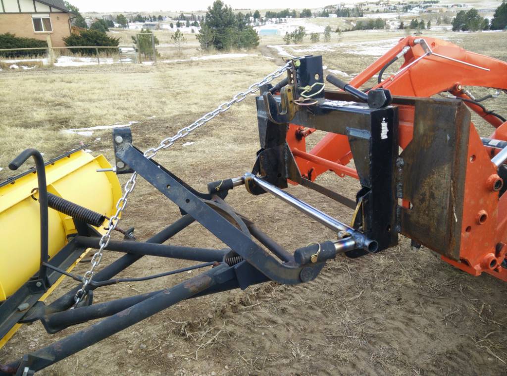

Good picture!!!
If the casters are mounted on the QA plate, they are behind the angling cylinders. I think that addresses the point in npalen's post about angling the blade. Curling the blade to adjust cutting action is moot...cannot do that with a truck plow and it works...but if the blade is curled down, the casters will be higher than the blade anyway.
Curling the blade to adjust cutting action would be in reference to MossRoad's post where he mentions:
"The only suggestion I have, as it pertains to my experience with my setup, is that I have gauge wheels behind my plow blade. I can dump the plow forward to scrape right against the asphalt if I want, or I can curl the plow back a bit, so it rides on the wheels and doesn't touch the ground in areas with gravel, grass, dirt, etc... and not dig up the ground. It makes a world of difference, "
I agree that you wouldn't want to curl the blade down too much as the gauge wheels would no longer be effective. Angling the blade sideways and then adjusting the curl BACK would tend to cause the trailing edge of the blade to want to gouge. That's where I was wondering if there is enough slack in the pivot(s) to prevent gouging. Seems like the gauge wheels would help prevent that.

My casters have 5 spacers for height adjustment. At the start of the year, I adjust it for the sweet spot, where the blade in the straight position, it is perpendicular to the driveway up and down, and the wheels are on the ground. Then I install the correct number of spacers above and below the caster pin. At that point, the blade will angle left and right on the wheels while maintaining the same level to the driveway. If I curl the plow back enough for the blade to come off the ground and inch, and then angle the plow left and right, the blade will still clear the ground by about 3/4" on either full angle stroke. From there, you just gotta play it by ear and adjust the spacers as needed until you find the best position for you that gives you the maximum angling without gouging. Once you get it set, the spacers stay in the same space all season.

Good picture!!!
I too like the look of MossRoad's setup. Keeping the blade close to the front looks like it tends to minimize side draft when plowing with the blade angled. Is that a PowerTrac blade?
Yes. It cost a whopping $450 new back in 2001. :laughing:
It was well worth it. :thumbsup:
