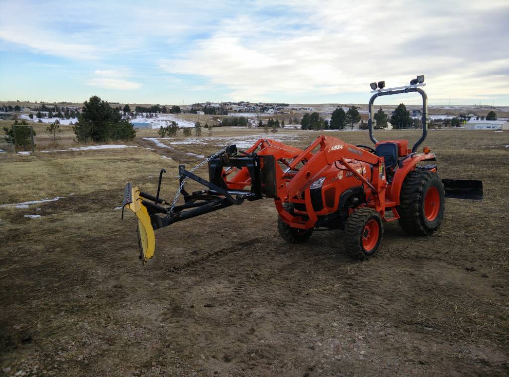

A SSQA blade isnt that different than a truck plow in most respects. So if a truck currently gets the job done a SSQA probably will as well.
Most SSQA plows dont have float. I'm about to rebuild my SSQA plow frame to put float on it. Float on the loader arms doesnt work as it puts to much weight on the plow. No different than digging with a bucket in float. Plowing mud & gravel is as big issue for me, but was an issue with my old L3200 with a home built plow that had float as well. I was somewhat expecting to have to build float into my new plow when I got it.
Tractors have a lot less power & speed than a truck. Snow doesnt curl off to the side as far. My L4060 does fine in a foot of snow or up to 2' of light snow. Things melt off fast in Colorado so berms on the side arent an issue.

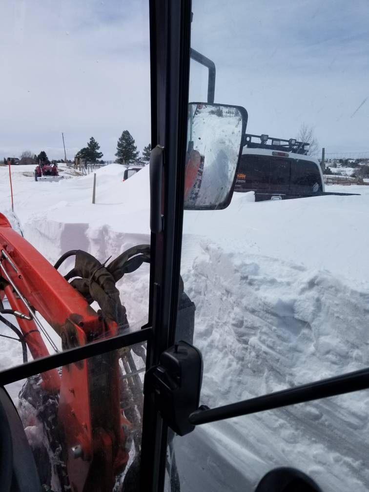

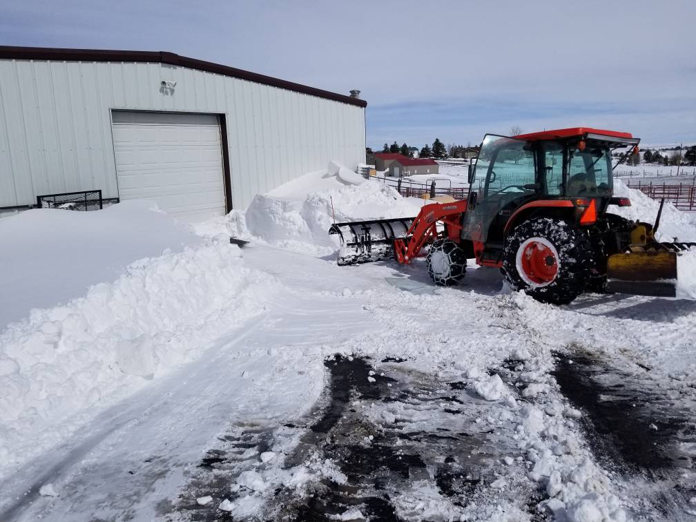

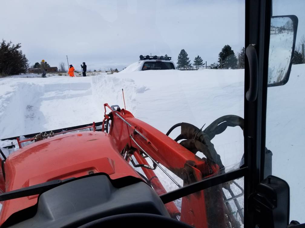

With a SSQA plow you can grab drifts & back drag a few feet at a time. Probably about as efficient as using a bucket. The photos below show progress I made using this technique on heavy packed drifts from the bomb cyclone in Colorado last week. That light bar belongs to a F350 with over a 12" lift & matching tires.

That's why gauge wheels are so nice on a plow. You CAN put the loader in float and the plow won't touch the drive and won't dig in.

Gauge wheels may be better than shoes, but not enough. We get a lot of freeze that cycles here & that means mud. Lots of soft ground & mud. Setting my shoes an inch below the blade is sometimes not enough to stop from plowing mud.
The extra weight of the whole loader driving the plow into the ground sinks the shoes & plow. My old plow on the old tractor had float on the mount. Because of that & the light weight of the plow it did a bit better at not plowing mud than my current plow, even without shoes. The light weight meant it wasnt nearly as good cutting drifts or scraping things clean though. It's all tradeoffs. It was also further out than my new plow so would push the machine sideways harder.

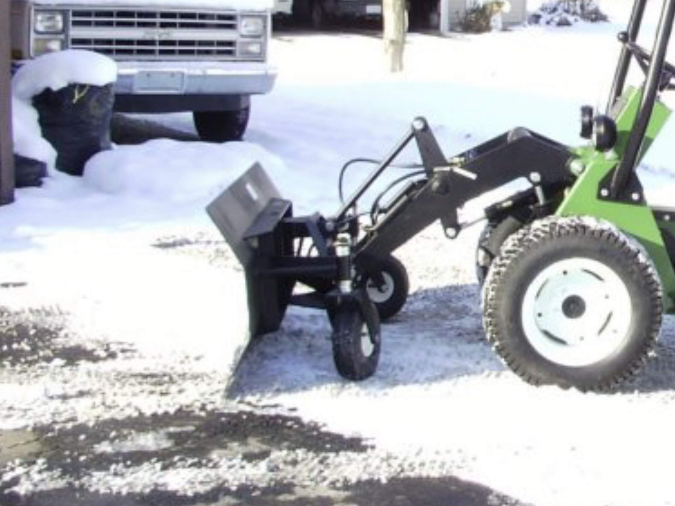

My gauge wheels are casters on the back of the blade. My power angle cylinder is right behind the blade, parallel to the blade. My blade is probably less than a foot from my QA mount.
Here's a picture from 2001.
Good picture!!!
If the casters are mounted on the QA plate, they are behind the angling cylinders. I think that addresses the point in npalen's post about angling the blade. Curling the blade to adjust cutting action is moot...cannot do that with a truck plow and it works...but if the blade is curled down, the casters will be higher than the blade anyway.
