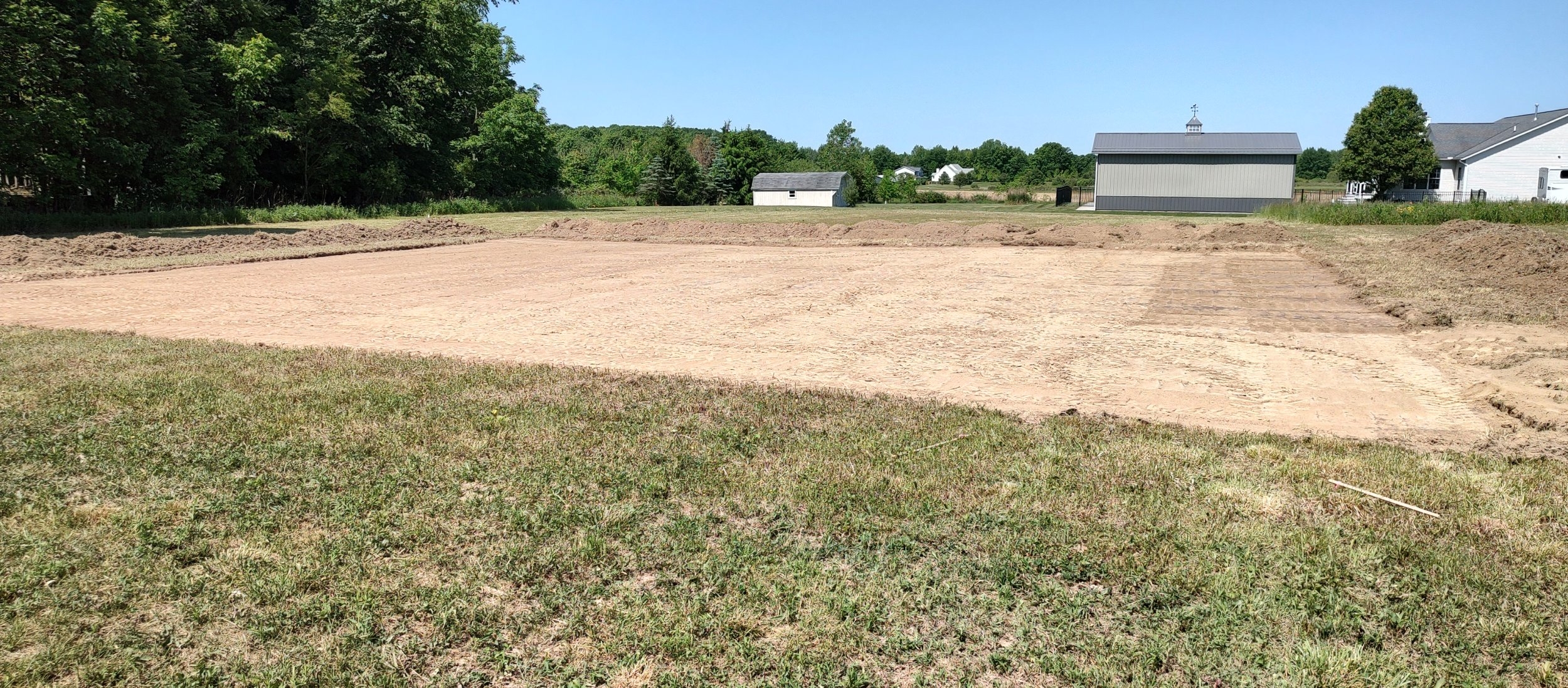

Here is a barn pads I stripped back on may 31....bought 2.5 weeks into a drought.
