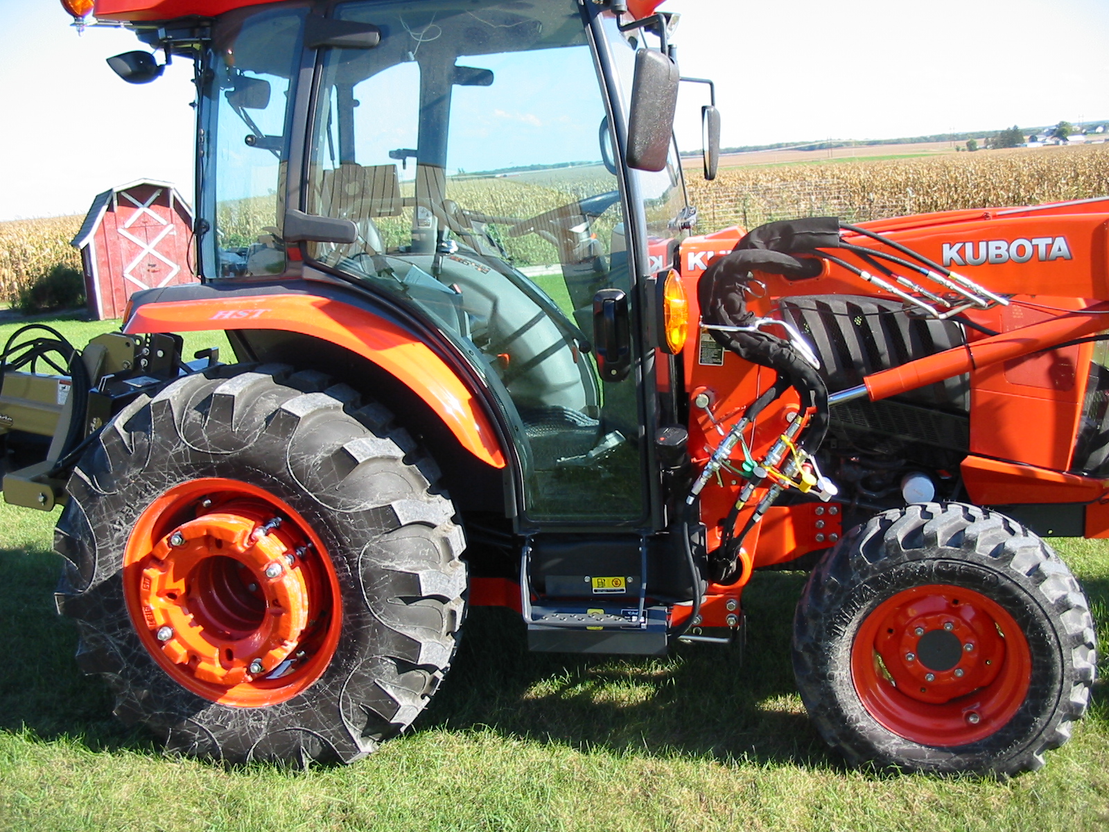

How heavy are your wheel eights? I have two sets a side as well, but yours stick out more; dealer said I could only use three each side, but I don't need it.
/ Anyone Own A L6060? #28
The Kubota weights are 106 Lbs. each + bolts.
I have two on each side as well and plan to add a third to each side because a third will extend only slightly beyond the rim.

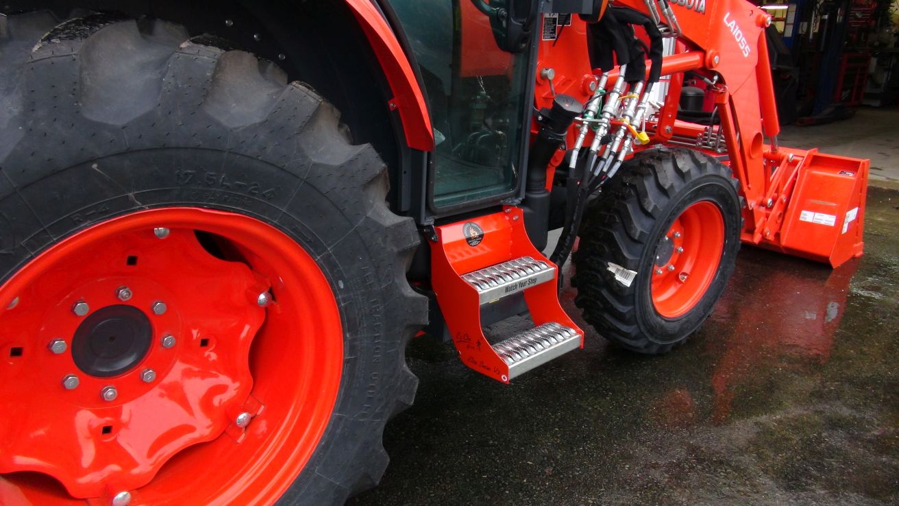

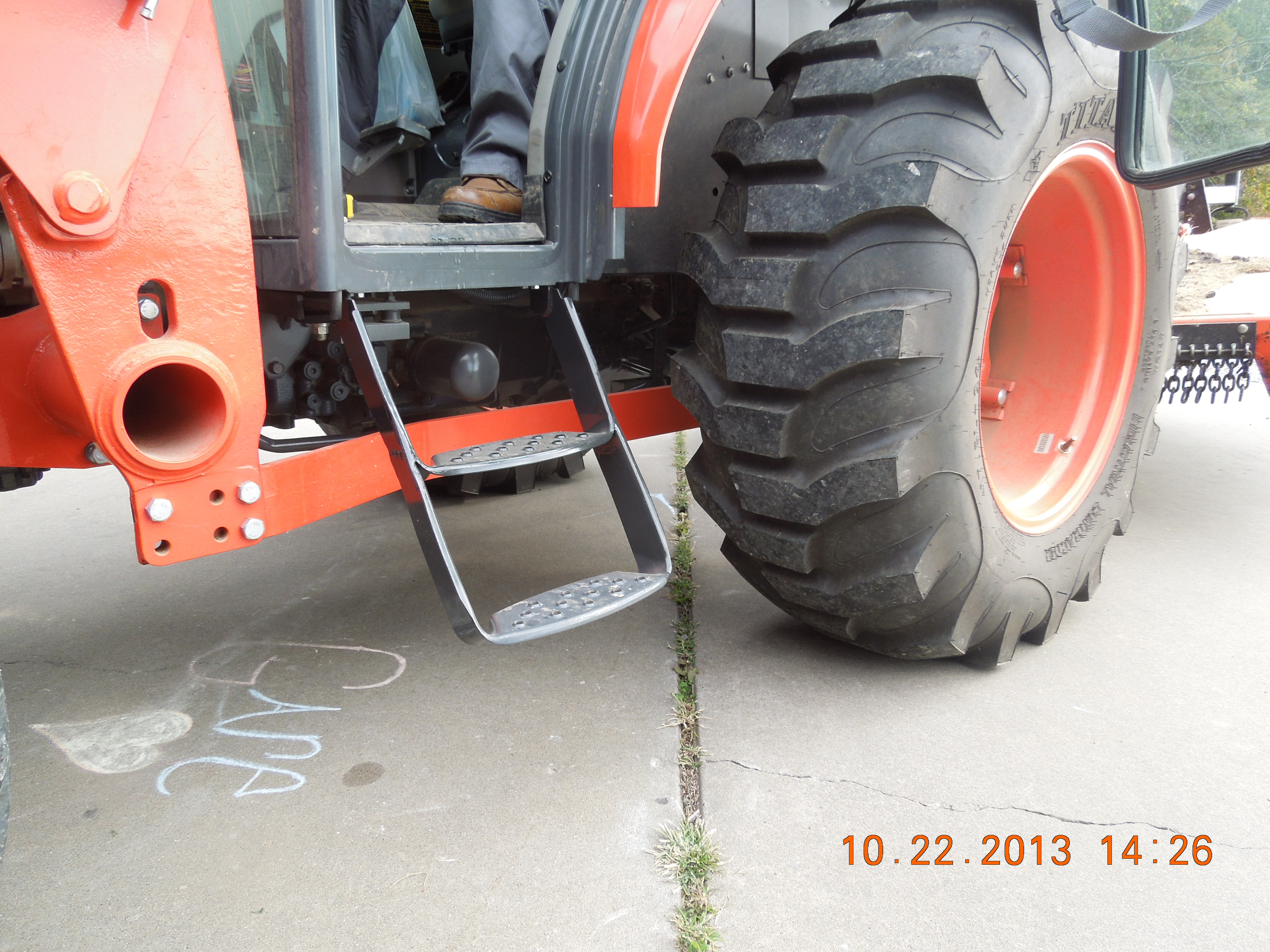

Here are the steps I got.

Do you find the steps on the right side useful? After 55 years of driving tractors I don’t ever remember getting out on the right side.
/ Anyone Own A L6060? #31
The only time I use the right side is if I can't get out the left, but my son uses whichever is closest. We have a bit over 150 acres of woods and quite a few washouts.

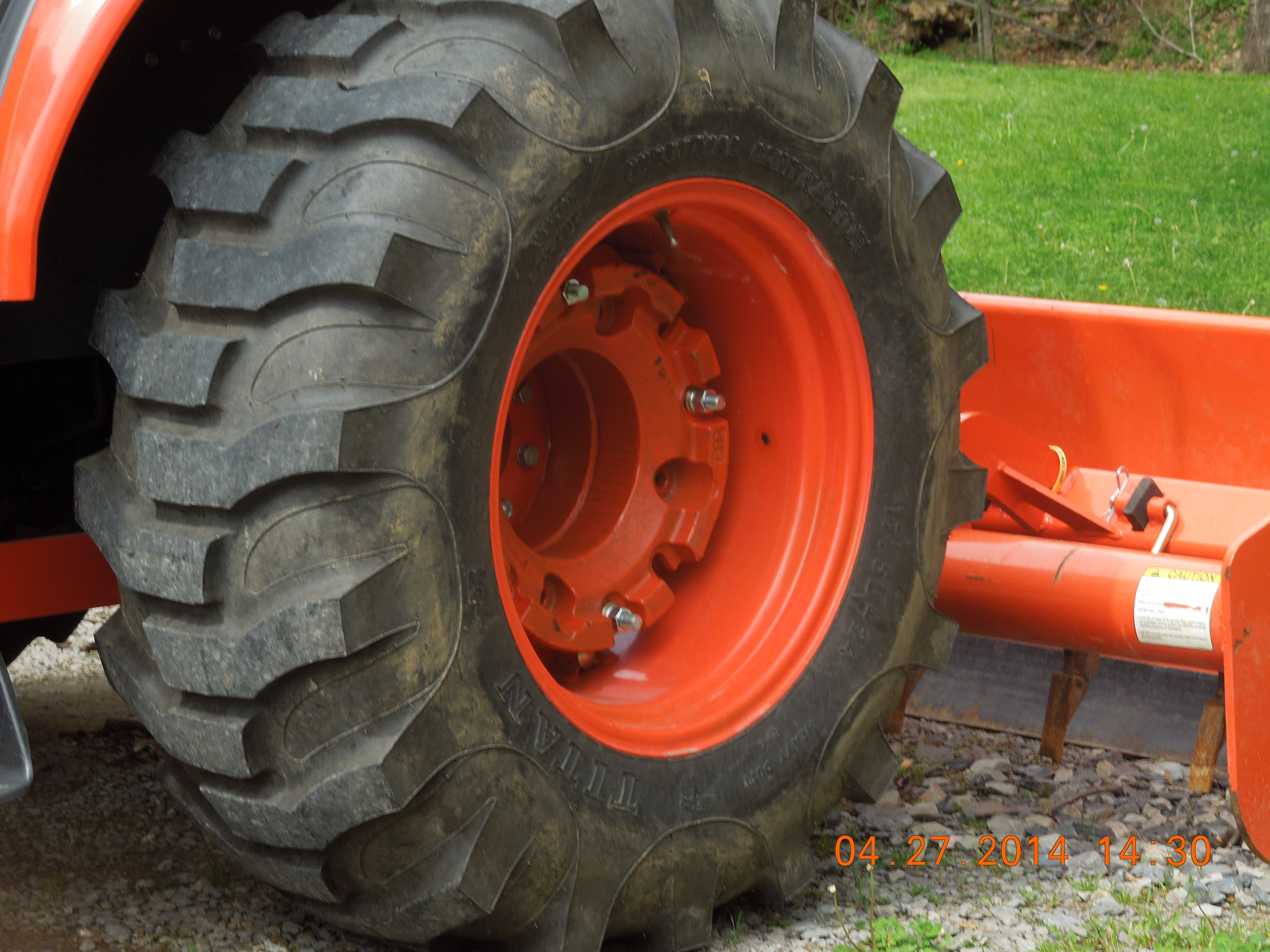

Here is what they replaced.
