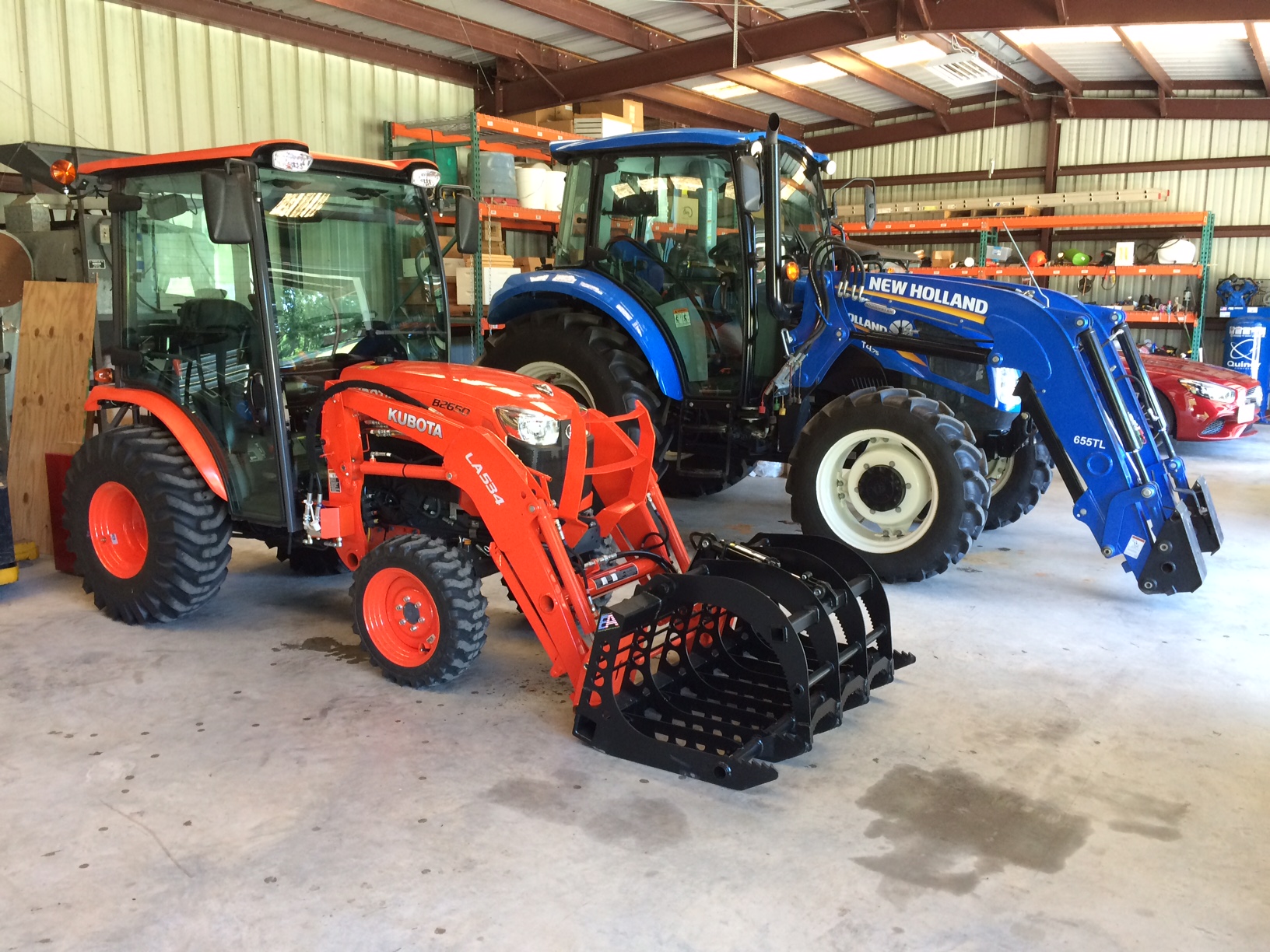

Yes, We are flat to rolling land here on the Texas Gulf Coast. Really like the B2650 and have the rear wheels water filled and a mid mount mower underneath so no tipping for me so far. Also, When I had the mid mount mower installed I had to change from R4 tires to turf tires and their stance is wider.
Yes, the cab is really small, almost like being in a telephone booth. It feels super tiny if I have previously used my T4.75 which has a huge cab with two seats. One for the driver and a small one for a passenger.
My only complaint is that out of 20-25 tractors I have worked over the years the hydrostatic drive on the B2650 is much louder than even much larger tractors and I do not know why. I have terrible hearing and am very protective of what hearing I have left so I wear shooting muffs while driving. My younger brother who lives 200 yards from my barn teases me that he can always hear the hydro whine on the B2650 and knows I am going out to mow in the orchard....
