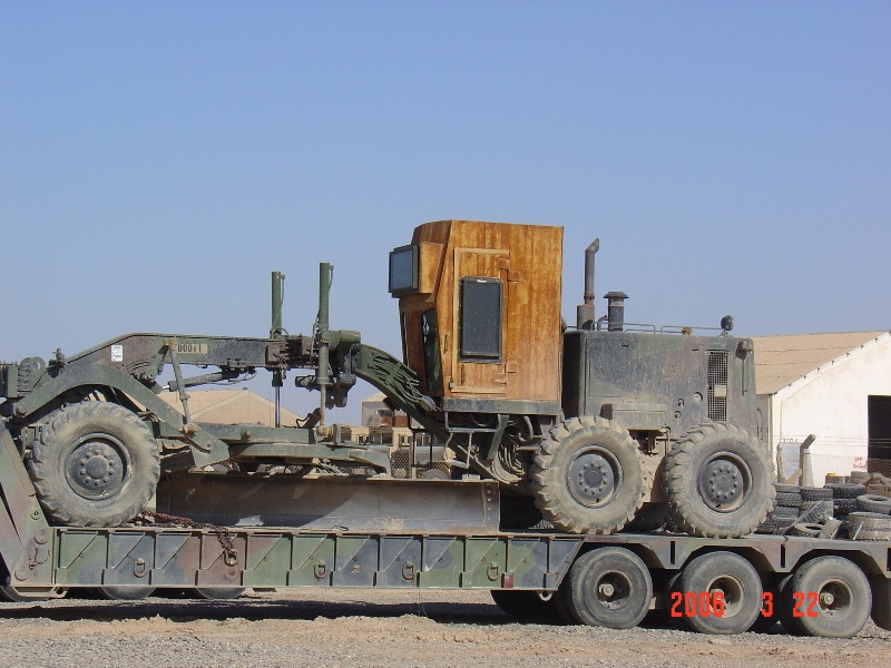

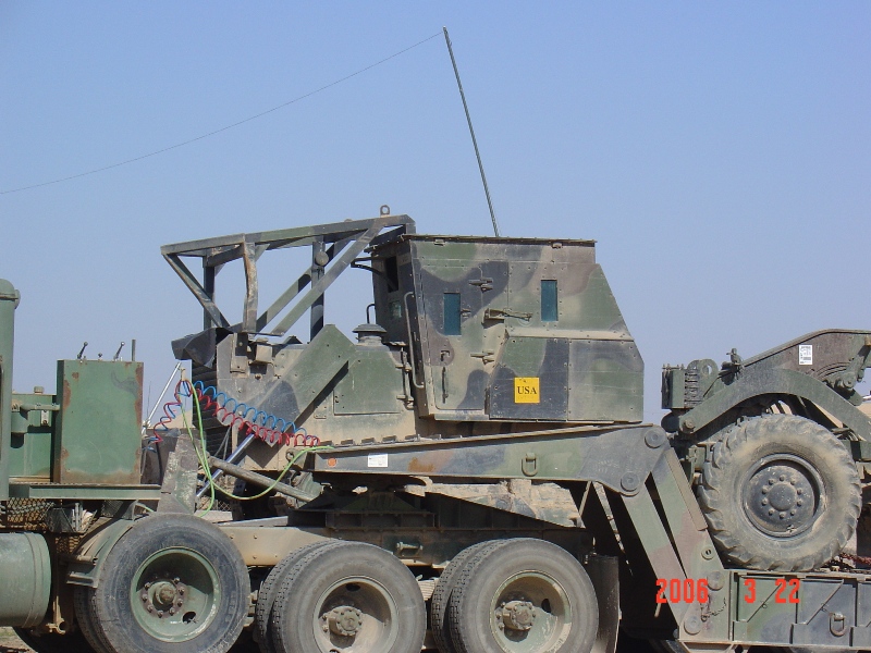

You might have an appreciation for this. Crappy pictures, but hopefully you can get the idea. Took these pics at Tikrit Iraq in 2006. Engineers were having troubles with Snipers. You better have a good "natural feel" for blade position cause the view of it sucks. :)
/ Anyone here have bulldozer experience? #78
But then don’t you ALWAYS use the Braille method for grading, Richard??
I can’t tell on my phone. In the first pic is that something on the gooseneck or something in the background?
/ Anyone here have bulldozer experience? #79
Thanks for posting Richard. Brings a whole new meaning into grading by feel. God bless our troops.
