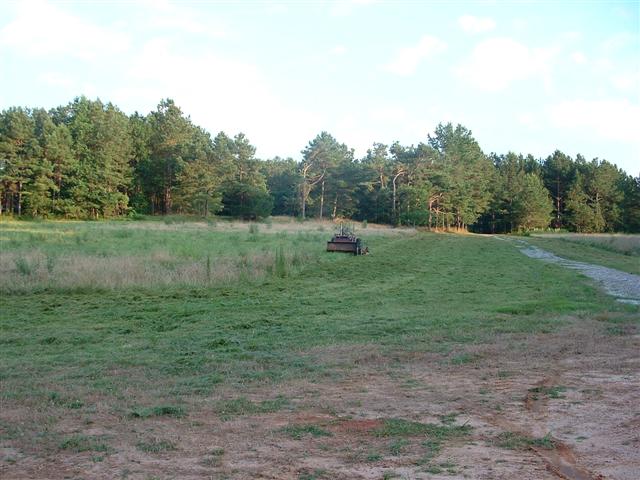

a ditch made with a rear blade? I want to have a ditch along side of my driveway to redirect water that sheds off of the pasture. I want to do about 250yds of ditch beside the gravel drive. I have a Case 485 and a bud offered to let me borrow his heavy duty rear blade. He suggested tilting the blade and maybe making a "V" shape ditch.
If you have any pics I would love to see em'.
If my pic works you will see my driveway.The pic is taken from my front porch. Starting on the far end I want to put the ditch along side the drive until it gets mabe 150ft from the house and curve it around the house (acually around the yard). This should help redirect the shed water from the pasture and send it down toward the lake. If I don't do something like this when I do actually get a yard established it would be ruined from a really heavy rain.
thanks,Keith

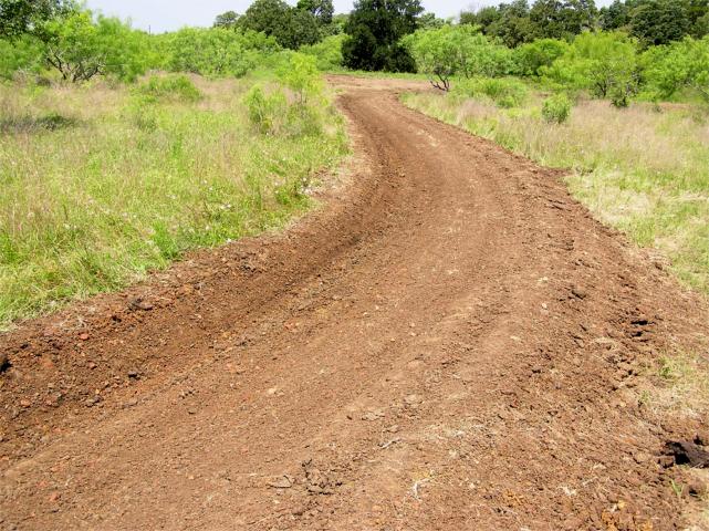

wksinatl, here is a picture of a water diverting ditch that I made with a box blade tilted. You should get the same effect with a blade. I only did half a "V". The water is diverted into a pond on the upper right of the picture just out of view. I cut down about 8" and raised the soil on the other side about 8". There was a big rain about a week ago and it held up well. It took about three hours. I have top and tilt and was able to tilt the blade at each turn so I could cut driving up and down the hill.

I hate to say it, but you kind of need a higher roadbed under your driveway. It looks like the driveway is lower than the surrounding areas from that picture. Maybe you have a quarry nearby that can bring in some rock for you cheaply?
/ anyone have pics of.......
#9
twstanley,
good eye. Yes the drive needs more gravel. Yes, I can get more delivered, but "cheaply"? I WISH!!!
thanks,
Keith

It's hard to tell from the picture, but it looks like there might be a little rise about halfway down your driveway?
You probably need to shoot the grade so you'll know how deep the ditch needs to be throughout. With 250 yds you'll be amazed at the amount of dirt you'll have to move.
