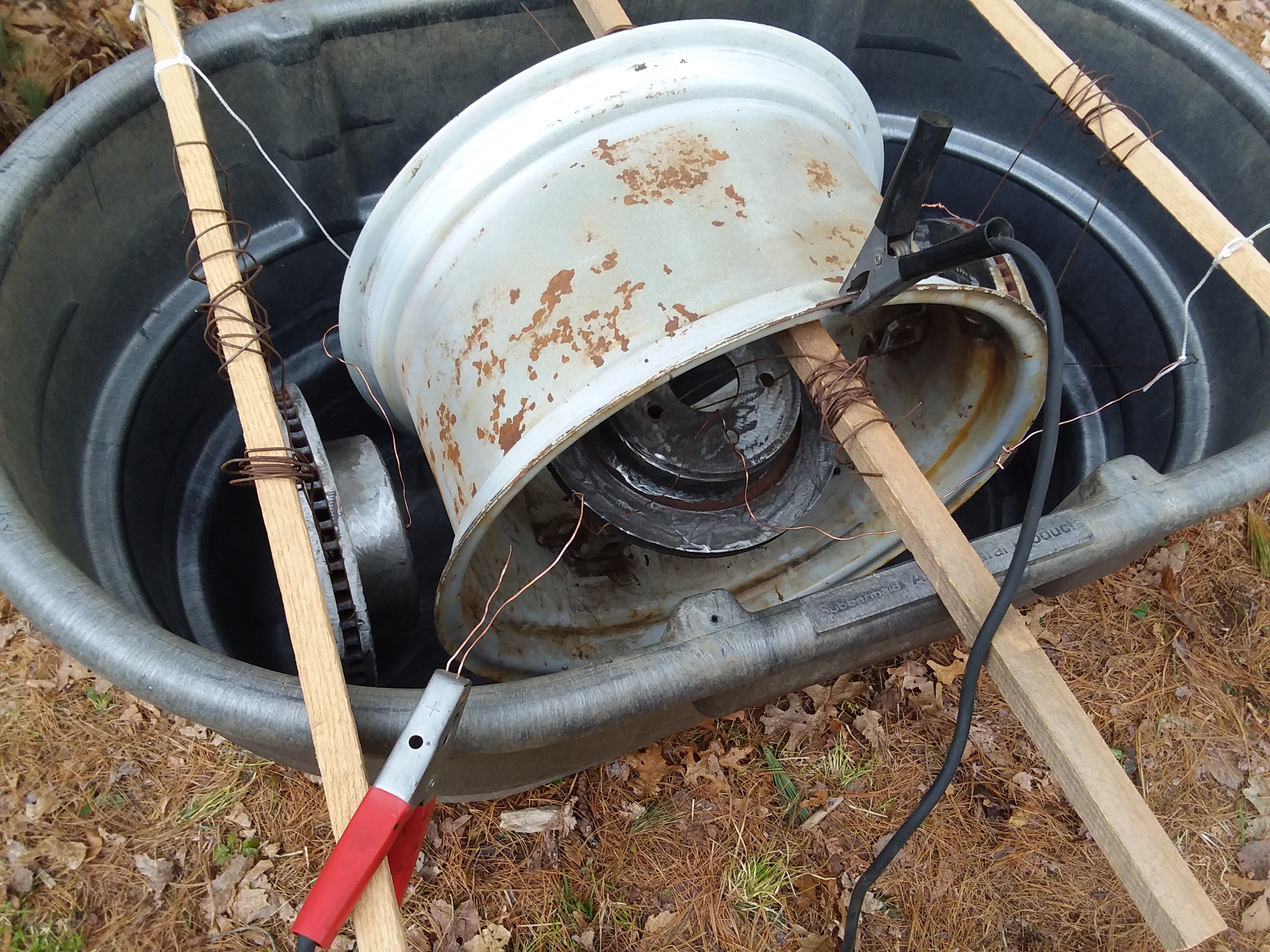

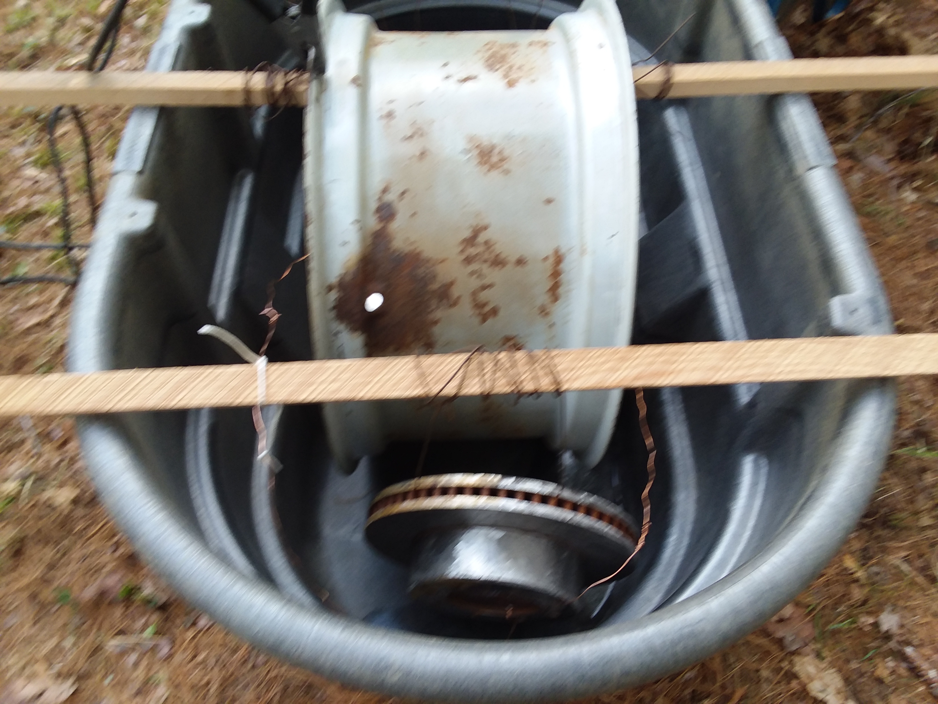

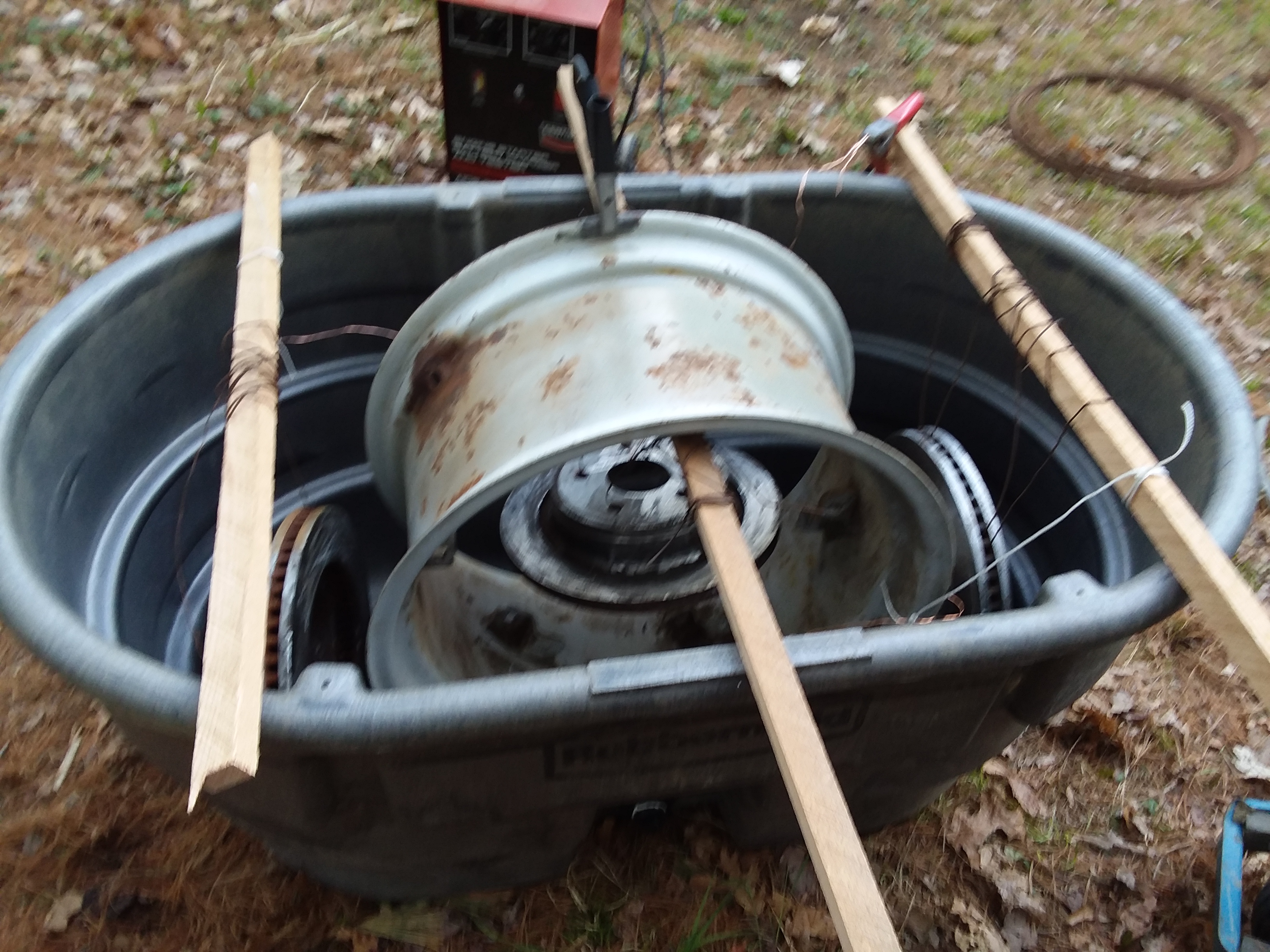

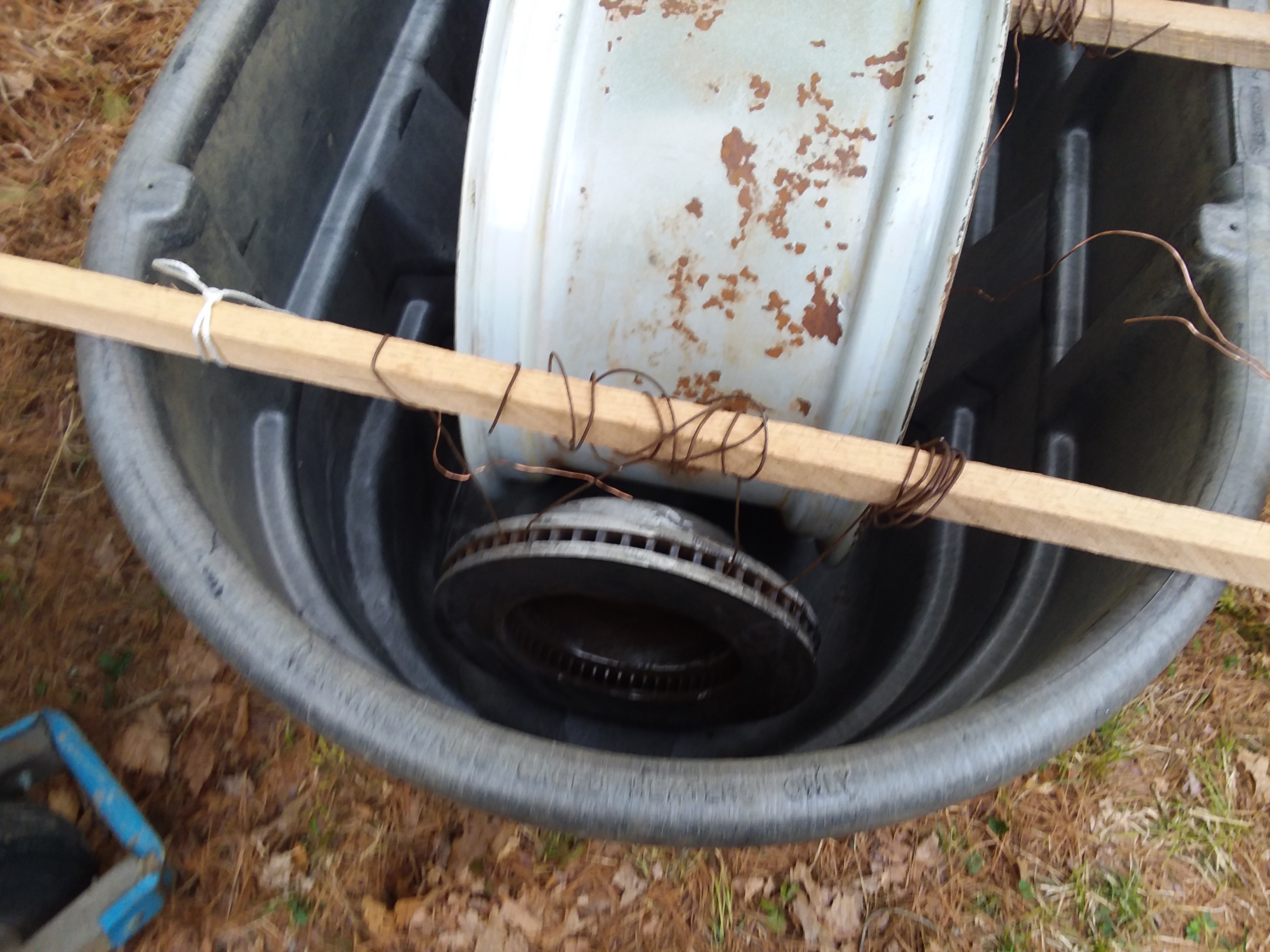

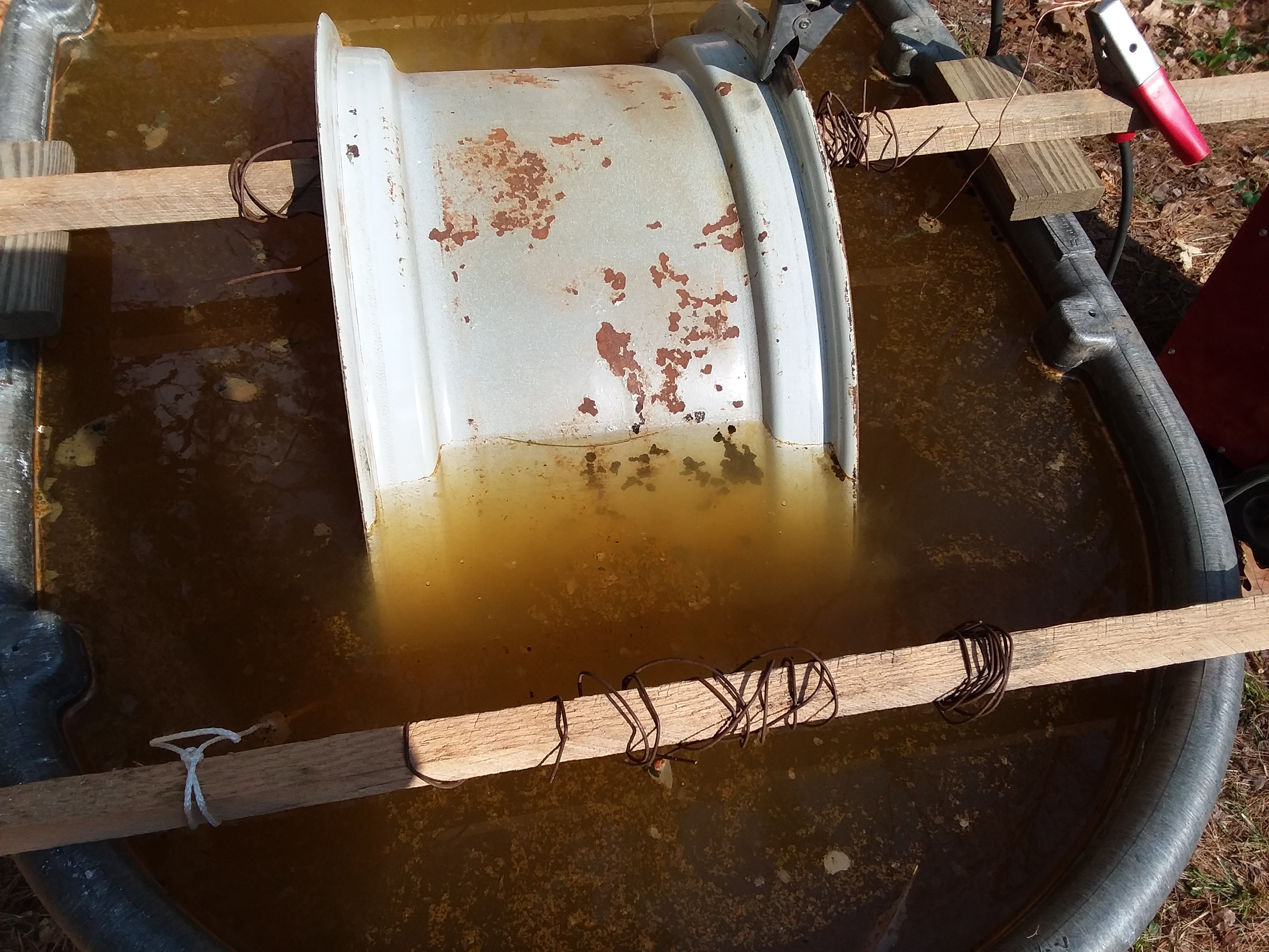

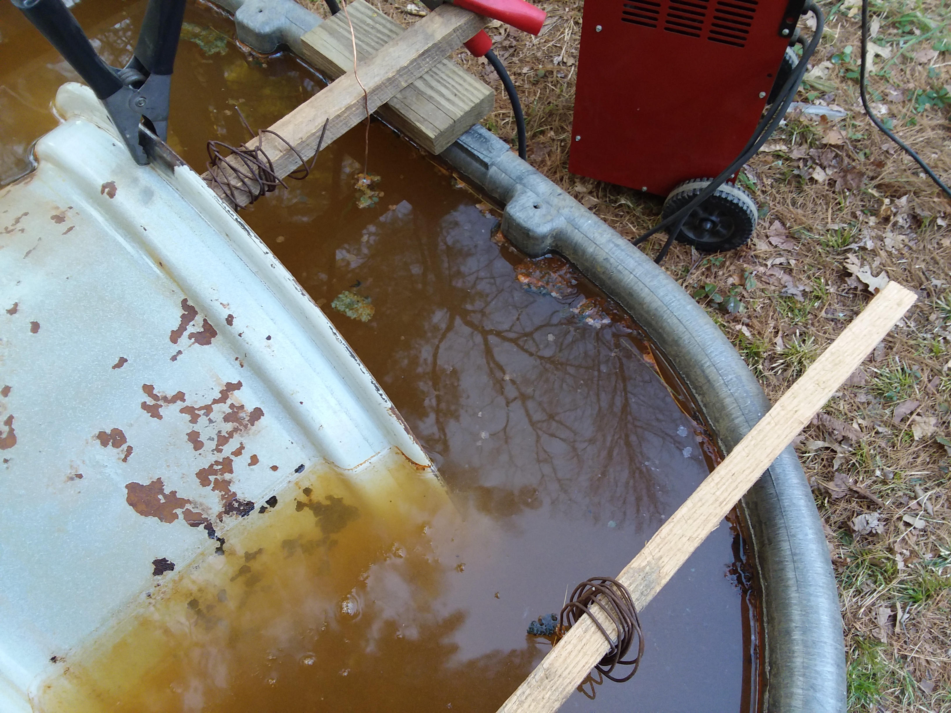

After a couple hours of grinding, the pics show my setup before water was added. It took a while to grind the rotors because I wanted as much clean metal as possible. The tractor wheel is just above the floor of the tank, and the 2 end rotors are as vertical as my son and I could get them. The rotor in the center is close to horizontal.
The rotors are connected to each other with bare #12 copper. We added water and washing soda, connected the battery charger on the 2amp setting. Bubbles started rising instantly. It was getting dark so we unplugged the charger for the night. I'll restart it in the morning and if everything's fine, let it run for a few days. I'll have to rotate the wheel because it isn't 100% submerged.
One question, during the short time it was running, why did the submerged copper turn blue? Is that to be expected? I didn't realize a couple of the pics were blurry. I'll do better tomorrow.

The copper will turn colors, and may get a crusty buildup from the soda, no big deal, you may have to scrape the buildup off the rotors as things progress if you see the reaction slowing down

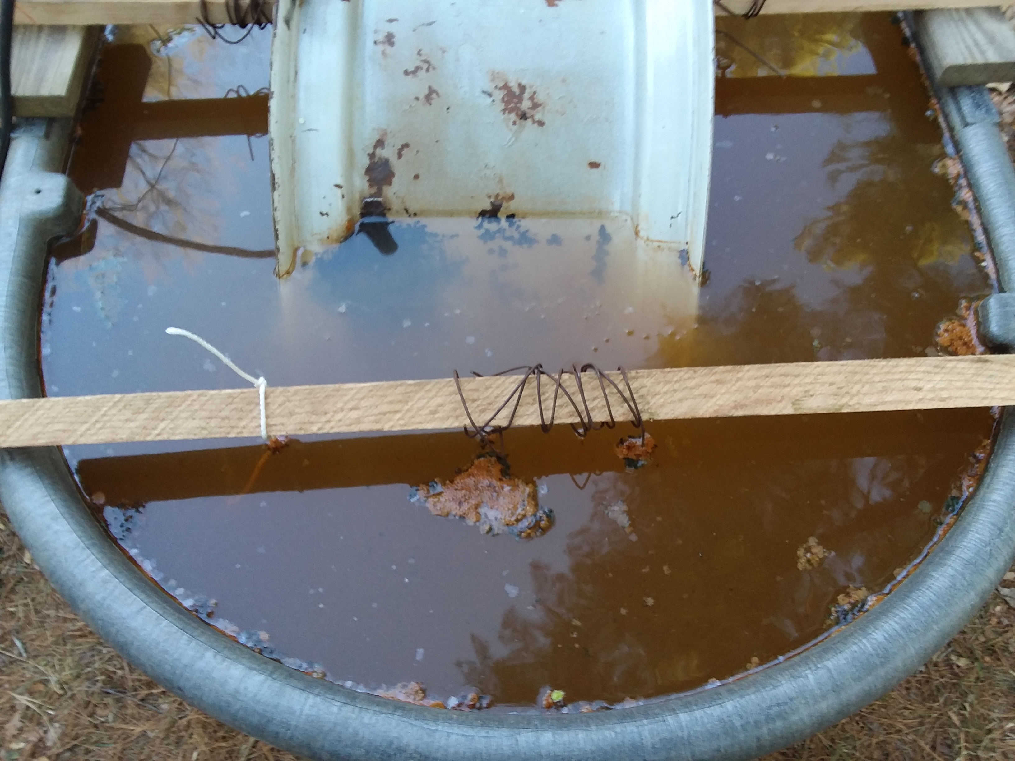

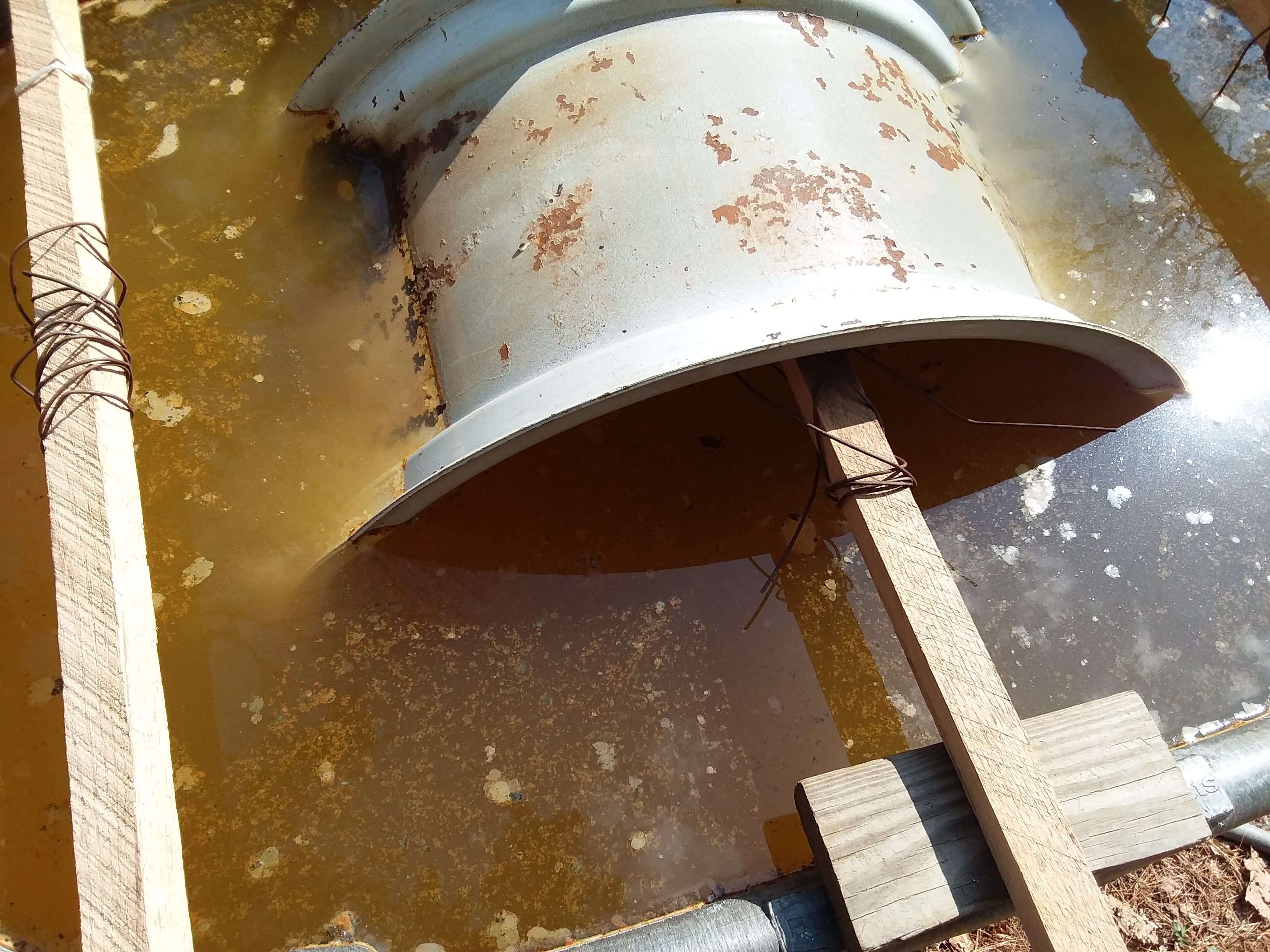

A few pics taken throughout the day. This question may be odd, but would there be more of a reaction the deeper the wheel is in the water?

There would be more rust to remove but my guess is the limitation might be the anode, the bath and the available current. I would not rush it...

The depth of the water is not much of a factor. Placement of your anodes, current, and freshness of your bath are bigger drivers.
