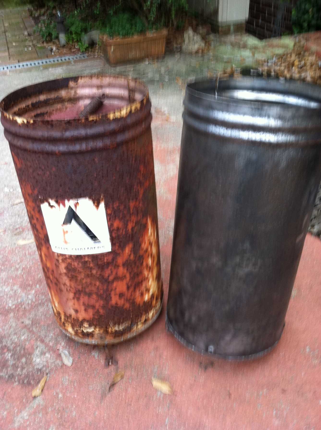

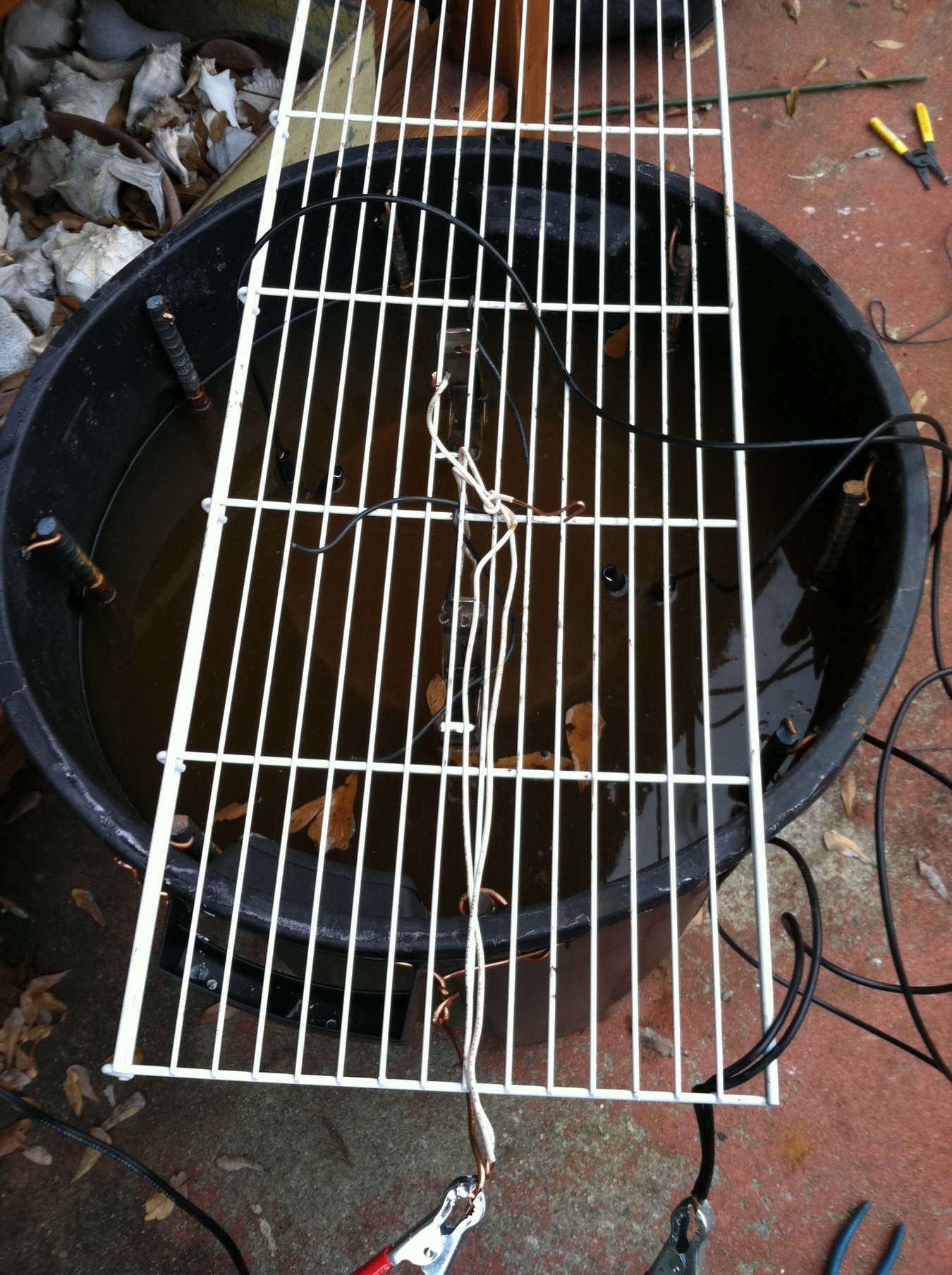

I used it to clean old hoppers from an Rusty row planter. It works great. I used a plastic trash can and rebar for my sacrificial anodes. And sodium carbonate which I found online. Here’s before/after pix.

Most people suggest making a non conductive grid to suspend above the tank to hang the item from. Then they fasten a wire to the object and connect that wire to the clamp on their power source. Also, put at least 4 sacrificial anode spaced evenly around the outer edge of the tank. That will cover all 4 sides of the item being processed. You can then run a wire from anode to anode to anode to anode and connect that to your other lead on your power source.
